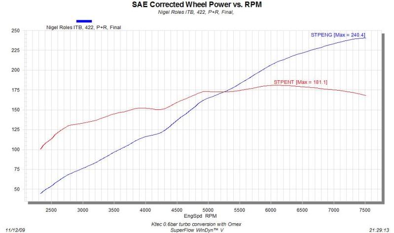

you wont do top power if you stick under 7500. depening on cams you'll likely find the power is still rising at the limiter if you do that. Uploading a graph now....
  ITB'd MK1
ignore the title on the graph, it's not the turbo car

well it would be the 421 cams i would be using i expect, bit more mainstream than the hillpower ones...i got the hillpowers 2nd hand and cheap... just thought fcuk it that will do for a bit more power for the time being...(ages ago)
