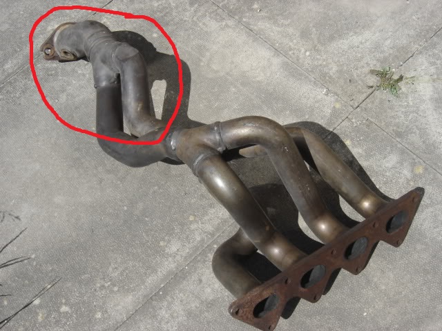

Shocks changed but it seems this is none of the usual culprits and is actually a problem with the exhaust. The flange where the exhaust manifold joins the cat is knackered and some of the pipework itself just up from that, mechanic says something there seems to be hitting off the anti-roll bar and it'll be a pain in the backside to fix too so hopefully going to go to an exhaust specialist/fabricator fairly nearby.

Generally play in the engine/gearbox mounts causes the exhaust to hit off the subframe and anti roll bar

I think the exhaust is the culprit to be fair, there's a bodged weld holding on part of it I'm told and two different garages have looked over all the mounts and suspension components.
