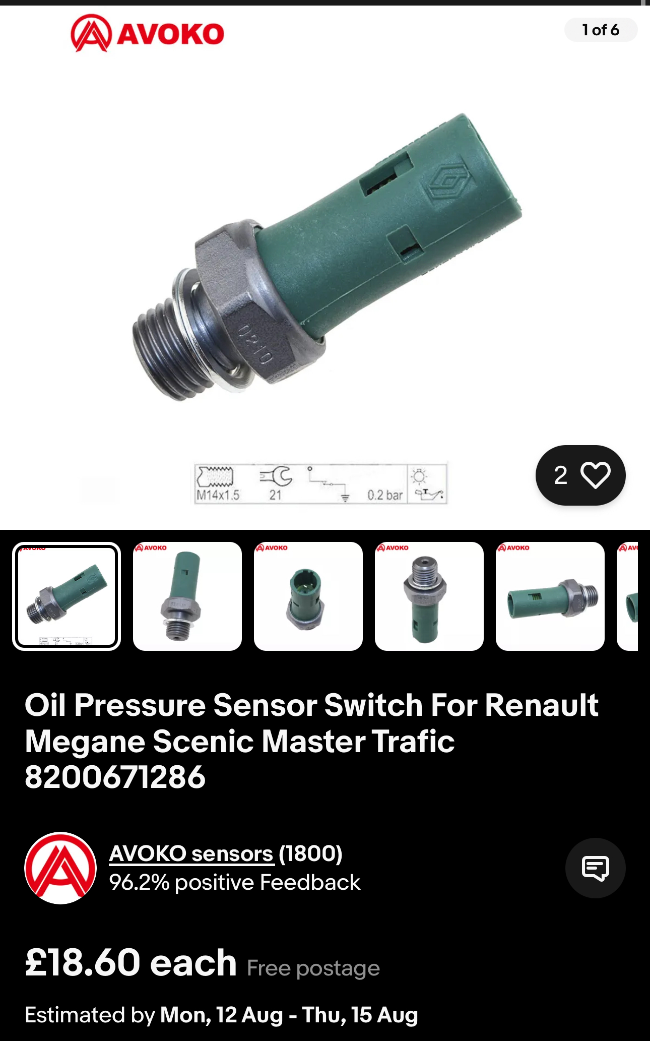

Matt Cup
  Leon Cupra, 172 Cup
Considerably cheaper on eBay (same part #).
