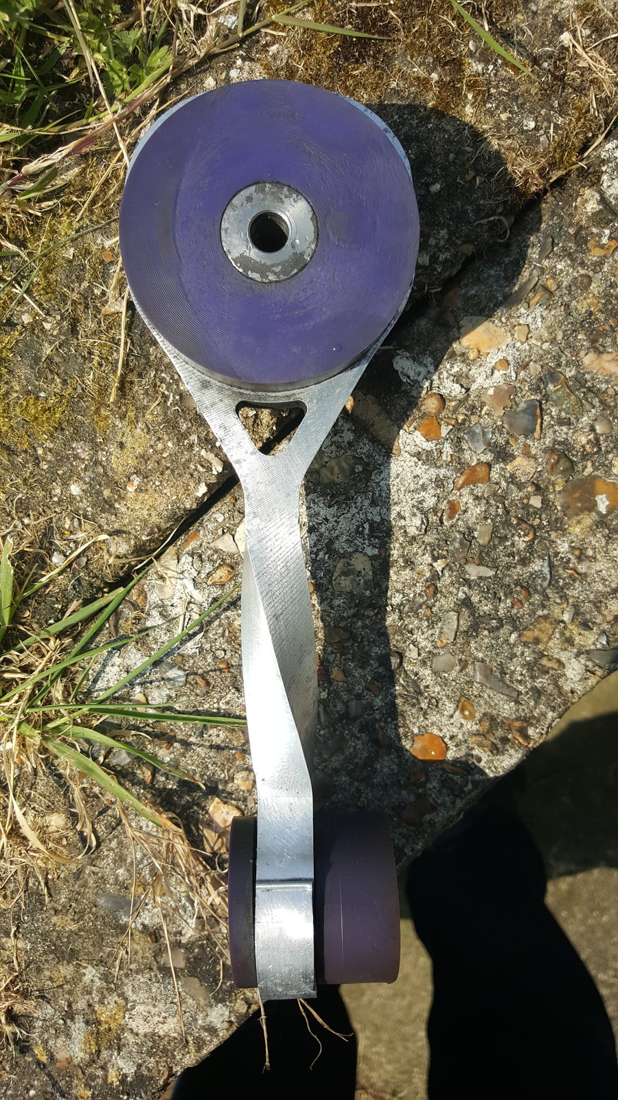

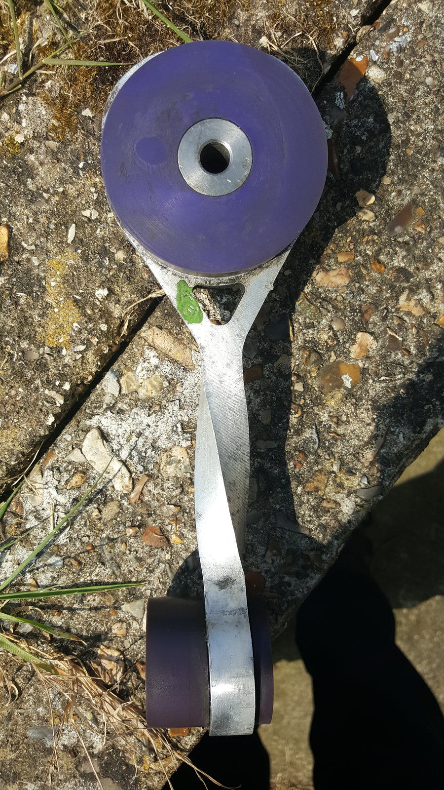

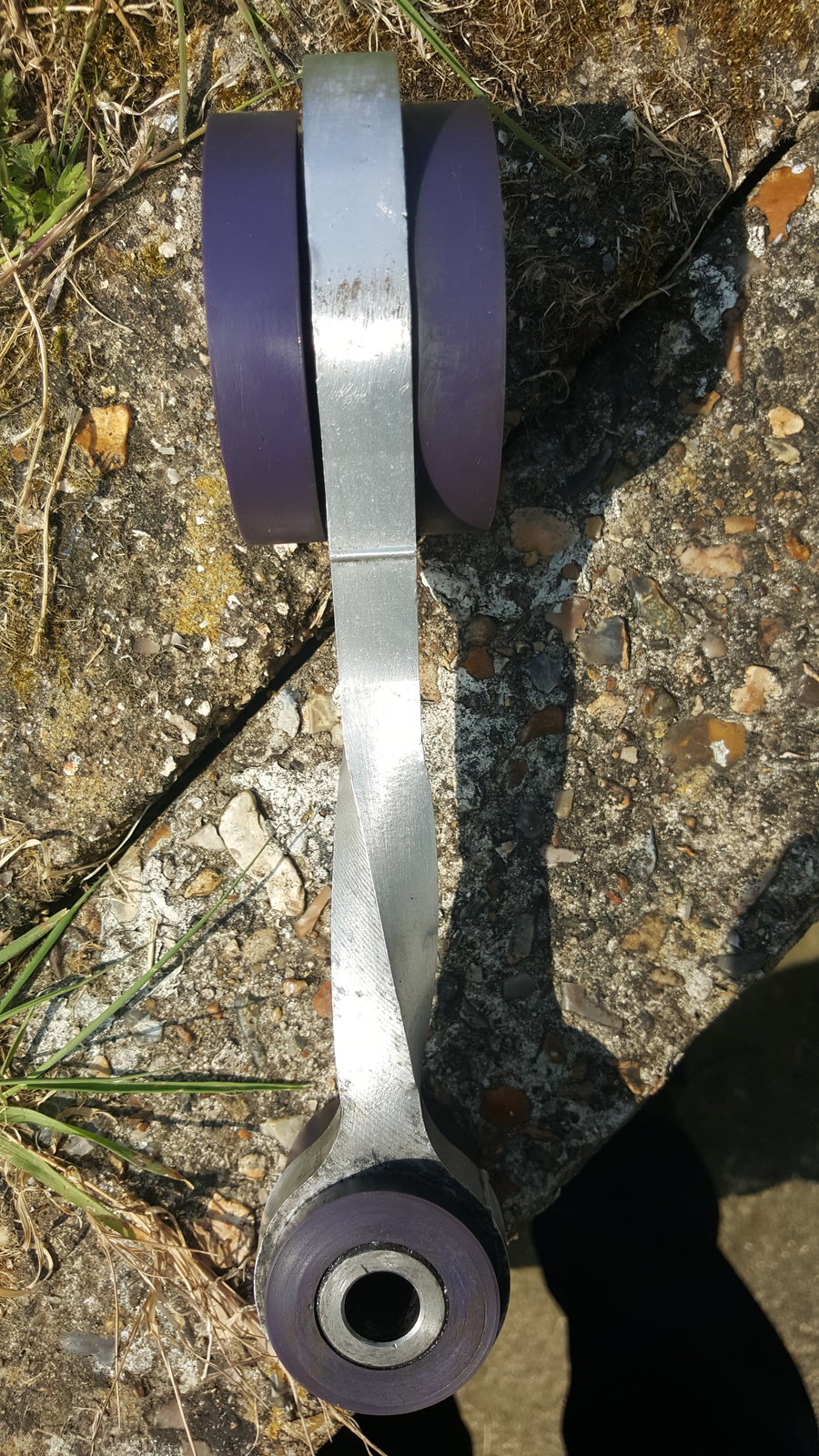

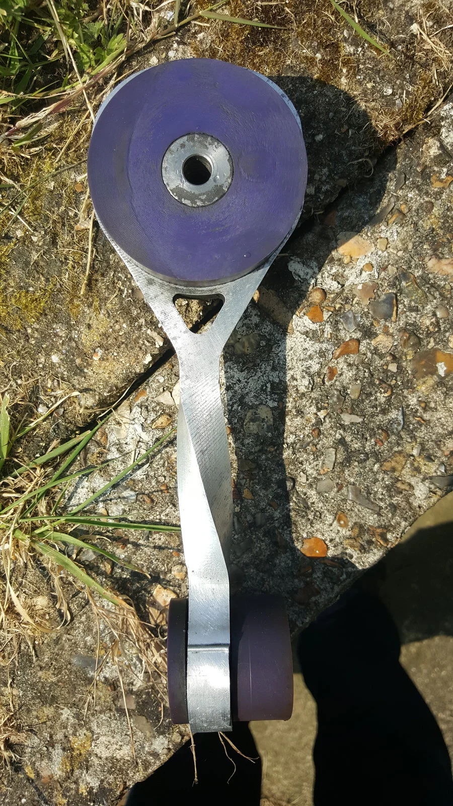

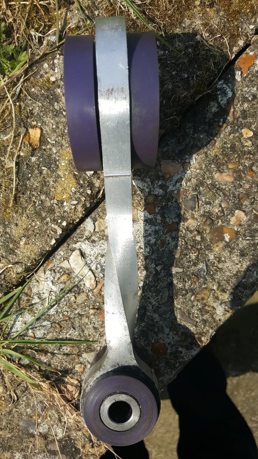

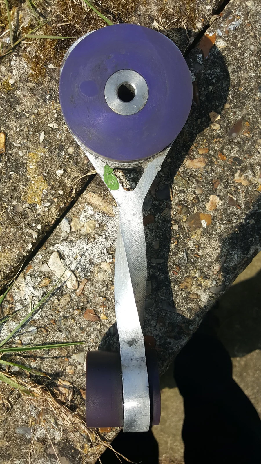

So just a quick heads up. I removed the dogbone mount that was on the car and it appears to have a powerflex bush already installed. I replaced it any way just to be sure it wasn't the dogbone mount but the knocking noise is still there.
There is a slight gap in the bush but I don't see that would be the problem. I've attached some images.
