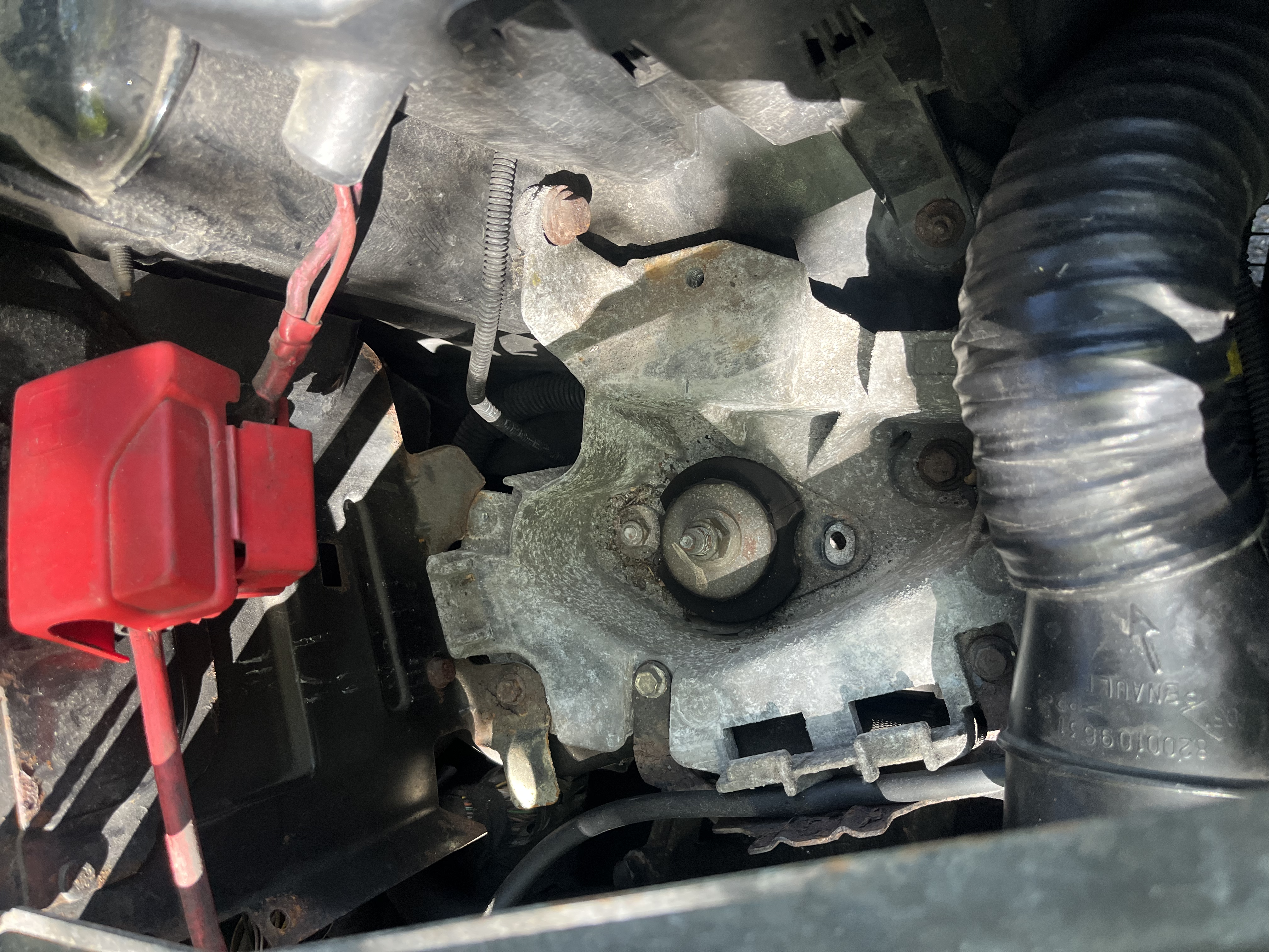

Got round to replacing all 3 mounts, top mount, polybush dogbone + upper gearbox. Went a bit too smooth, even the fiddly falling bolt. Caught both no problem.
Sadly still clunking from the front when coming off accelerator at low speeds in 1st. Much much better overall but not completely how I've known it to be. Have read somewhere that pulling the engine forward could help. Is there any truth to this?
  • if so how, is it done?
  • Does engine need jacking up again from underneath?
  • Base plate on my top mount seems to be as far forward as it'll go (towards bumper) Would pulling engine forward even be possible ? 🫠
Any help would be massively appreciated!

Get someone to stand outside the car and watch the drivers side front wheel as you brake/accelerate, see if the wheel is moving forwards/backwards in the arch. Then open the bonnet and gently do the same while someone watches the engine, see if it moves excessively or if the top mount moves a lot.
Cheers will give this a go. Only put a new top mount in yesterday though . Would that potentially point more towards wheels if not mount?
Just to add, seems to only do it when car has warmed up
