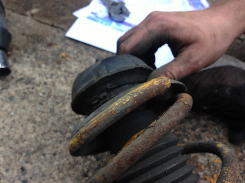

So today I decided to take the Sachs dampers off the front and put some 182 Cup dampers on. That way I could send the Sachs off for a refurb over Winter. So got started on the nearside first, swapped the dampers over and then moved onto the drivers side, removed the damper and was greeted by this.......
IMG_1425 by tommo1991, on Flickr
Not the best photo, but basically the spring on the off side (where I was getting the knocking noises from!!) wasn't seated properly.
As we'd already swapped the dampers on the other side, we decided we'd put the Cup one on this side anyway, despite being 99% sure the spring was the issue here. Took the car for a test drive and the noises had gone completely!
Now I'm in two minds. Do I put the Sachs back on or do I send them off for a refurb anyway (they haven't been done for four years)?
