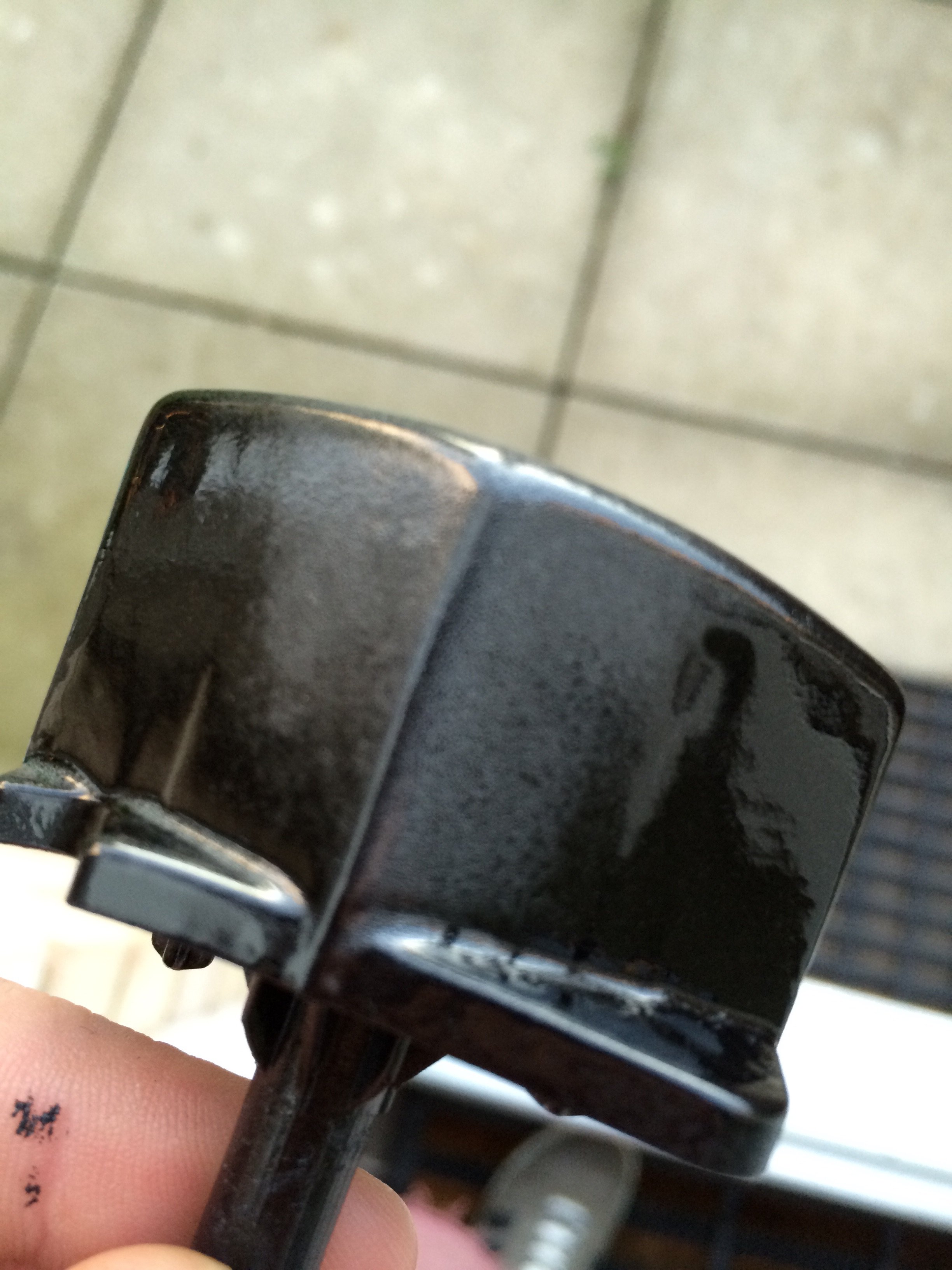

Right so last time when I was spraying my door sill for repair I had a problem with lacquer, it went all white without warning. It was normal temperature, not humid, not damp, and I did very light coat to start off with and it just went white straight away,

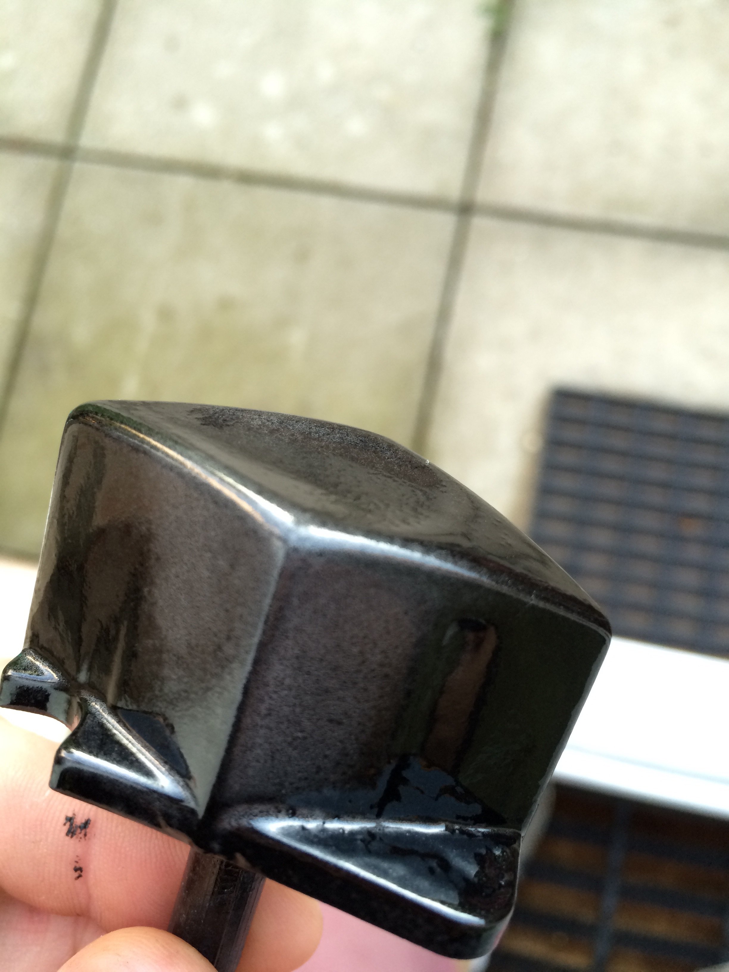

Now I've just had the same problem with spraying my boot button, I just spray literally the lightest dust coat and boom it's gone white, the surface was dry before spraying, it was clean, no wipes or anything used, not damp! And these are the results.

It is reacting with the paint. The industry would call it frying up.
  Audi A8 3.0tdi/172.
These cans sometimes have a hardener you need to release under the can first then shake.
Again, looks like you've applied to much. Solvent isn't escaping and is being trapped. You would be better off warming the item up and the can to a decent temp first. Helps draw out the solvent.
Tomo_Rep.97
I think that's only the 2k in a can lacquer that has the hardener that needs releasing. Again, I did a very very light dust coat for the first coat for adhesion, then did no more because it went white. The button that I sprayed was warmed slightly by a hairdryer! And the can had been warmed up before spraying. Again I think it's moisture as I was spraying in the evening after it had rained, cheers for your advice though! Going to try spraying on a dryer day
