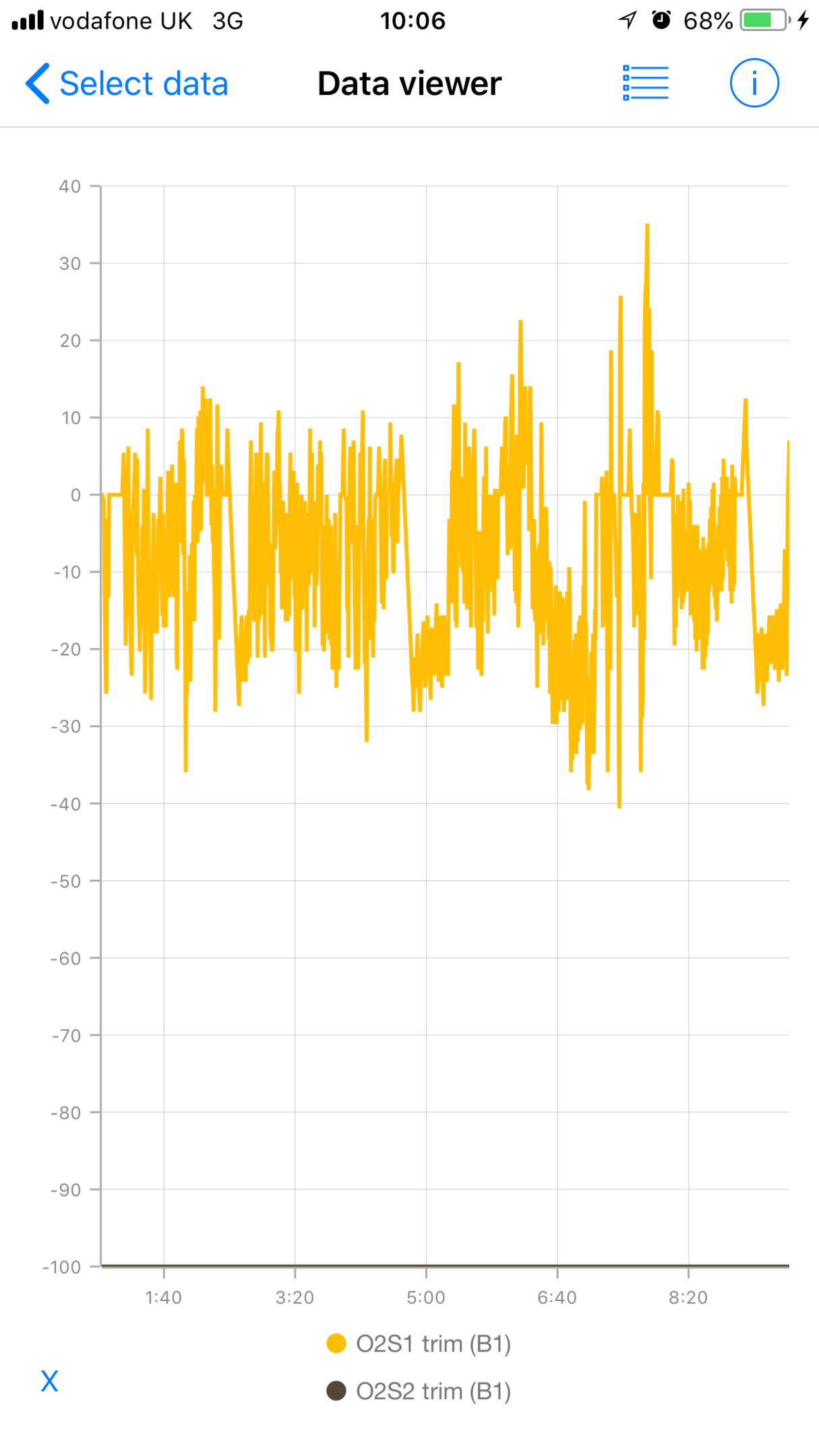

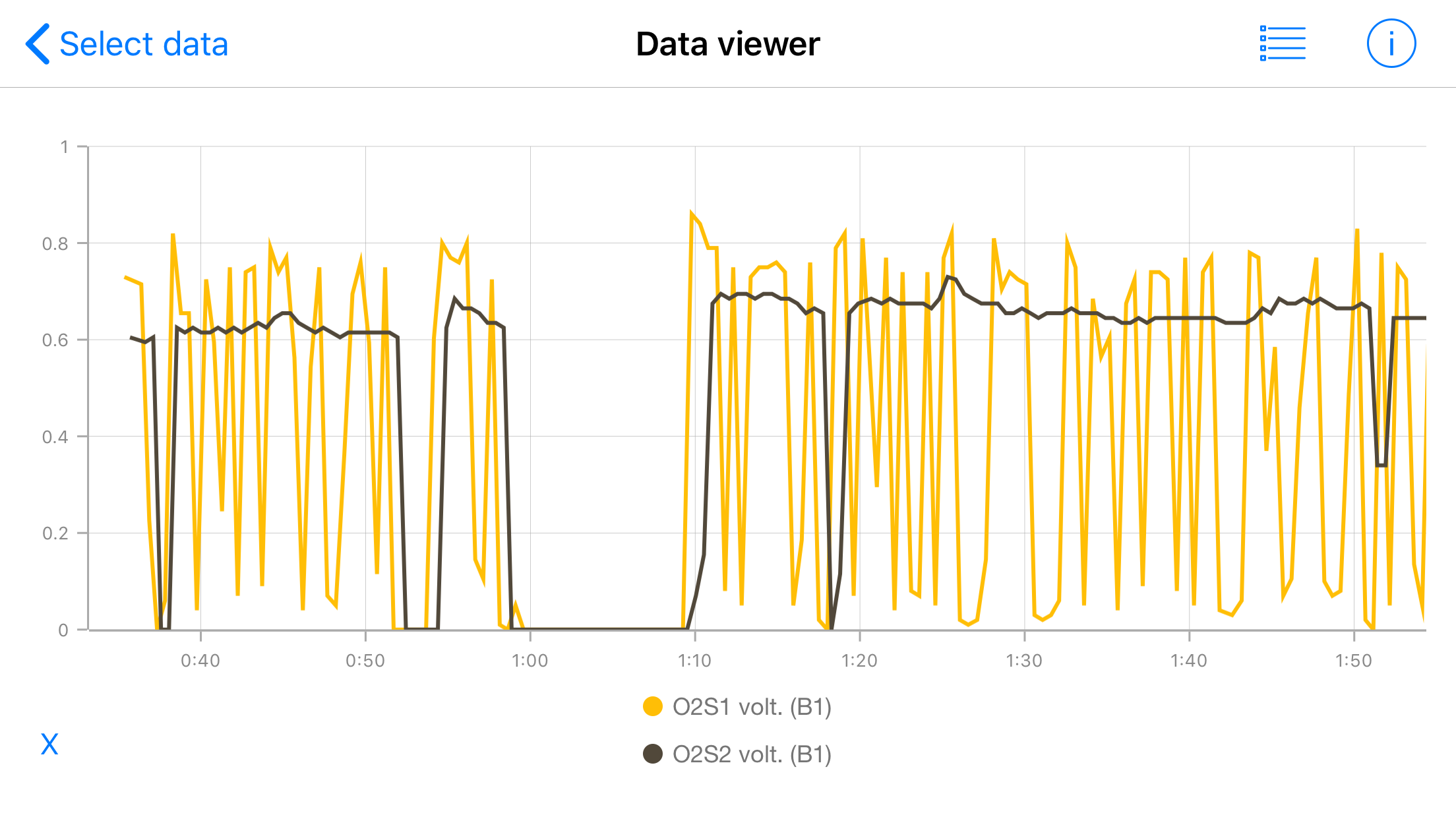

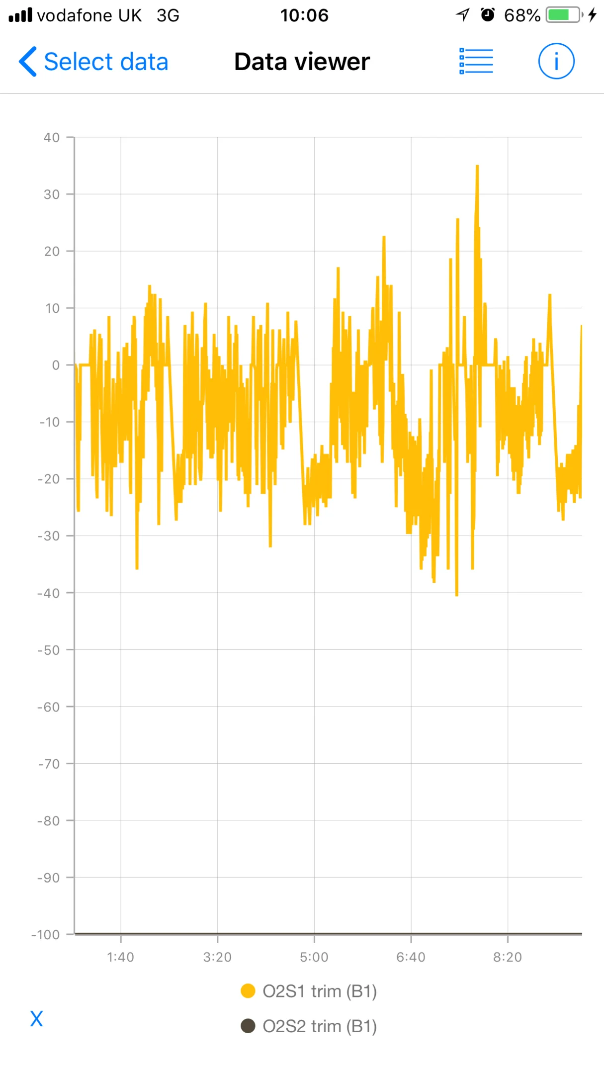

The voltage of both Lambda sensors looks ok. Sensor 1 fluctuates up and down from 0 - 0.8. Sensor 2 is a constant 0.6v when on the throttle. The short term fuel trim for sensor 1 looks ok within +10 and - 20. However, the short term fuel trim for sensor 2 is always -100, which I understand is not correct.
Do all of these signs point to the post-cat lambda sensor? Or could the issue by related to something else (HT leads or injectors). Car has new OE spark plugs, and I fitted a new injector, after I broke the sensor on it by accident. I have read on here that it doesn't affect the running of the car but the EML light annoys me, so will change it if needs be. Car runs fine except for slight rough idle when cold, but is fine when warm. Thoughts appreciated.
