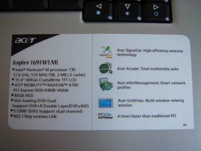

On the palm of your laptop you will have a sticker (by the touch pad) on there it will have the ram amount and type....or have you removed that sticker?
will look like this:
Yeah i know what size is in there, but how do i know if its DDr1 or DDr2, i also have some RAM here (not in a laptop) how do i know ifits the same as what i have. Or if it will work in my laptop.
