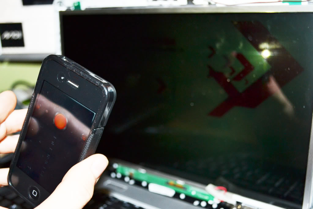

Well I just got about 30 seconds of light out of teh screen, then we get this
I've booted into BIOS too so it's not software related.
Can inverters overheat? Something is starting up normally, then timing out :S
