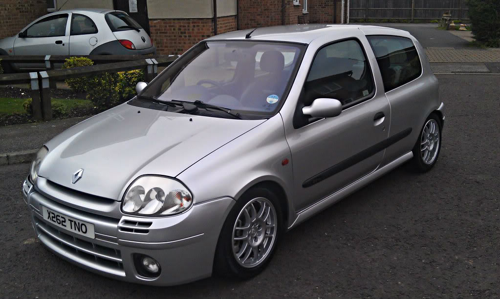

Due to getting a company van and there not being enough room on the drive decided to lay the cup up at my parents for the forseable it's got 59k on the clock is there anything I should do to her before she gets layer up ie oil change ect... Ps is there anywhere I can get a descent cover from cheers

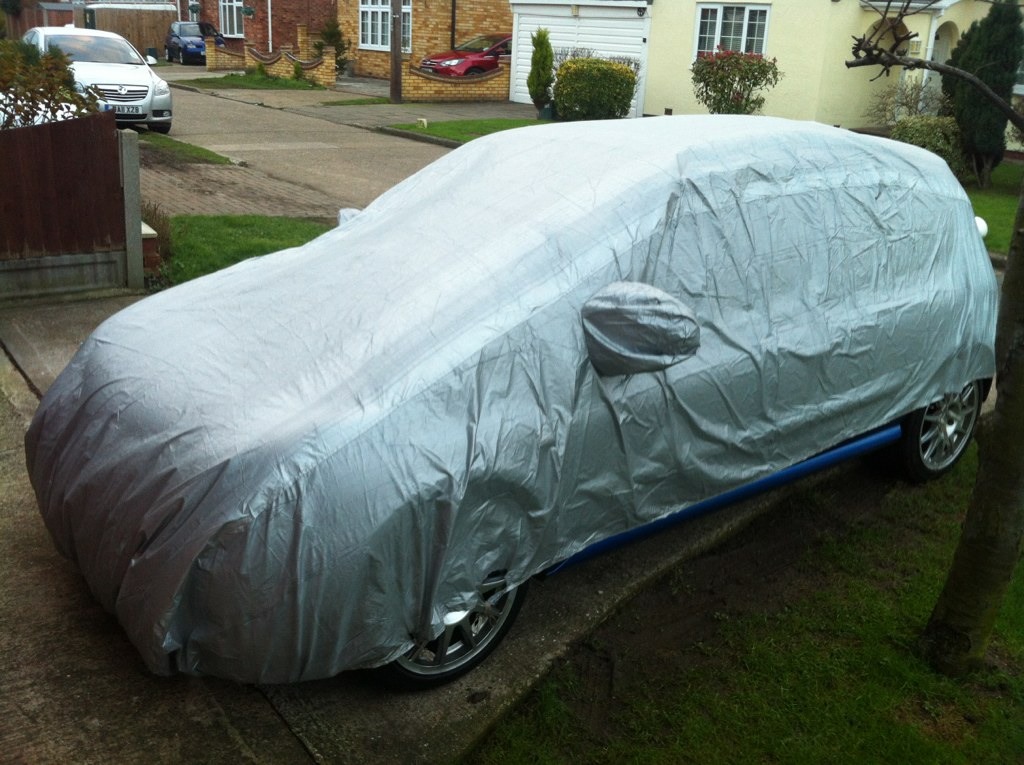

I got my cover from these, its a good fit and its the 2nd cover i`ve bought from them (not for the same car) I think mine was about £120 ish and its the Noah i have, its even got pockets sown in for the mirrors and a nice snug fit with two under body straps so it does not blow off in the wind.

Oh btw my car lives under its cover for months at a time and has been fine, if it had marked it in anyway then i would leave the cover off.
The cover stops the birds crap, cats claws, sun light fading the trim etc.....
Buts its your car, your choice mate...:)

My cups layed up until march/april ive got a £15 cover of ebay on it its not great but its keeping bird crap, Tree sap and so on off the paintwork

Think I will give the cover a go and see how it goes keeps the bird s#*t off then worth the money
Yeah might aswell give it a shot fella my cover is s**t it blows around like crazy even when the winds at 5 MPH lol but it keeps the crap off
Thats when the pain work gets damaged, mine fits tight and is thick but it was more money.
The paint work is actually all good the cover is pretty smooth for a cheap ebay jobby im defo in need of a much better one im gonna have to spend a lot more for a decent one
