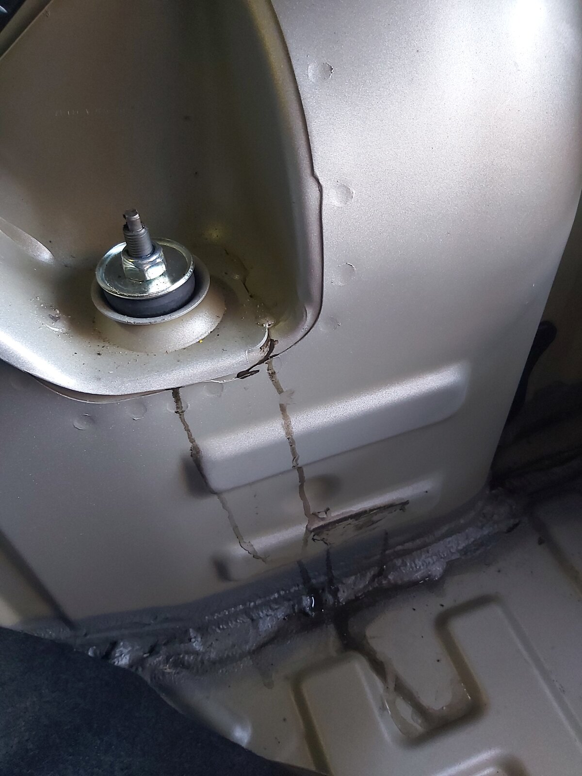

Hi I've not used the car for a few weeks come out to it this morning to give it a clean and notice my carpet under passenger front chair all the way to the boot is soaked. I've taken it apart slightly and come across this, any ideas how to fix? Thanks

The shock mount looks cracked and could be getting water ingress from the spray of the road🤔
I'll have a proper look later see if it is cracked but that does make sense just seems a awful amount of water from just that
Road spray would suprise you.

Thank you so much for the advice I'll check when I'm back home. Are they easy to fit
No worries.
It will require welding if replacement is needed. But and I emphasize but it just could be the sealant has gone brittle and would only require a good clean and resealed
