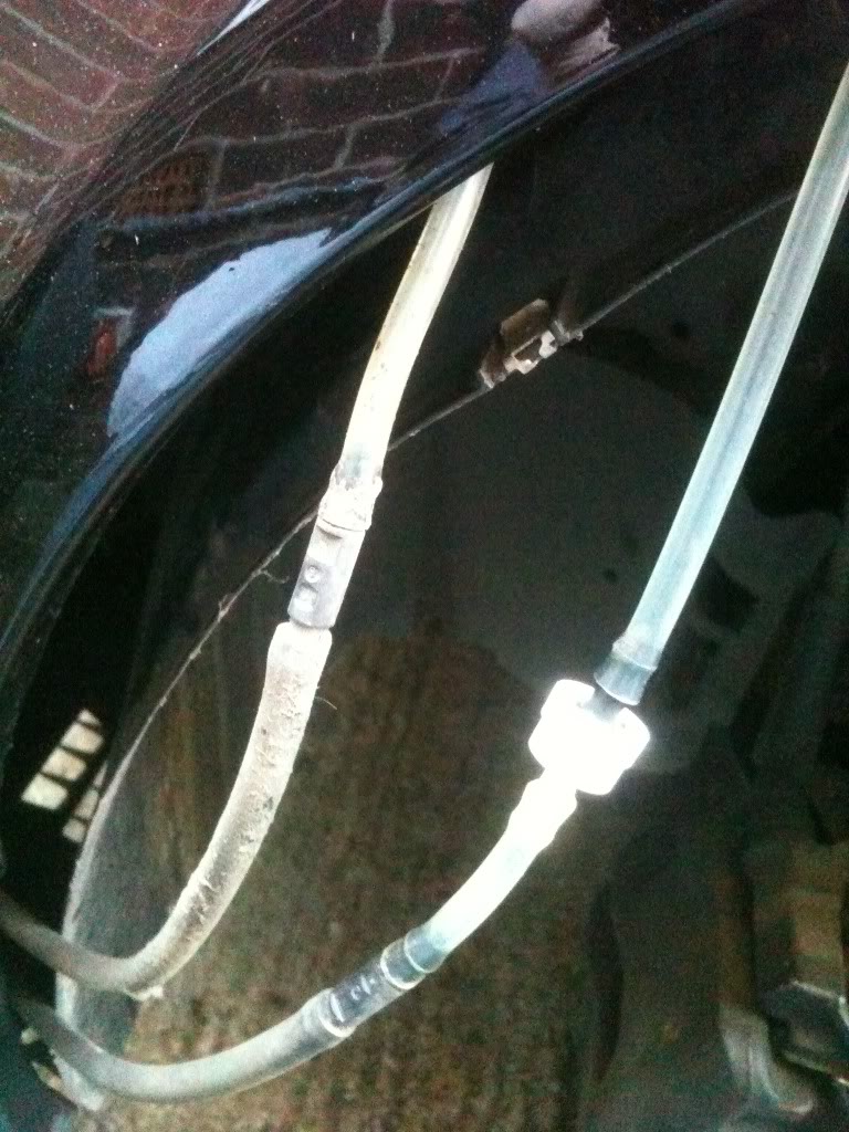

As Elfy says - it's easy enough going in through the arch-liner. Get a Torx-20 screw bit and undo the clip on the lip of the wheel arch and it provides easy enough access to the two pipes coming down from the washer pump. They are kept in place by a simple white clip, which is easy enough to open and allow you to pull the pipes out into the open...
The pipe on the left is an untouched one, whereas the one on the right I've just snipped and started to insert the Halfords valve into. There are no markings on the valve as to which way the flow is, so I just guessed at the black end being towards the washer bottle and white end towards the washer jet itself. I got lucky. :)
