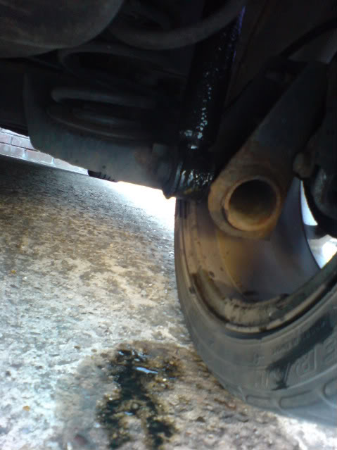

What's gone wrong here then chaps? Noticed oil or fluid leaking on the drive, looked under the rear arch and :eek: oh no, it was literally flowing out.
Is it safe to drive? Any idea what the damage could be? (to my pocket) . . . It's a 172 Cup by the way.

Need a new shock urguntly, easy job you may be able to do yourself, get a pair. If you drive it go carefully.
It will be very bouncy on the rear

As said it wants a new pair of rear shocks (they need to be replaced in pairs really) £50 a piece from a renault stealers and best to stick with oem stuff.
Be careful as shot rear dampers tend to make them very tail happy.

Looks like your rear shocks are leaking. Its a common thing with these cars according to most on here. I had this a few weeks ago and paid Renault about £110 for both rear shocks (you should change both at the same time, even if only one is leaking).
Apparently you can fit them yourself with no bother but I paid a garage about £30 to fit the pair.
It looks pretty bad, you'll probably start hearing a thud when you go over bumps.
Good luck with getting it sorted!

Thanks guys. Ahh. . . that explains the thud noises which started last week, I was pretty sure it was something in the boot! Obviously not. I'll get it sorted this week. Cheers again.

Yea go carefull, as bmh says they can oversteer a little.
(Not had it on a clio but drove a golf that wanted to swap ends all the time due to shot rear dampers)

Hmm. Not drove it all week as I'm getting a lift to work. I have been quite tempted to do it myself over the weekend but I can't source any spare parts, nobody stocks them it seems. . . .Think I might have to bite the bullet and go to Renault? :S

I had this problem. It was one of the reasons my car didn't pass it's MOT. Had to replace the rear shocks, I got some Bilstein ones and got them fitted for £100 :) its not what you know, its who you know lol

do it yourself mate. its very easy. if you get stuck then take it to a garage.

Fitted the new ones today (supplied by Auto-Nation, great service) and I just can't believe how much smoother it feels to drive. Mine must have been on the way out for a good while now as it hasn't felt so good to drive for ages!
