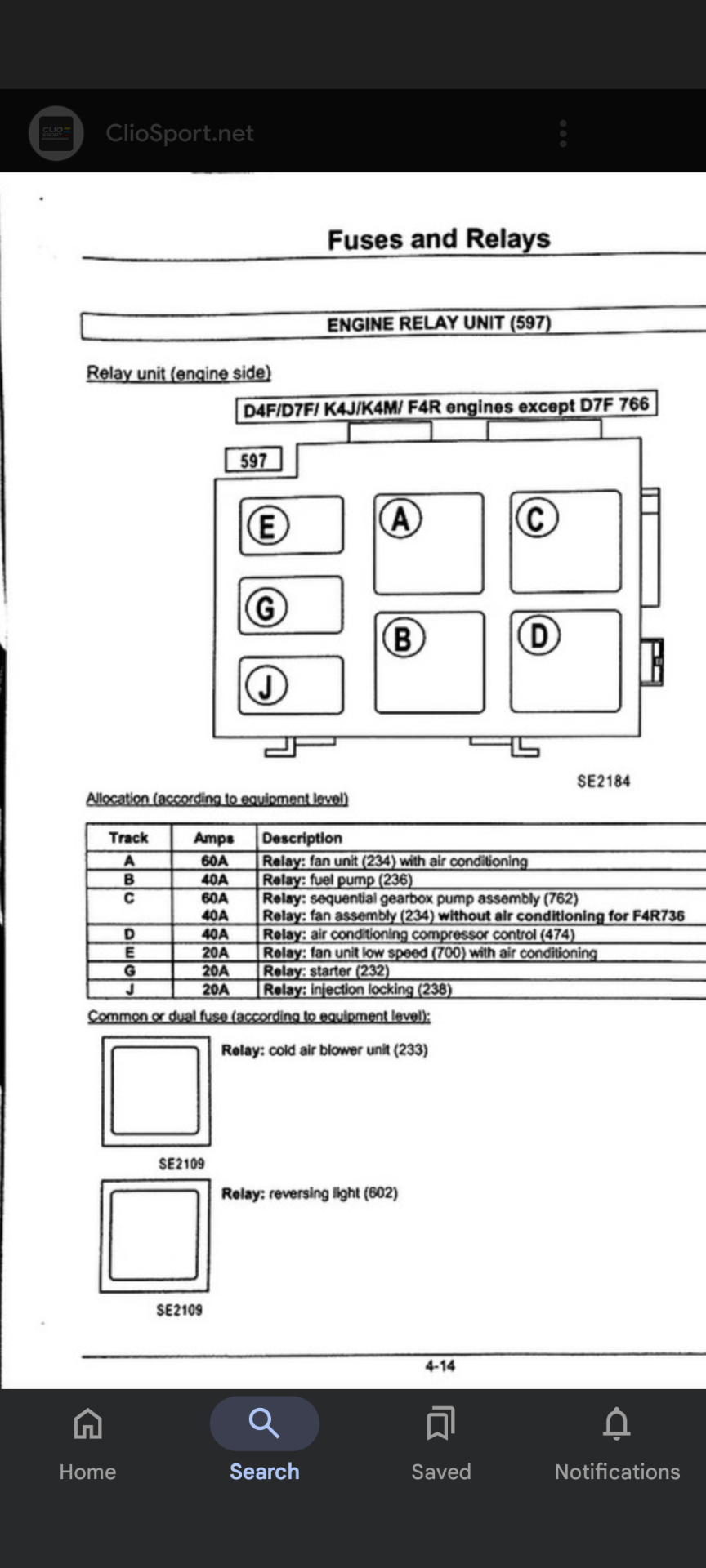

I had the odd non start issue on my old 182.
Turned out to be the starter relay in the fuse box. (G) On diagram.
When it does it again, swap G relay with E and see if that does anything.

Check on the relays earlier and swapped G with E. Made no difference unfortunately. The retaining clip for the relay cover snapped off as well when I was taking the cover off. Not sure if that will rattle like a b**ch now.

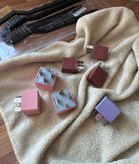

Having swapped the pink relays over for testing yesterday, I gave them a once over from the little bit of oxidisation that some of them had on their pins. Will get those slotted back in tomorrow too.
A squirt of ACF-50 or XCP Rustblocker will stop them from getting corroded again.
