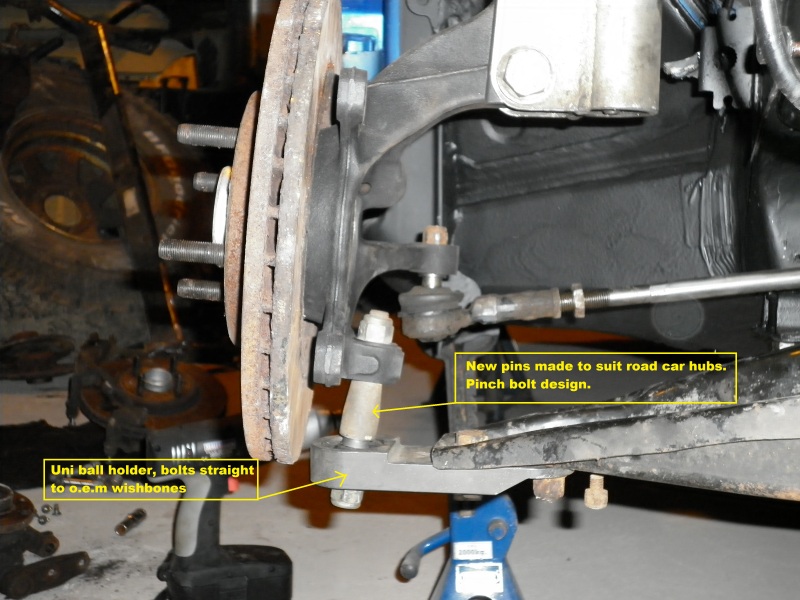

A set of cup racer uniballs/holders, custom pins to fit in normal road hubs (50mm ish adjustment) with pinch bolts and a set of longer cup trackods, all bump steer etc near standard if not better. Just the case of your original problem trying to get longer shafts. 20mm ish per side?
This should give you an idea of what I mean, I think northloopcup is also testing a similar design just now.
Only other needed parts would be cup track rod ends and maybe track rods, im unsure if the track rod's differ throughout the 1*2 range but after fitting this setup to my car it looks like I wont need any bumpsteer adjustment on my 172 cup.
I can give you a measurment of racer pins if needed!
That spacer looks useful for maintaining bottom arm angle when running low.
Fair bit of load on that bolt though I would imagine.
That's what I thought when I first saw them but I have been told you will break the bottom ball joint bolts or bend the wishbone before you will the RCA pin, It is just basically a fancy bottom ball joint and you don't hear of many of them failing when in good condition. The pin is high tensile steel.
I agree, Im sure it will be ok, just saying that it is increasing the loads seen, but I dont think it will be enough to be a problem, especially given the sacrificially designed nature of the arms themselves in the first place.
