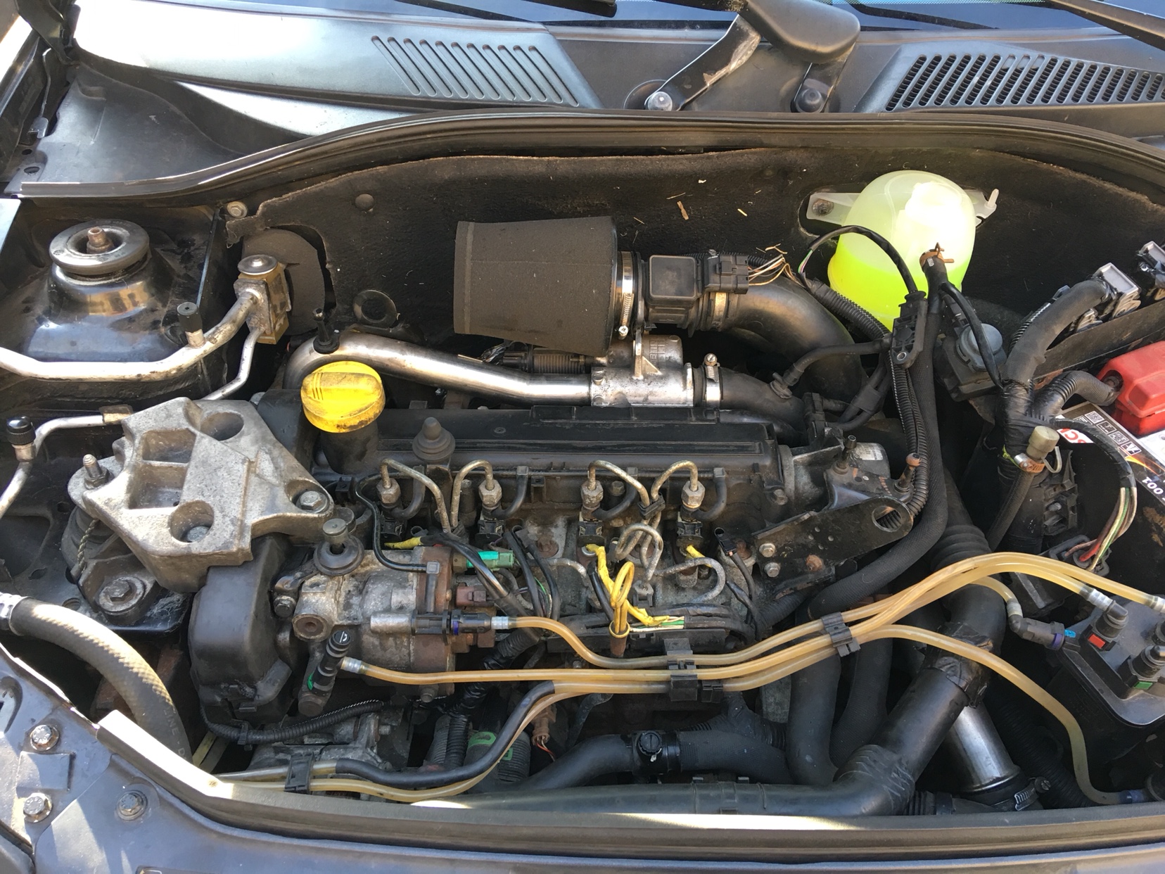

Thanks bud, Nice looking car you've got there, Cambelt been done about 20k Miles ago, fuel filter i believe got done not long ago its been serviced every 2 years have all papers ect. Remap is getting done from carlton remaps i believe on facebook not too far from me. they seem decent. about the EGR is this a fair job to do , All new to me most stuff and are you still running the stock airfilter .thanks
I have a RamAir filter on mine, that’s one thing I forgot to add. The EGR is a fairly simple job on these, the hard part is finding somewhere sensible to clean it as the carbon will stain anything that it touches once you try cleaning it haha. I think I’ve heard of Carlton before
