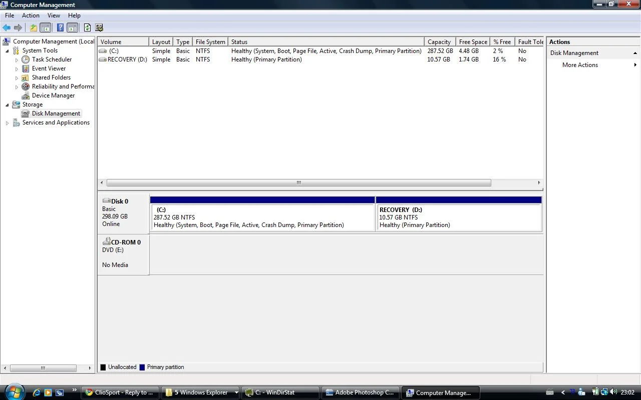

go into control panel/administrative tools open computer management then click storage and disk management and post what it says i there.
It should be something like this:
or screen print it and post the pic if your unsure what it all means
Can you go through onto the c: to see whats being used, i double clicked but it did nothing?
heres the other one as well...

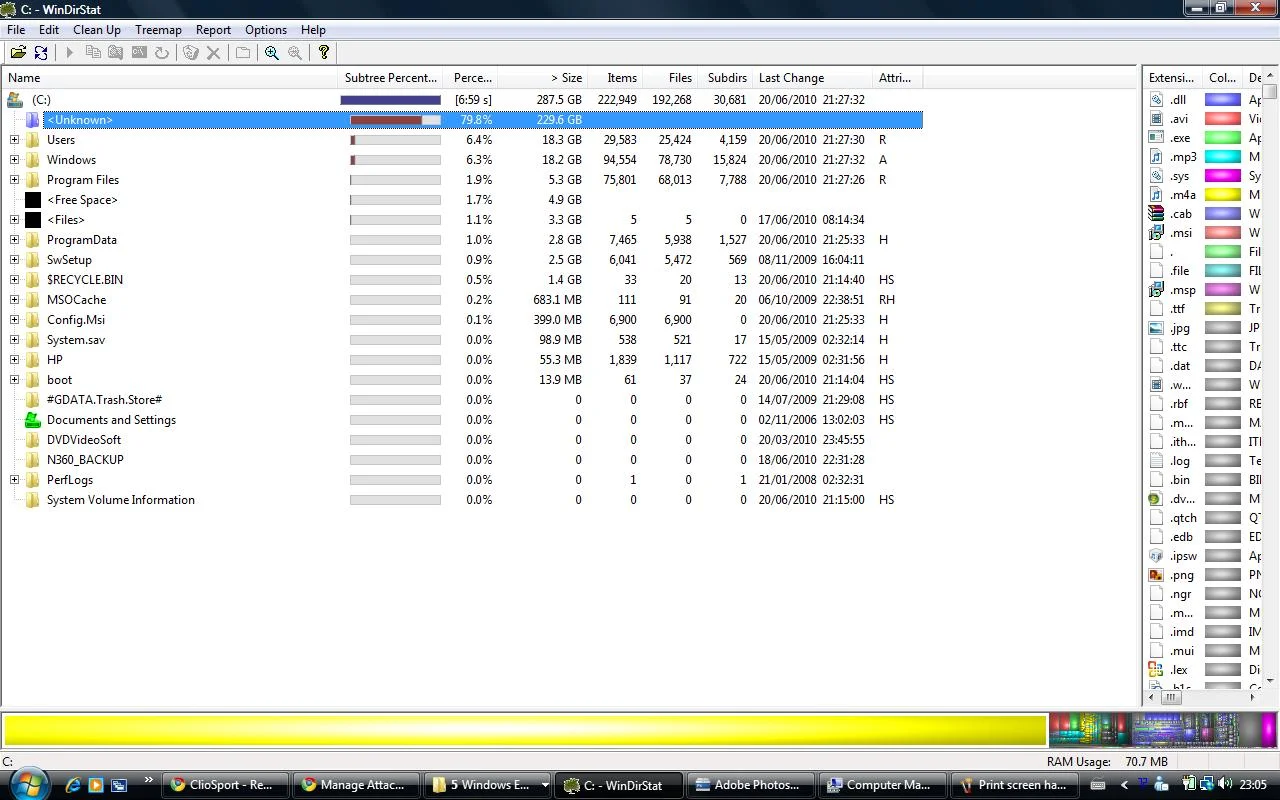

I would say the 229.6GB of <unknown> is what is causing your problem
According to the legend on the left its a .M4A file which is an audio file for iTunes
EDIT: Just delete the unknown mate, if you don't reply i will just assume i fucked your pc ;)
haha i dont know whether to risk it or not! maybe if i back up all my music then try, this has epic fail written all over it...
well according to that its a file/folder directly in drive c:\
go have a look and post a shot up again
unless you really do have 229GB of iTunes music, do you get all your music from iTunes or do you have mp3's?
Cant see how it can be itunes as all my music is about 6gb and is included in my c: drive under music as ive just checked, really strange, cant really be a virus could it?
just tried to delete it and it cant be deleted?
doubt full with is being an m4a file, i would just delete it mate. 229GB in one file is f'ing huge, if all you mp3's are safe in /music it wont harm any of those if you delete it

since doing the original screenshot and having to restart my computer due to uninstalling cs3 photoshop the unknown file has filled again now up to 231.2gb from 229.6gb
i dont understand what the f**k its doing!!!! this is frustrating
i think m4a isnt related, when i click on the thumbnail its just in the very bottom right corner and is just the 6gb of music, dont know why its the same colour as the unknown file though
Boot into safe mode and try deleting it that way.
I just thought the windows folder looked slightly large at over 18GB on that screen shot you posted 15GB is about normal though.

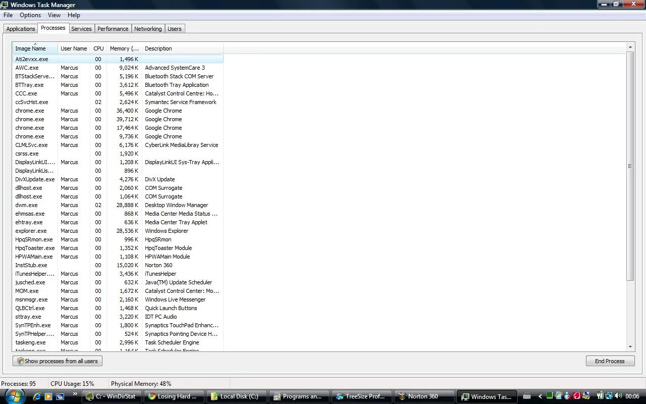

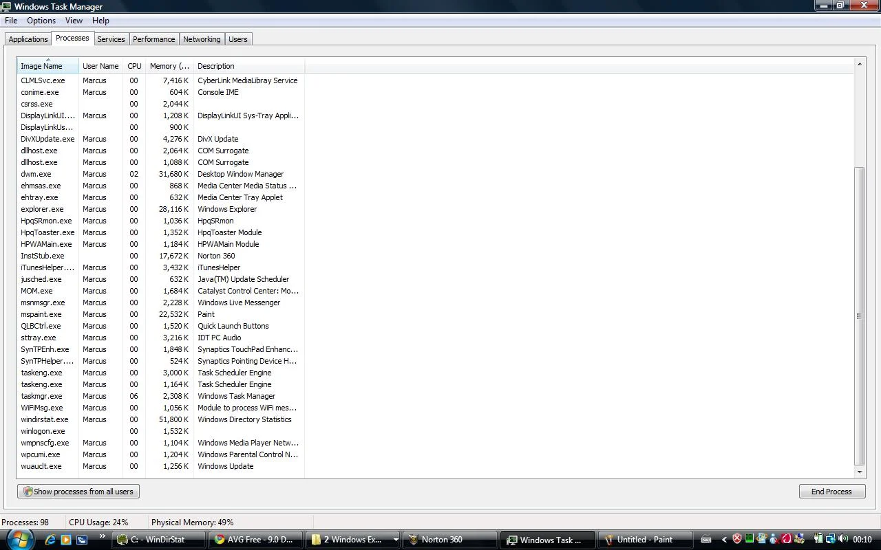

Might also be worth posting what processes are running for us.
