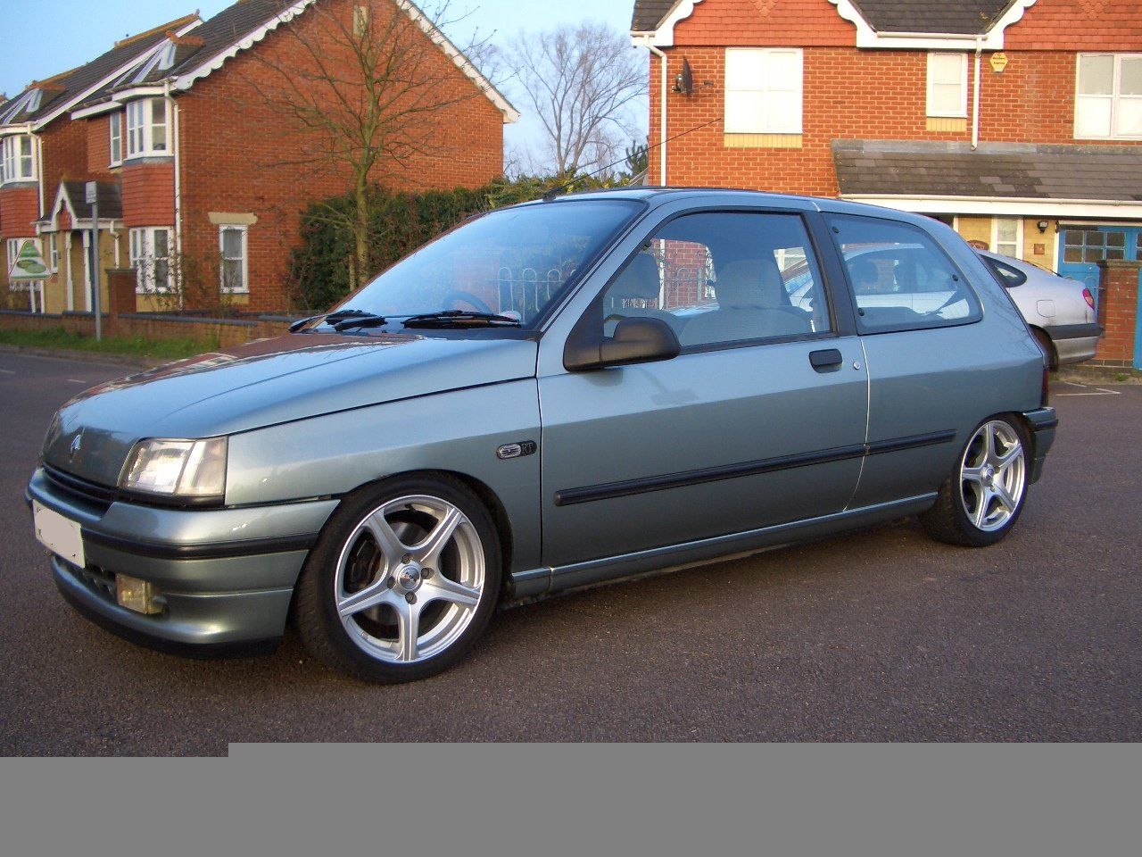

mines 60 on front and 90 on back and it hates speed "pillow"/bumps, bottom of my ktec back box is nearly flat from all the scrapin its done lol, ill get some pics up of it if you want sat on 16s! and the damaged box lol

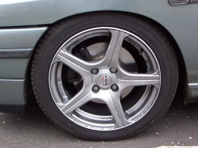

Mines is 50mm on old springs and shocks (coliovers soon :)) with 195/50/15 and it scrubs on the inner arches, it some times catches on the top of the arch when cornering fast but just had them rolled so shouldnt be a problem.
heres a pic.

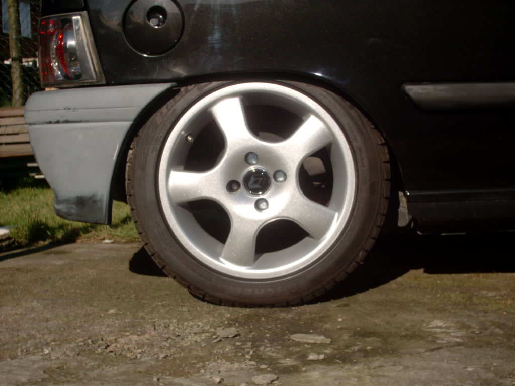

  Punto/Clio GTT
195/50 15's, 55 mil springs front with the small plastic bits of the arch liner that connect to the bumper took out, doesnt catch on anythin.
backend dropped 3 splines on torsion 80/85 mil, also with bottom plastic arch liner thing that connects to the bumper took out. scrapes if i go over speedhumps too fast, so just take em at a sensible speed on drivers side 2 wheels, no problems with exhaust catching either.
i reccomend 195/50's over 45's, a much nicer ride with the 50's imo
