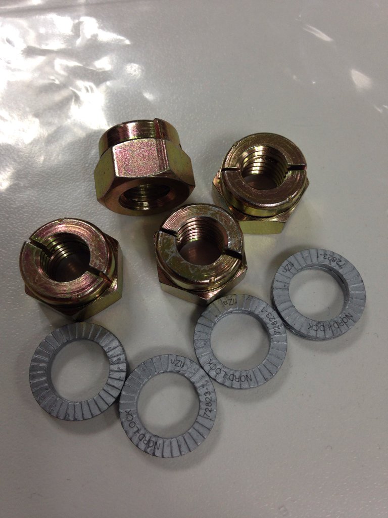

Just managed to pick up something similar as what you linked weren't in stock. Also got some nordlock washers. These be ok for the time being?
They might be OK mate but I'd have to look see what material they are, I've also used same style copper ones and they were OK as well.
