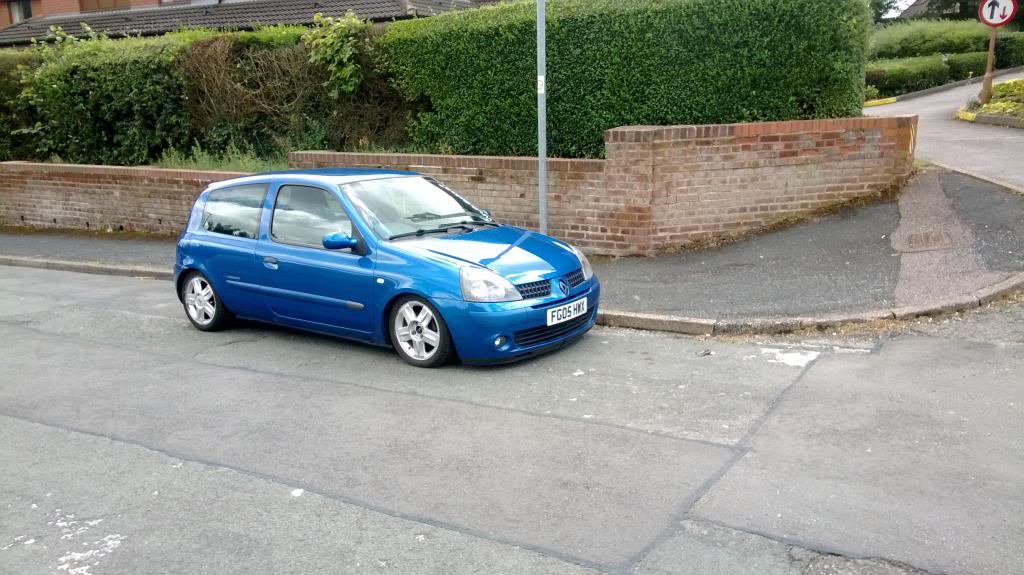

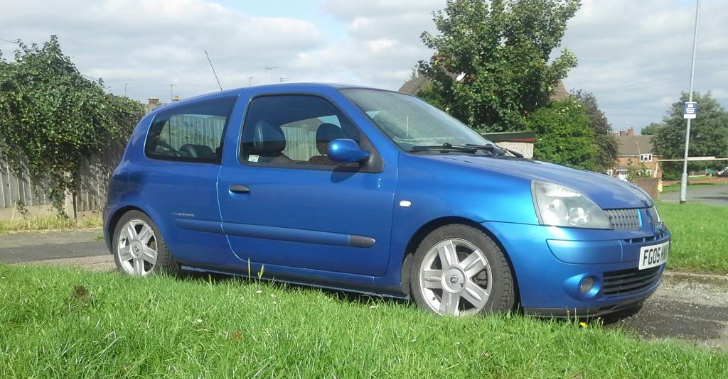

How mine was..

How mine was..
first pic looks so much better IMO
