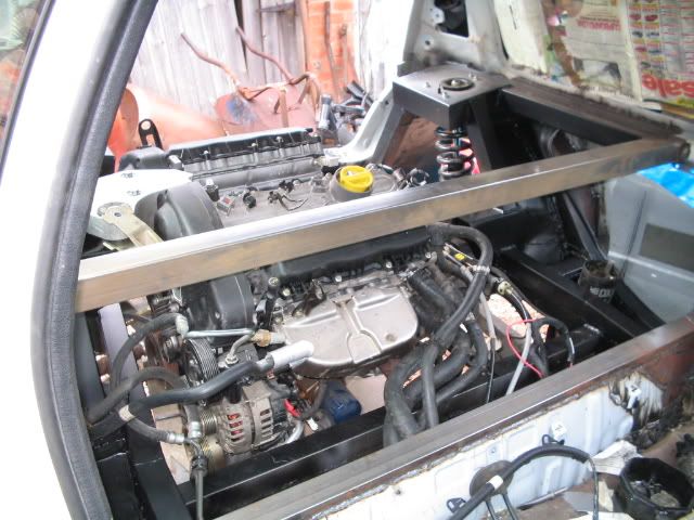

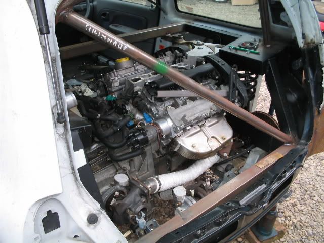

The car is a lot more built up than as shown on those pics.

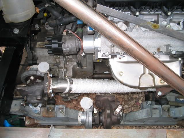

As to the T25s, I have info that reads_with comp trim 60. & 0.63 HSG A/R turbine, they will flow 38.16Lbs per , & make BHP 414.58, at 12psi.
As you can see its built from a base clio, I have a factory V6, I did not want to mod it, hence what you see.
So to build a car with minimum hassle, dizzy from one of the cams & twin carbs .
Pistons are forged made to order, rods are Pankli forged , comp is set at 9.2, the engine will have water/ methanol injection to the manifold to reduce detonation. The exhaust manifolds are retainded due to better heat retention & less hassle with useing made up steel jobbies ( cracking giving off heat etc), also putting the turbos where they are theres room to up grade to T3 Garrettes if need be.and the heat is kept to the rear of the engine bay, ( I think heat may be a problem)
A intercooler will be used, maybe in the roof with a scoop to draw the air in, or remove the rear glass & have one on each side.
Its not a problem to make the power, as said, its a case of stopping any thing from blowing up.
