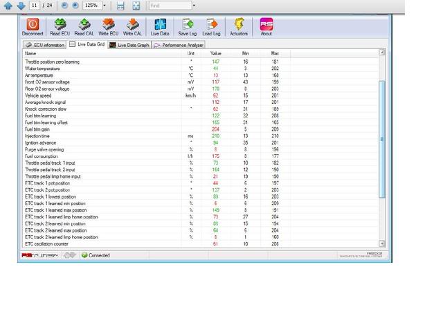

Hmmm my front O2 sensor I think may be fcked??
My front O2 fluctuates like f**k between 48.8 and 751.52mV
The rear O2 mine is about 400-439mV pretty stable.

bit of an update.
I was running the standard 6400.rst file according to my RSTuner and then the ron 98 .cal file on top of that.
Last night decided to chuck on the 6500_5404.rst and the 6500_5404.cal ron 98 file.
Seems to be running fine at the minute obviously it has to do a relearn but it idle a LOT better and doesnt jump around like it did before and stall.
