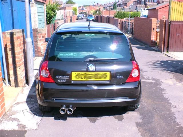

Only had it delivered today so its not fitted yet.
Some pics:
  Turbo'd MX-5 MK4
you want to undo the Renault mount and strip it down and rebuild it with a Ford type support, otherwise it'll shake all over the place and sit miles away from the bumper. The Magnex system is far too heavy for the standard Renualt mount and pulls it to shreds.

you have further details on this mate/how to do it etc? I have the KTEC with similar rear pipe and mines miles off the bumper how do i raise it!?!:eek:

if you look underneath the car (to the left of where the backbox is/will be, near the passenger side wheel) you will be able to see a large metal plate bolted onto the underneath of the car (2 -3 bolts) this holds the rubber support for the backbox (where the support arm on the left of the backbox pictured above goes into) undo this and removed the whole thing from the car.
Cut out the rubber support (Renault one is crap and won't hold the Magnex system properly), go to somewhere like Halfords and buy a 'Rubber exhaust mount' IIRC its a Ford type, can't remember cost exactly (but its no more than £10) then use something suitable like epoxy resin etc, etc to secure it in the metal mount, I also used cable ties either side of the rubber mount.
Refit the whole lot back on the car, and put the exhaust into the new mount, I also used cables ties to secure the exhaust more at either side. When I initially had my magnex system it would never sit correctly, always hanging to one side, so I took it to a local garage and had the whole thing re-fitted, i think they removed a section of the system near the cat, they said this enabled them to re-position the backbox and get it to sit correctly (cost me £20).
Use that secondry mount and you wont have any issues with that backbox.
Should not be able to sit lopsided if supported correctly on both sides of the silencer.
A lot of people don't bother then moan when it drags along the floor ;)
bargain cheers m8, replaced rear hangar already hoping that would cure it but it said renault on it so it clearly hasnt!

mine sits slightly lopsided, but havent replaced the hanger and needs raising up to the bumper by 2-3" ish

My Longlife stealth system always poked its head out from under my bumper, until i followed the above procedure, been trouble free ever since!
