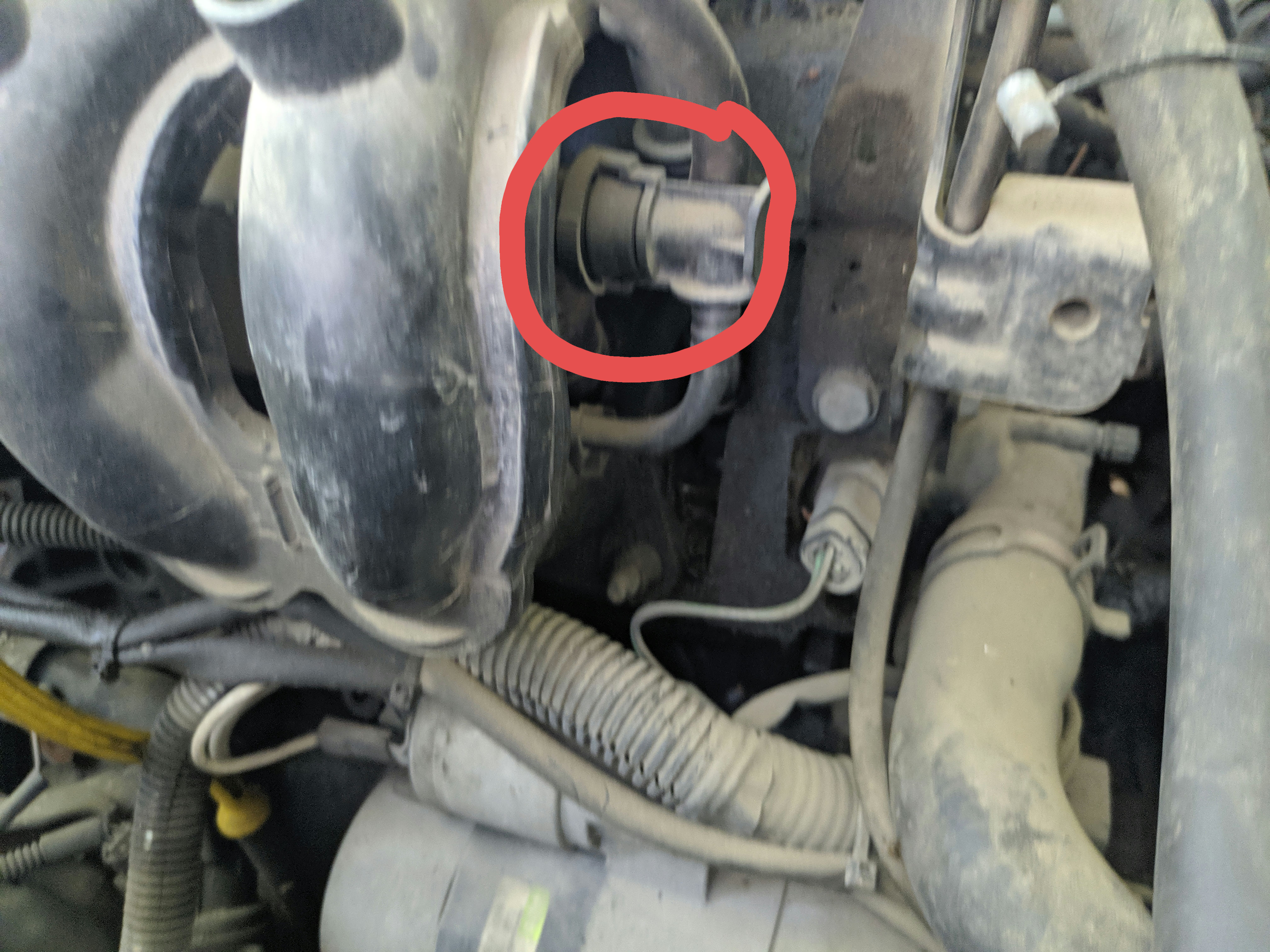

The problem in my case was the o-ring which seals the fuel line into the fuel rail. It was damaged which meant I didn't have adequate fuel pressure when accelerating. I put a new o-ring on and it solved it immediately!
  Clio Mk2 1.2 58hp
This? If o-ring is broken, won't fuel flow?
