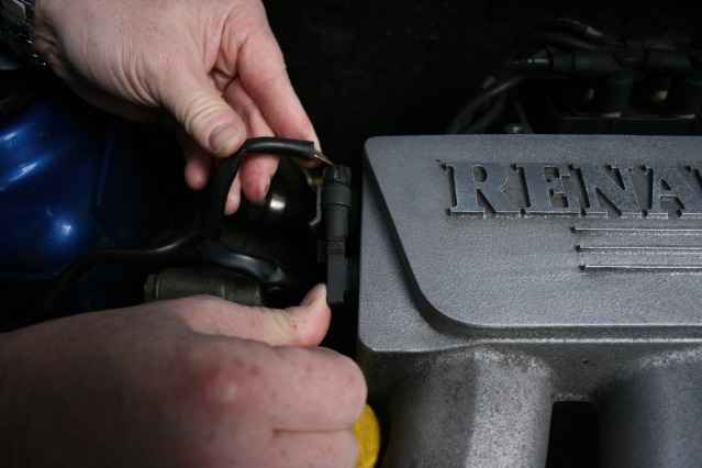

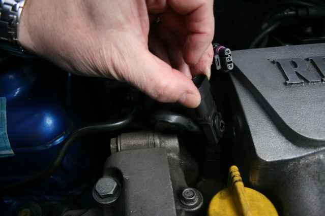

The MAP of Clio Sportt F4R730 is like that of K4M??
and second, where is located? what you see in front is the tps, but the MAP is below the plastic cover? If anyone can give me a reference would be great. or a picture!

MAP on a F4R...
Remove it carefully or this could happen...
