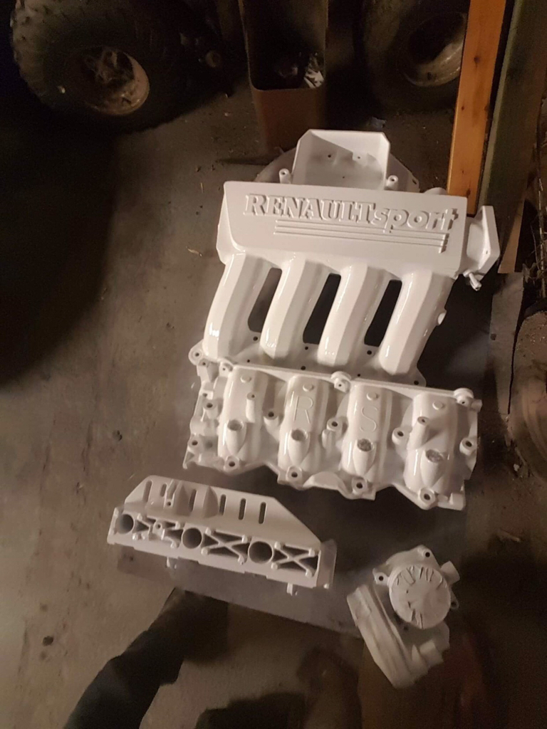

Does he do them on an exchange basis or is it send them off and wait? I saw he posted a pic of some done and ready to send to Ktec, what do they charge for his work?
