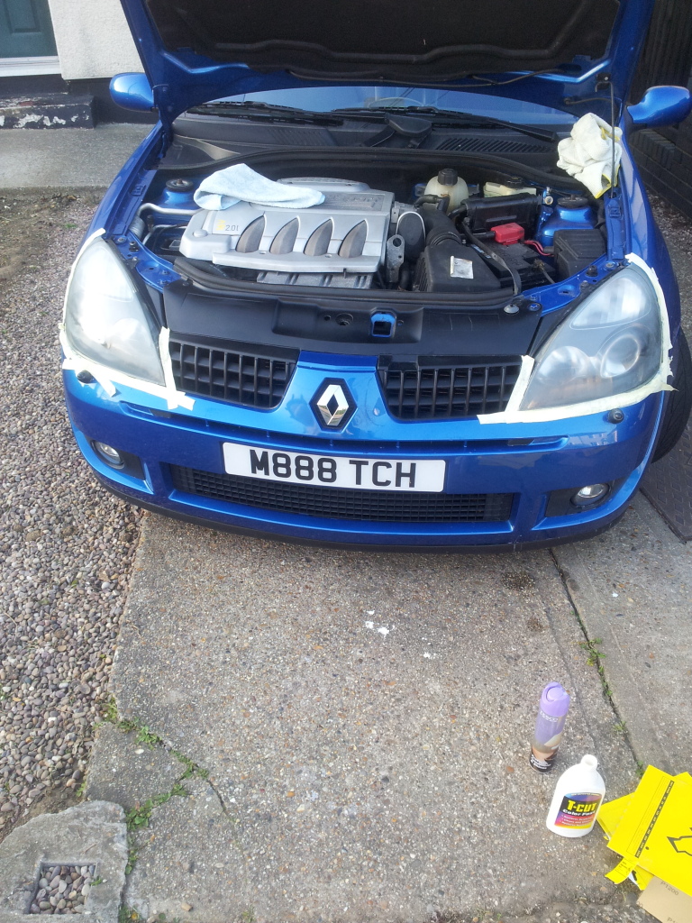

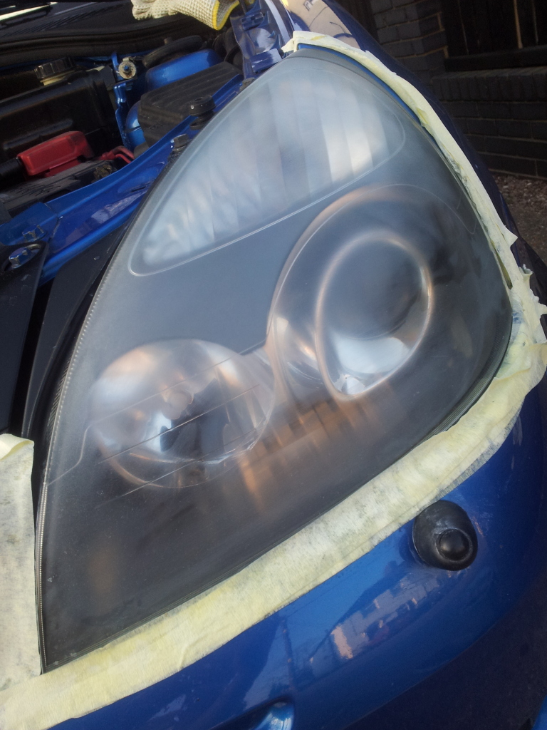

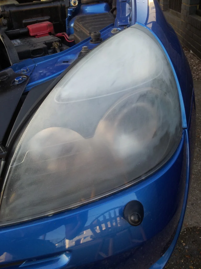

may have screwed up headlight restoratipn
Sanding for half an hour with 800 is mental.
2 minutes with 1200 wet then polish up and they'd be done.

Your committed now fella. As said work up thru the grades of paper till you remove the scratches.
You've just planned your bank holiday weekend sanding away.
Can't work out if you're near me or not.
I'd happily polish them up with my DA/rotary because I can see you're going to be there for ages if you don't even know what polish to use lol.
  Inferno 225 cup
800 isn't mega bad to be fair, just take your time and go over them again with a higher grit, polish up and should look a lot better.

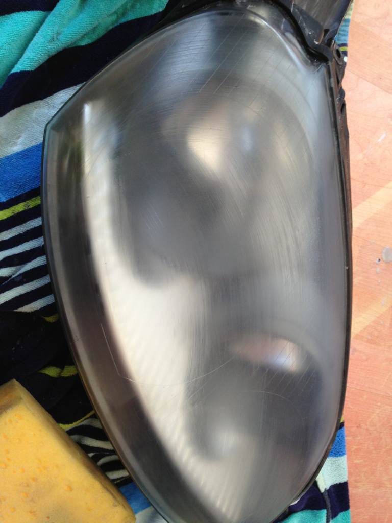

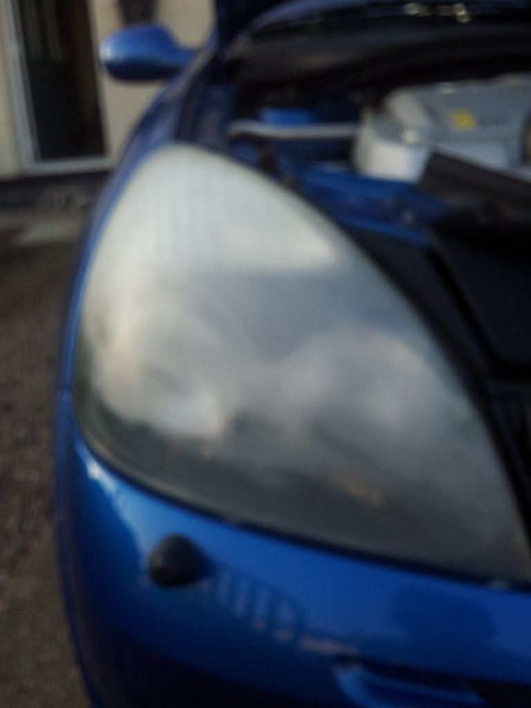

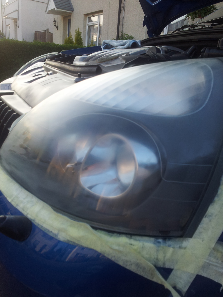

right so this is what it looked like after sanding with 800 for half hour

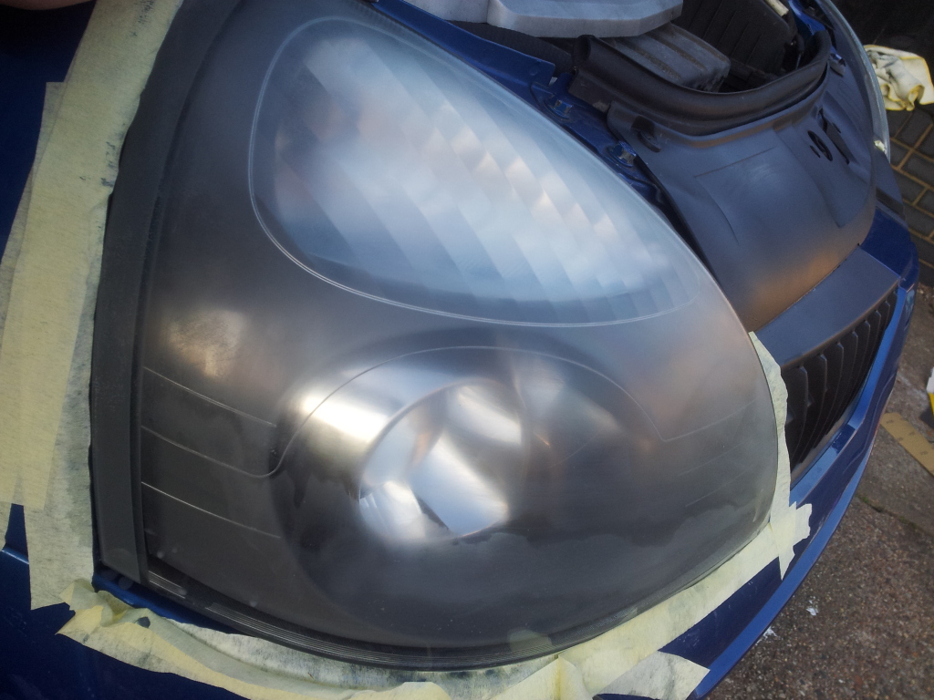

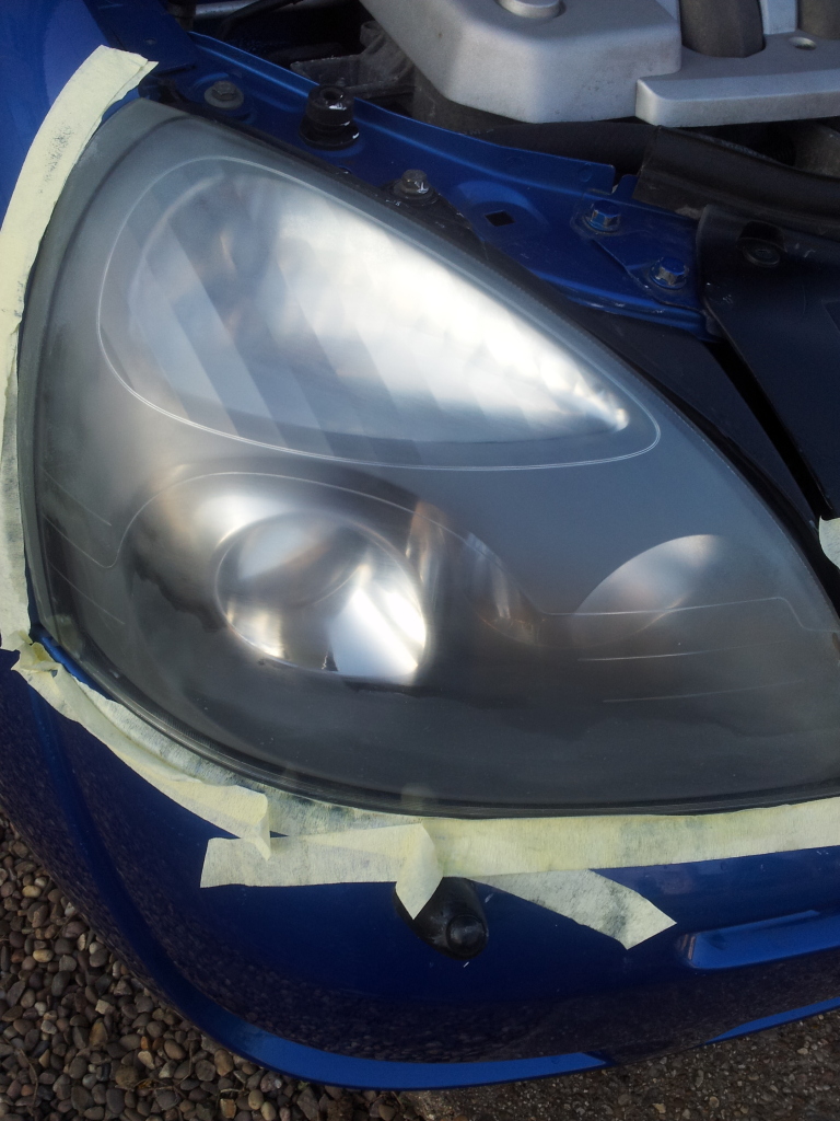

then today after 1200 then 1500 then polish with some paint tcut I had laying around need to get some plastic X i think it is?
So what should I do now do I continue sanding or should I polish it out?
what the best product to use on the headlights to polish out?

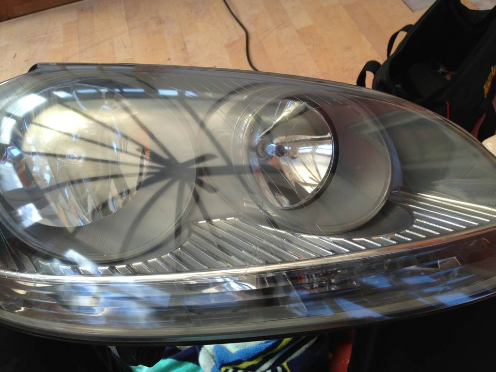

  Dynamique 1.2 16v
I used 1200-1500-200 grit paper, cleaned then down with warm water, then used some Meguiar's scratchX 2.0, and then some auto glym super resin polish! Came out like new mate! Like said before 800 is abit too harsh to start with, but you can only learn bud, at least they're rescue-able (even a word?) and you don't need to shed out on new headlights!

ok will get some of that tommorow but I am on the right path correct? and it is improving slightly?
yes, you look to be having a good sanding consistancy.
straight lines no circle'n or you will be having pig tails when polished up.
looks like you've taken the hazing out, but you'll only know how good it is after all the hard work you've put in.
rule of thumb- prep work makes all!
