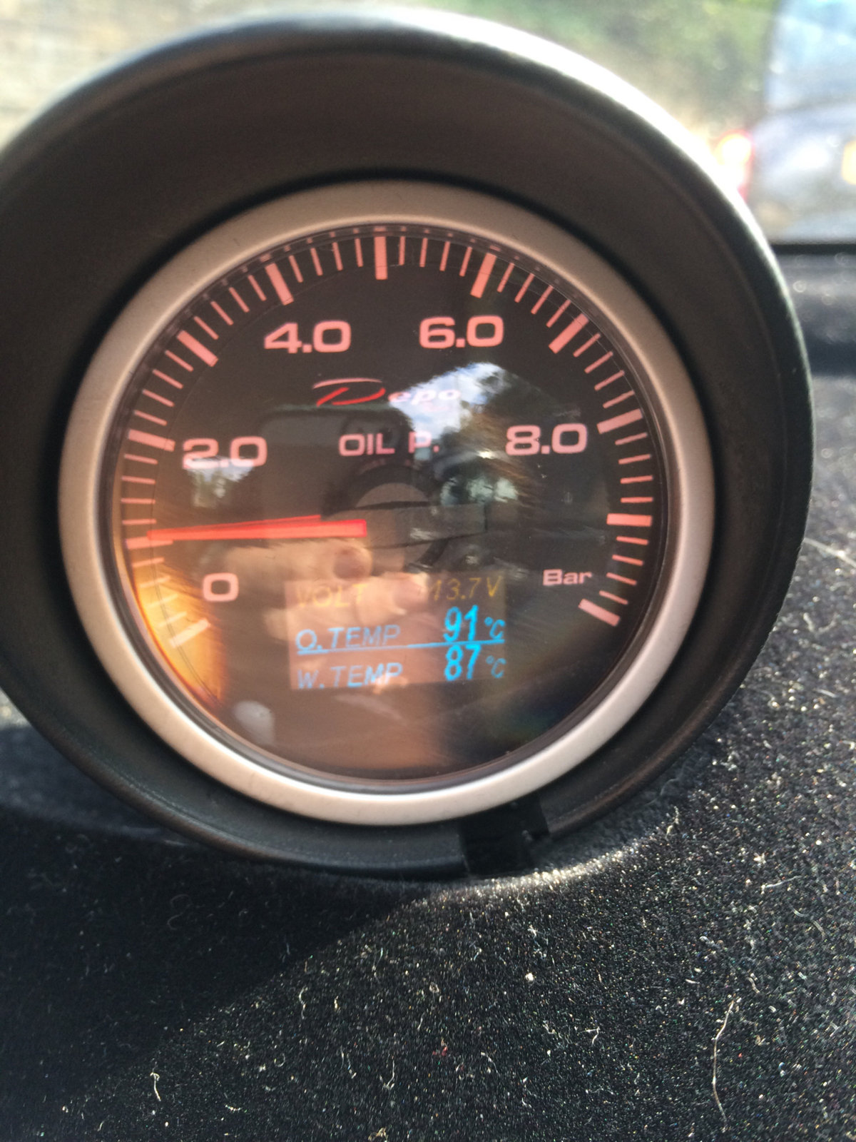

  172 Ph1
Took mine out earlier for a hoon , temps ok [emoji1303]
