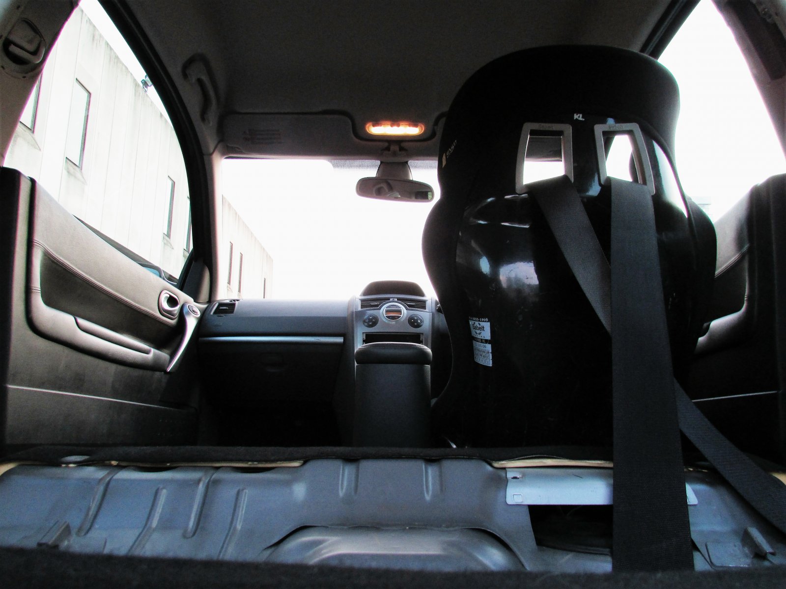

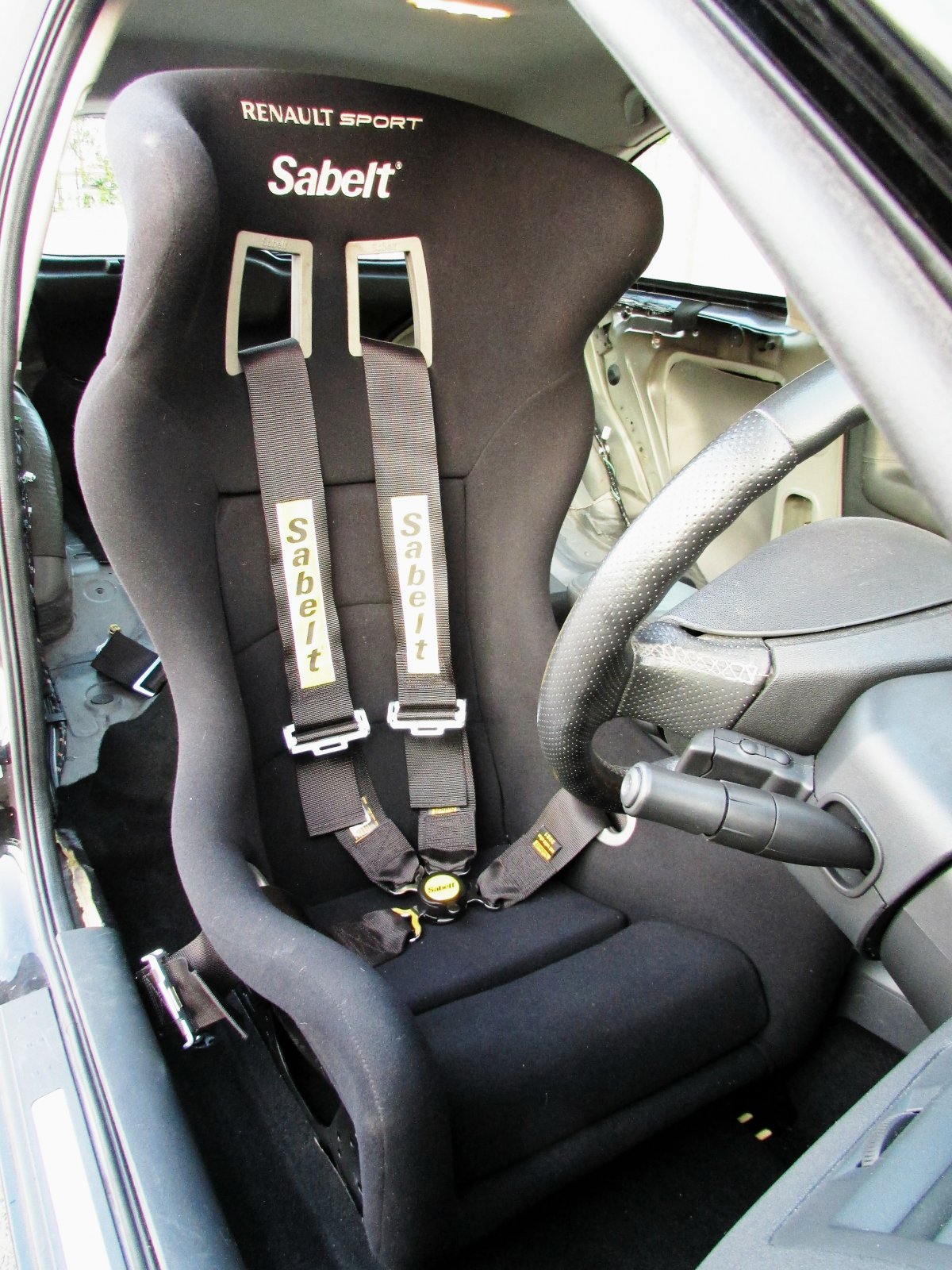

I've only owned it about 2 months and most of that time has been doing the work to it. There's 3-4 mechanical jobs to do then it's ready for trackdays. I should be at Blyton in July but I'll book a trackday hopefully at Brands before that.
BC Coilovers
New OE rear discs and pads
Brembo HC front discs, DS1.11 pads
Motul 600 brake fluid
New track rod ends
Geometry: 2 degrees negative C, 10 minutes toe out.
Sabelt Taurus XL Clio Cup race seat
Modified OMP XL side mount brackets
Sabelt 4 point harness.

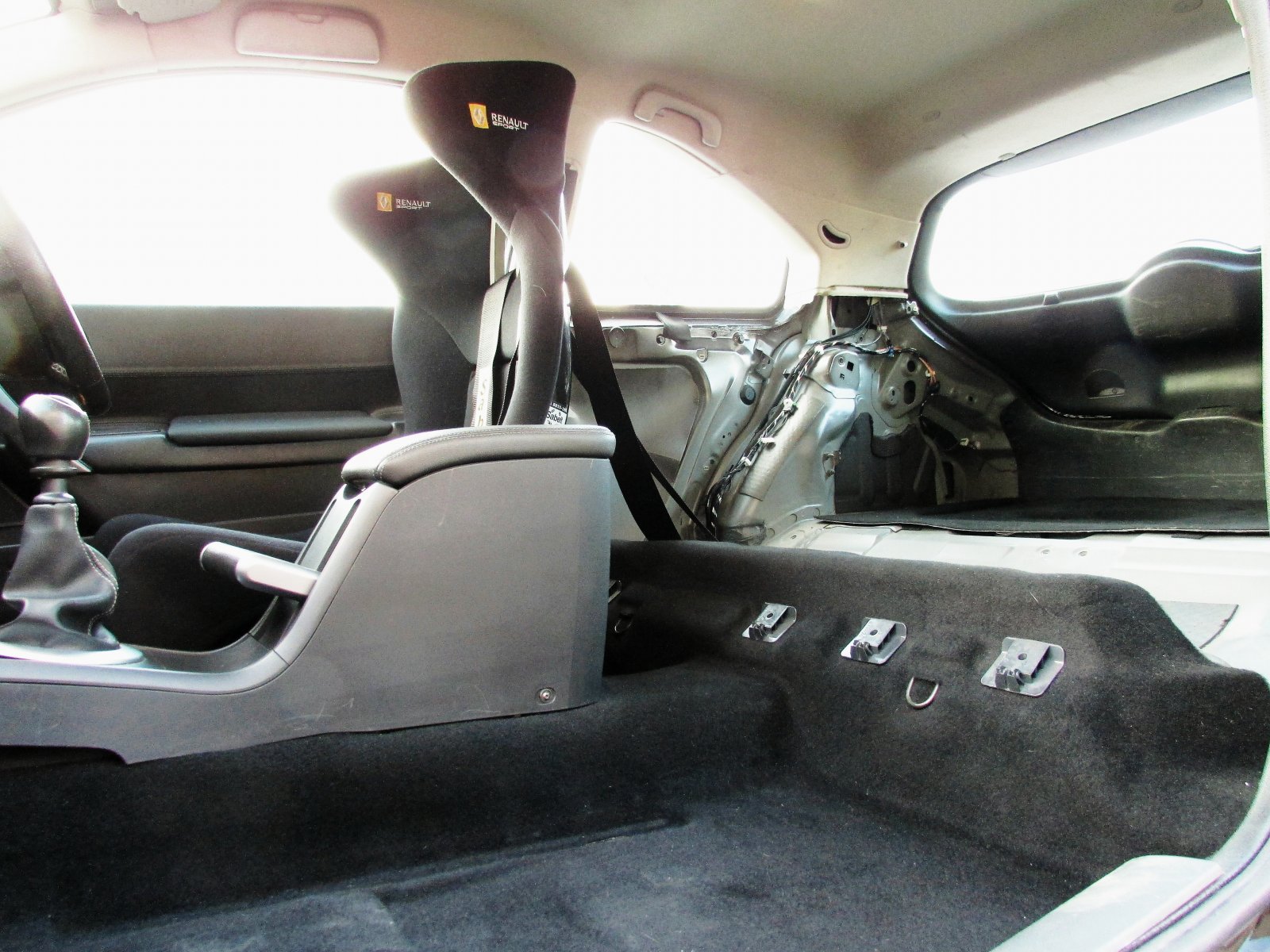

Almost! Needs new swivel bearings, all new exhaust mounts, ABS sensor sorting. There's other bits like fitting the R26R carbon spoiler when that arrives but that doesn't stop me from driving it.
  LY Megane R26 230
Looking at it you don't need that arm rest as it's adding extra weight so I'll happily take it off your hands :wink:
Ricardos
  LY 200 EDC
Well I was toying with swapping it over with a cloth one. I've put the leather rear door cards in the shed and wouldn't mind swapping the front to pov spec items..... Or going carbon and making my own.
