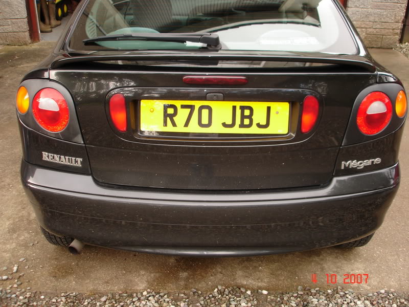

Ok before pics. - Very squirly, bird crap etchings, repainted bits, scuffs and scraches.

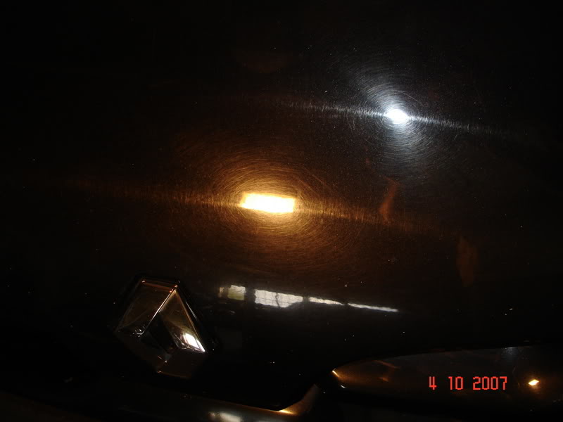

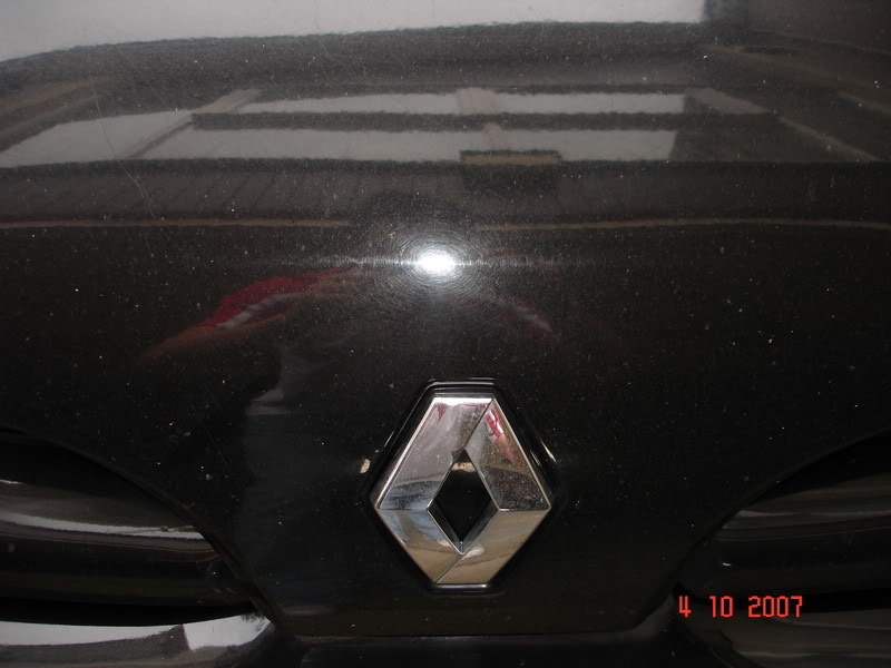

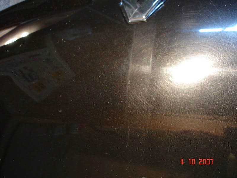

Pics of the bonnet before polishin.
after

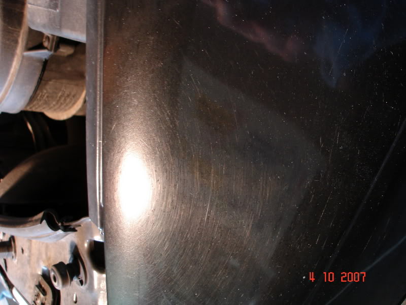

Wing before
after

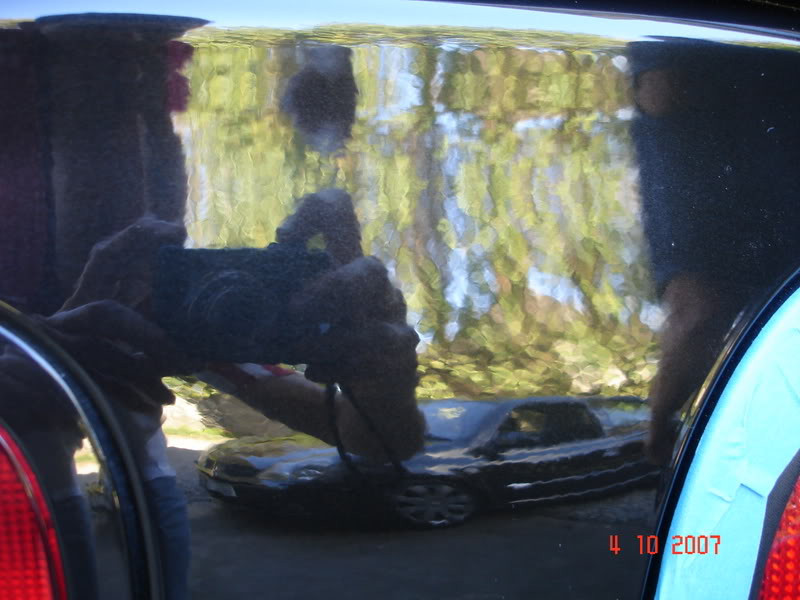

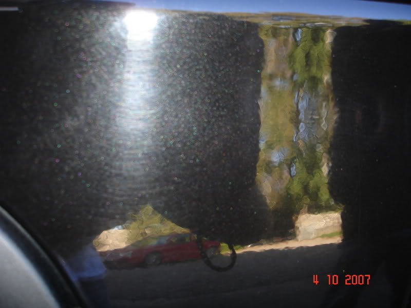

Boot before
after

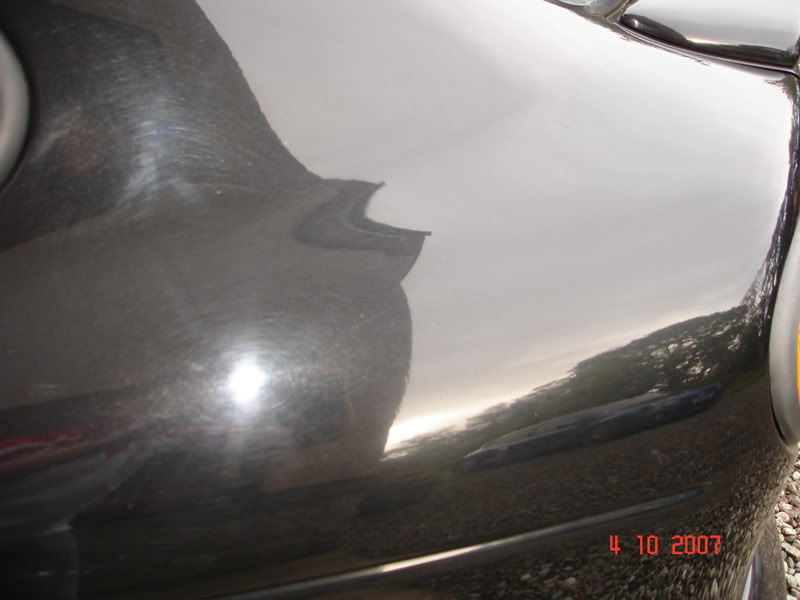

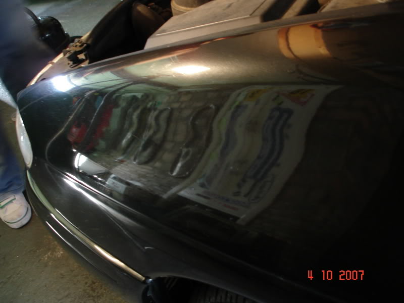

Nearside wing before
After
Car was polished with CG-3 Heavy duty compound. 3 test patches were done, the 1st was 3.02 IP, improvement but no great, 1500grit diamond cut was the 2nd before settling on the CG-3.
It's not something i like using as it's seriously aggresive, but it worked out ok imo. Apply'd on a 4/6in Edge spot pad! 3 of them! lol

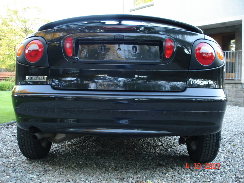

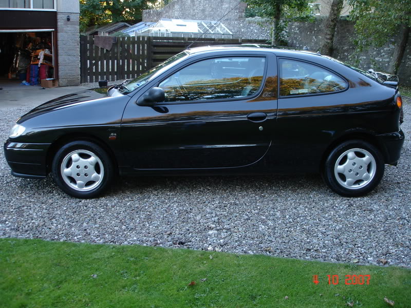

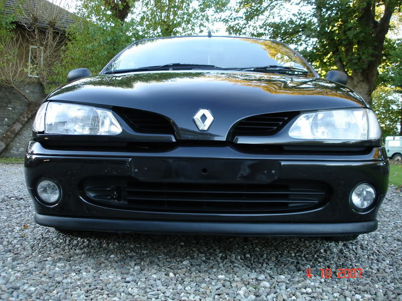

Final results...Not bad...Could of done with another day but heyho!
