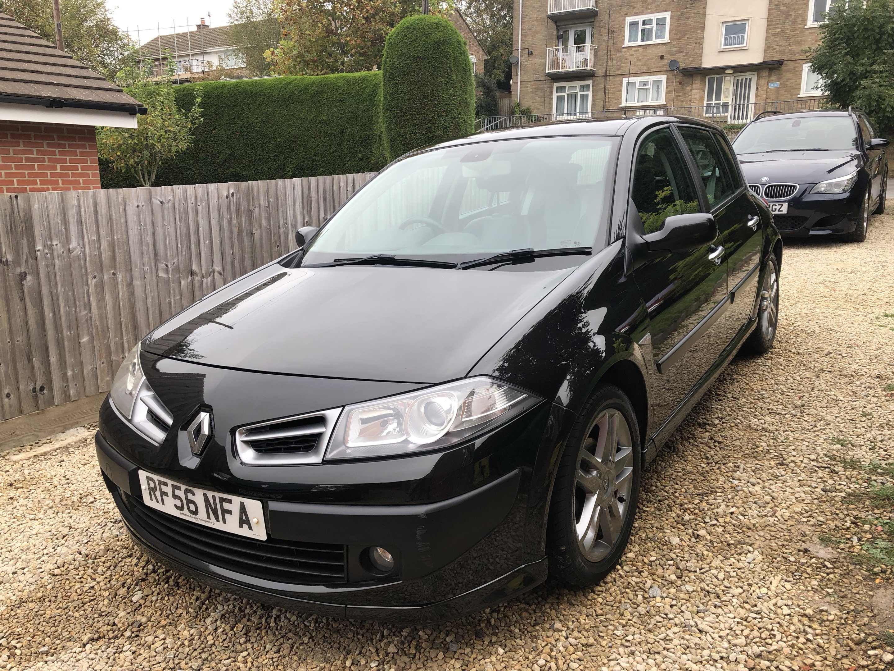

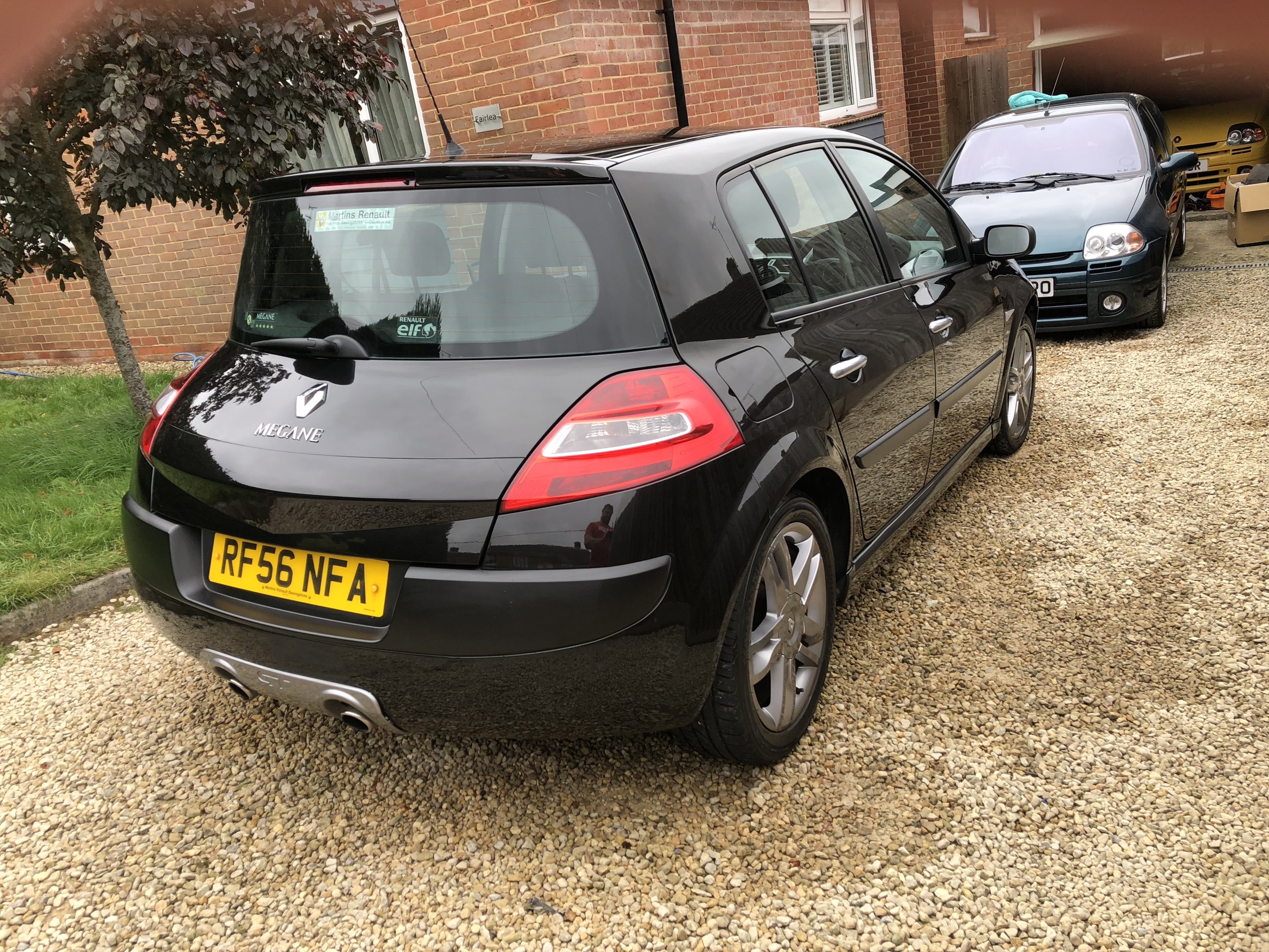

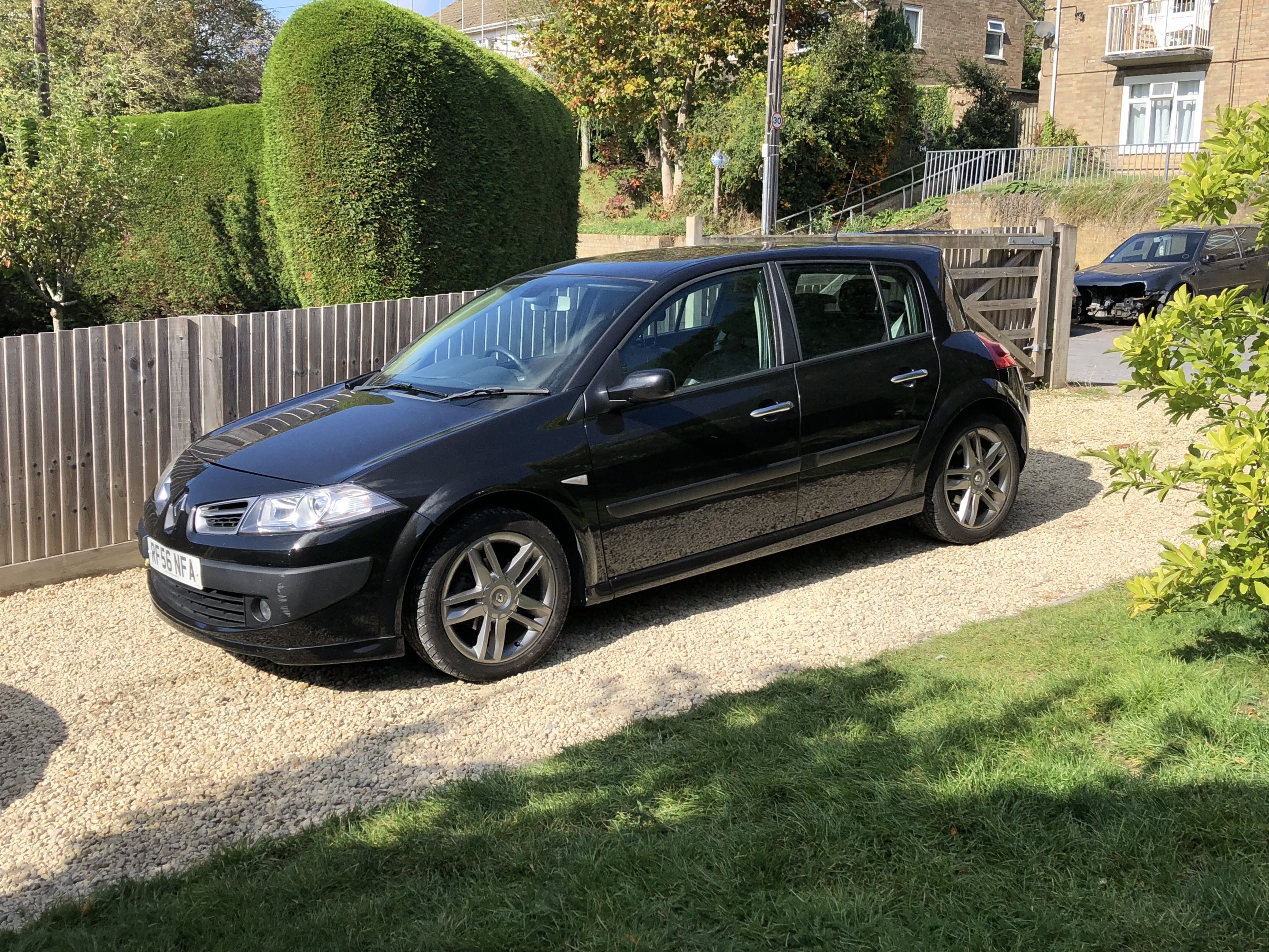

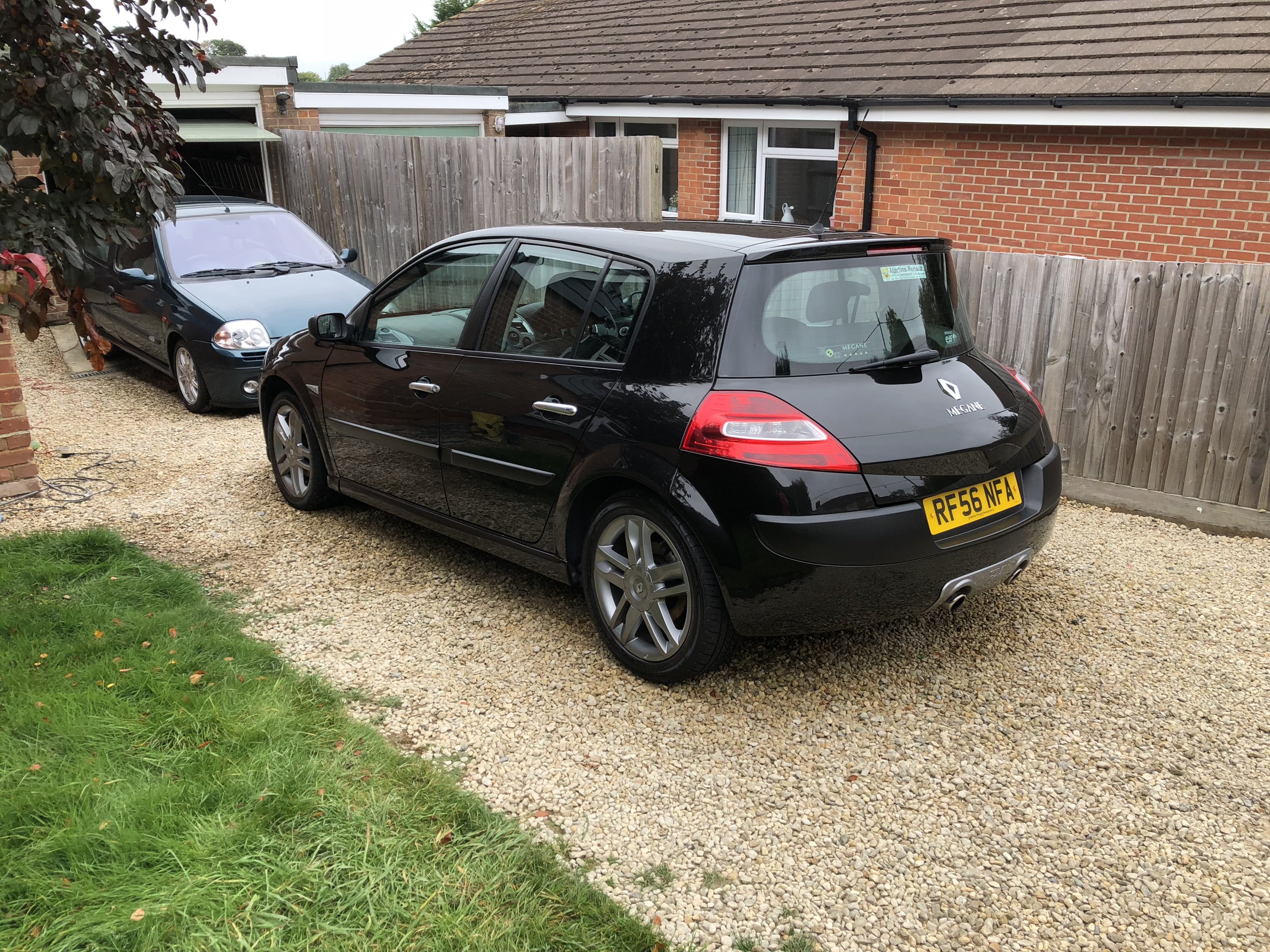

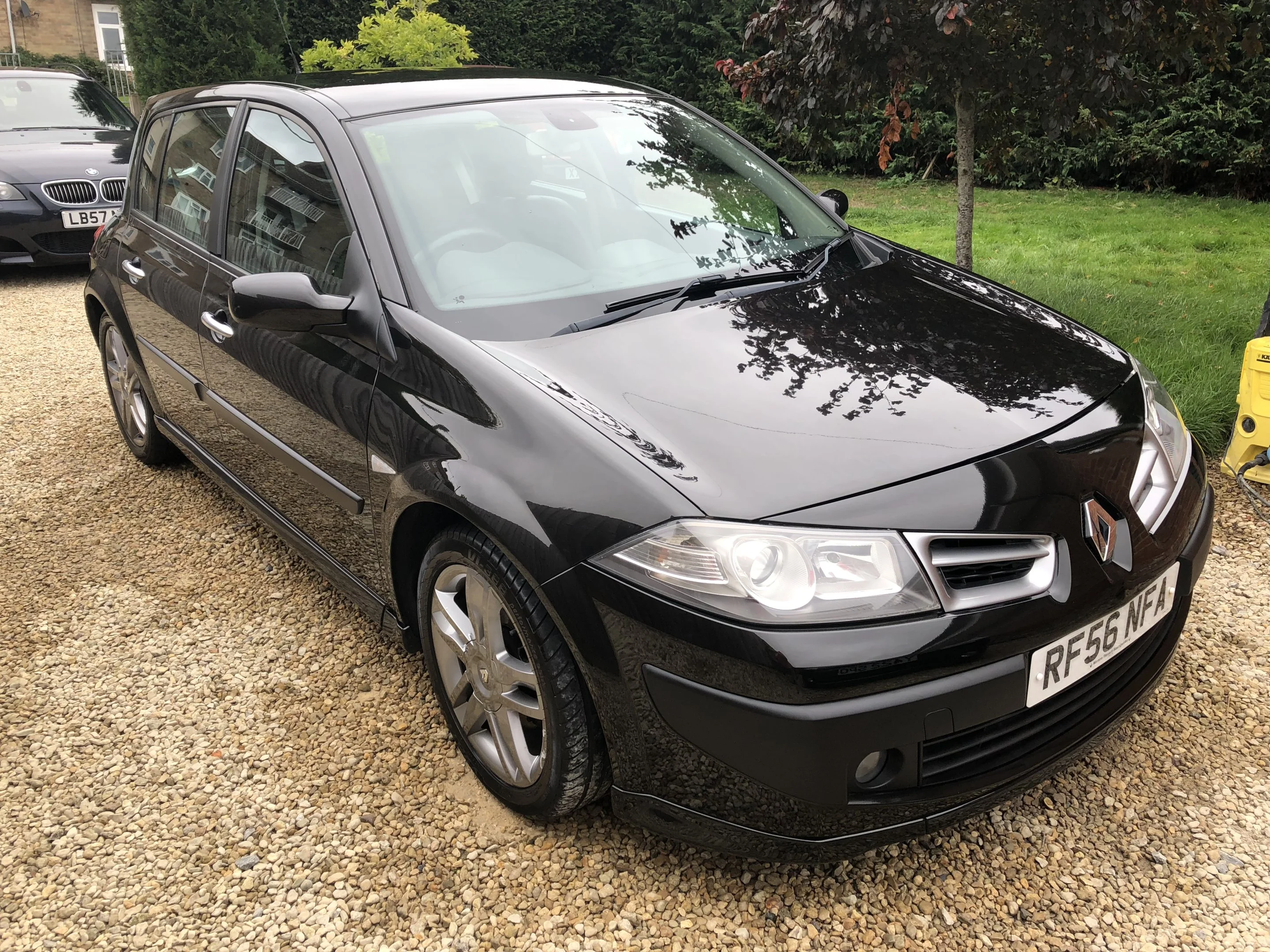

Picked this up for absolute steal today. Got it within 3 minutes of listing.
Full leather also, one owner from new, very good nick, 76k on clock.
Aircon needs a re gas, need to fix one window, and passenger side inner tie rod is fooked.
Will keep the M5 grounded over winter to avoid the salty roads.
600 beans!

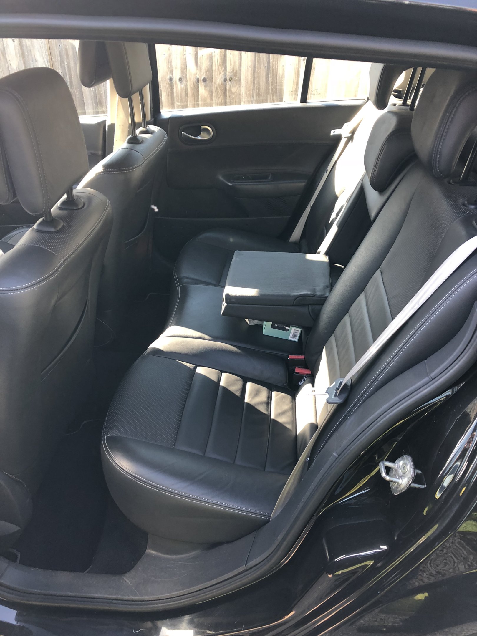

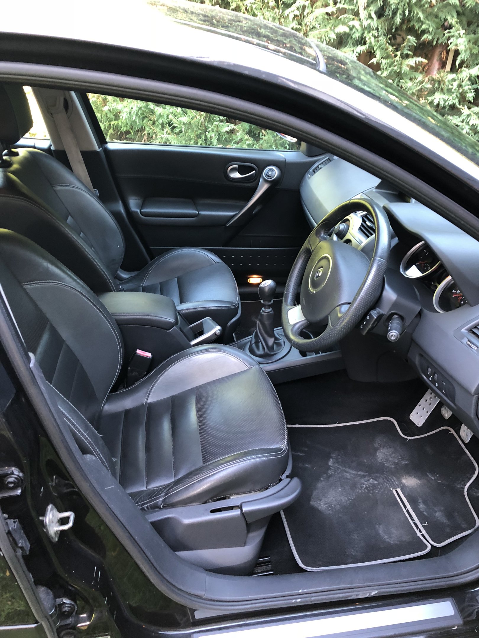

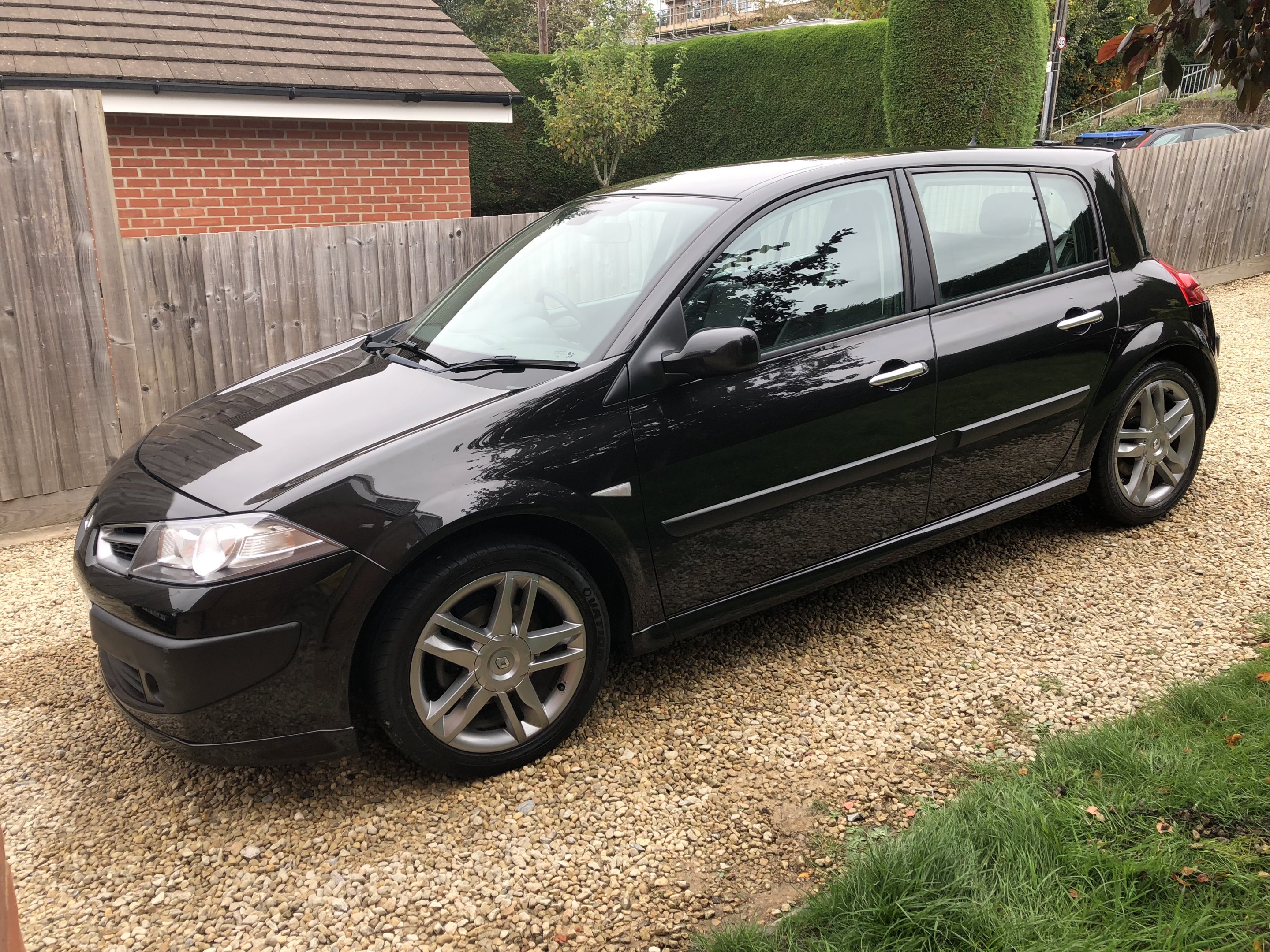

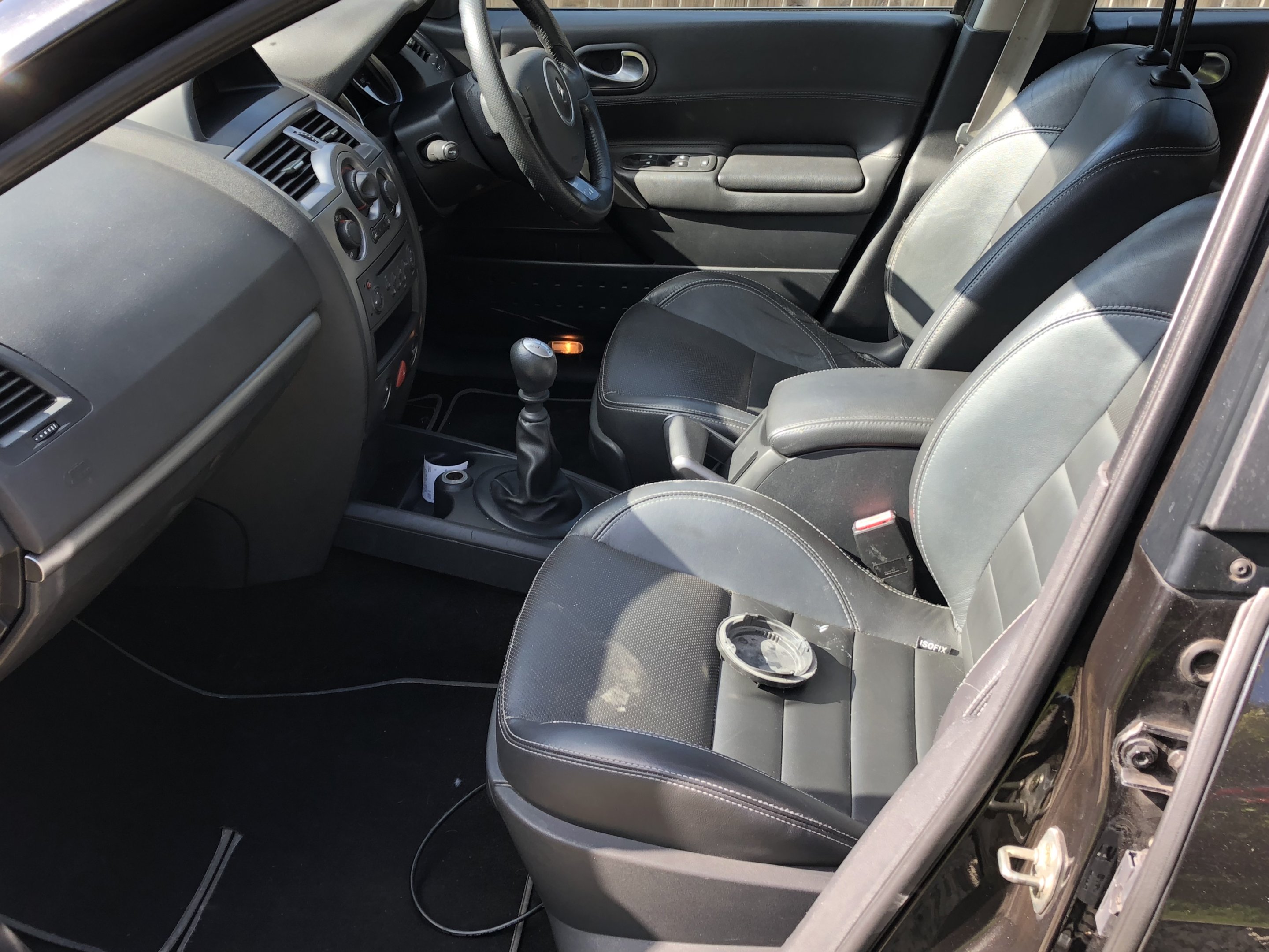

Spent a few hrs on the interior this afternoon, nice play to be to fair. Onto exterior tomorrow.

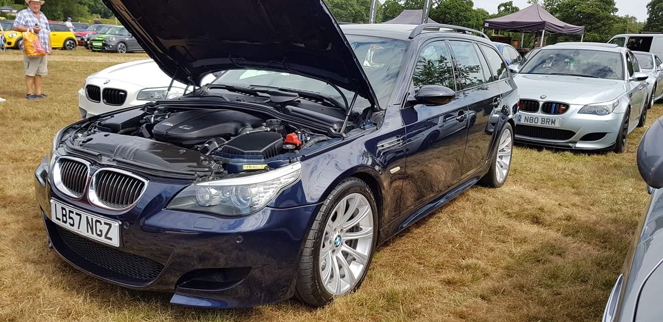

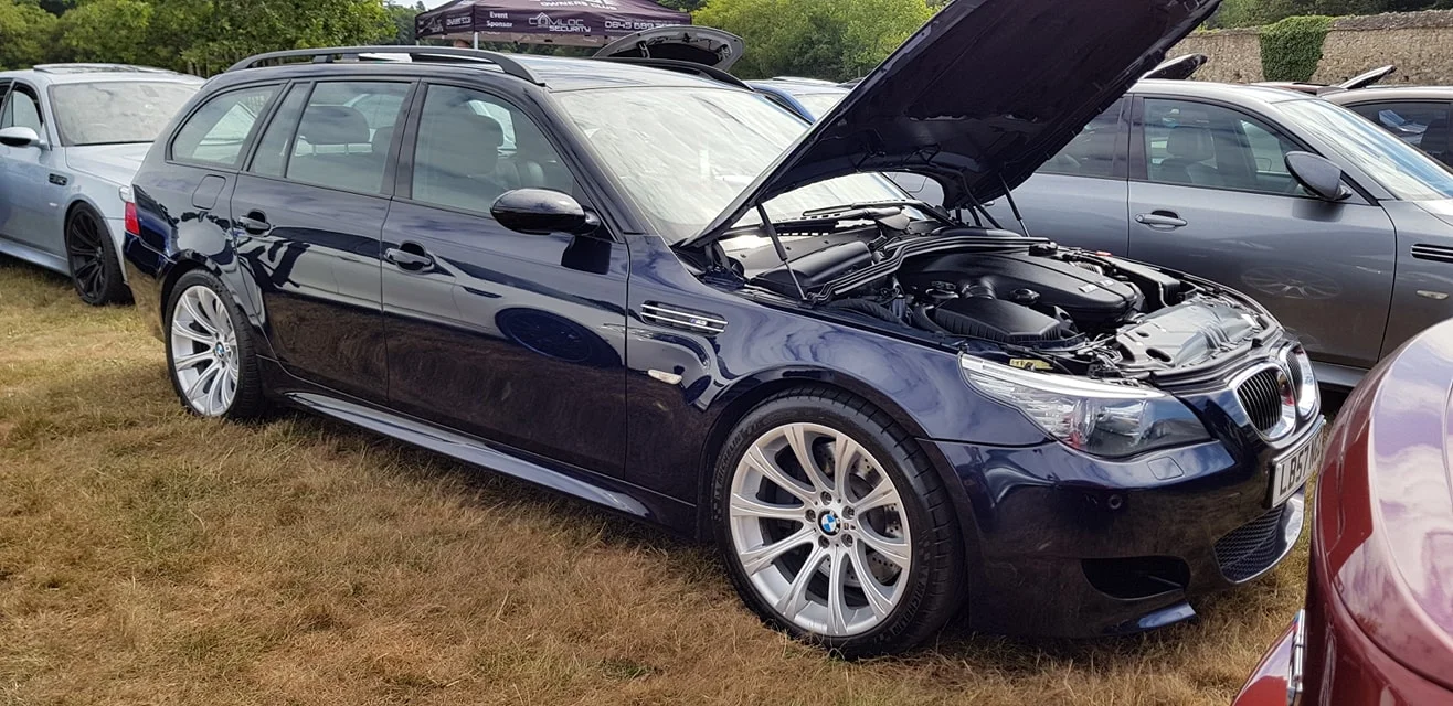

I’m sure you got it cheap and it does look nice but how you can bring yourself to drive that with the keys to an E60 M5 in the same pot I’ll never know
E61 ;)
I need a cheap mile muncher to use, M5 is still on the road but now the weather is turning I’ll be more picky on what days I use it. Plus it’s good for picking up car parts from around the UK. M5 usually costs more in fuel than the part itself ?
