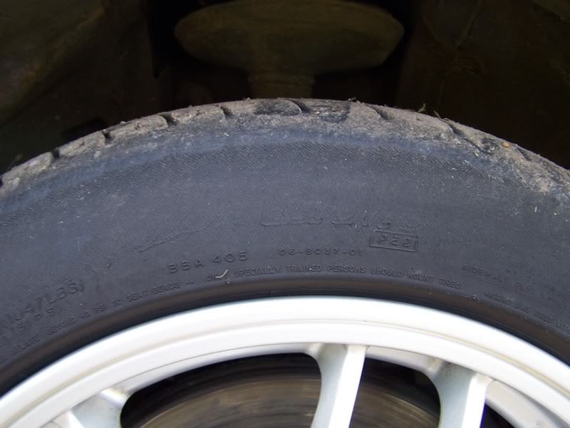

Yeah, you need to up those presure on track to avoid losing the Michelin mans head.
  williams and trophy
pah.
only 1/2 a job there lol. you could see the threads through the rubber, rim protector to thread was a perfect arc lol. no writing, no michelin man.....

out of interest what pressure do you run for a trackday ? upto the 39 max as stated in the handbook (for motorway driving)?

I ran 29f 27r cold.(exaltos)

fs that low ? mine looked as bad as the pic above just on road use ! @ ~ 35 and thought your sposed to increase psi for track ?

I usually decrease the psi for trackdays, means more of the tyre is in contact with the track = more grip
But also more chance of the tyre leaving the rim. The increased temperature softens the tyre, and road tyre sidewalls aren't as stiff as track tyres which can run low PSI. The extra load when cornering on track means you should really increase the pressure when running road tyres.
Most track day organisers mention it in the briefing.
