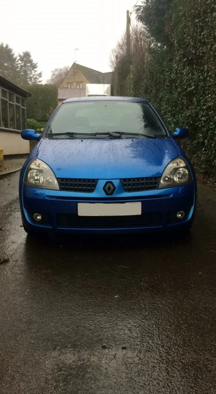

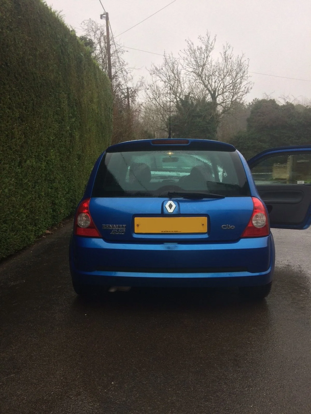

Having spent 3 years in Swansea whilst I was at Uni, I knew there were nice parts and not nice parts, the car was in the latter, however the chap selling it was great, showed me around it and it was as described, discs needed doing and tyres were pretty much gone. I did notice that the car was not in his name.... turns out it was gifted to him to pay a debt off, now usually alarm bells would be ringing so loud my ears would be bleeding, however I had already paid him via eBay, was standing in front of the car, it was sold on eBay and through Paypal, so suck it up and get on with it, got a receipt and began the drive home..
It actually drove really well apart from the brakes which when applied just made a horrific noise and made no apparent affect to slow the car at all. Much anticipation of traffic slowing I got the car back home and stuck into all the things it needed....
I changed the discs and pads, dampers and springs, gave it a service and used it, binned the wind deflectors, refurbed the wheels and added some Pilot Sports along with replacing the black Renault badge.

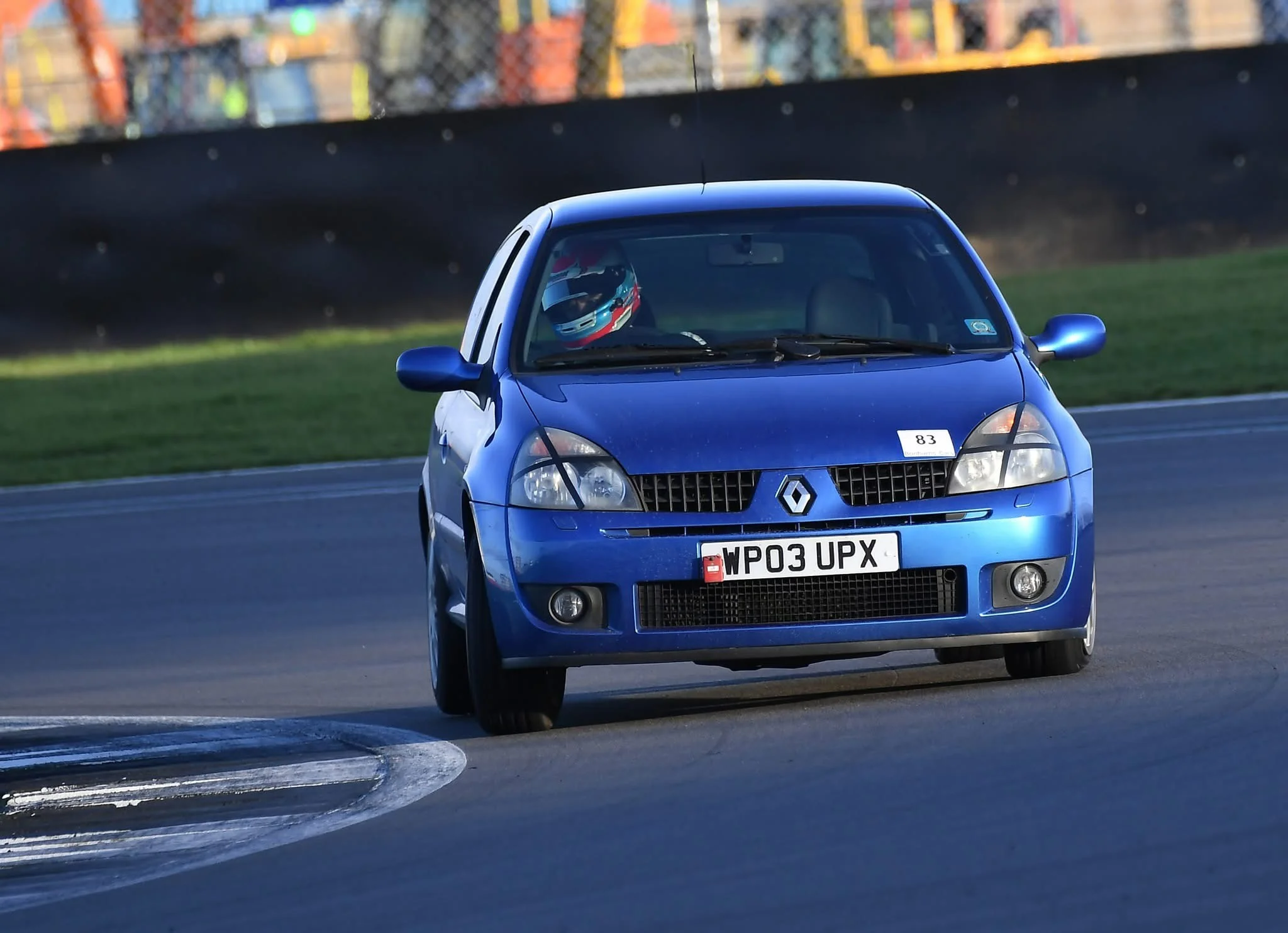

Did a sprint at Castle Combe in 2020, again really happy with the car..

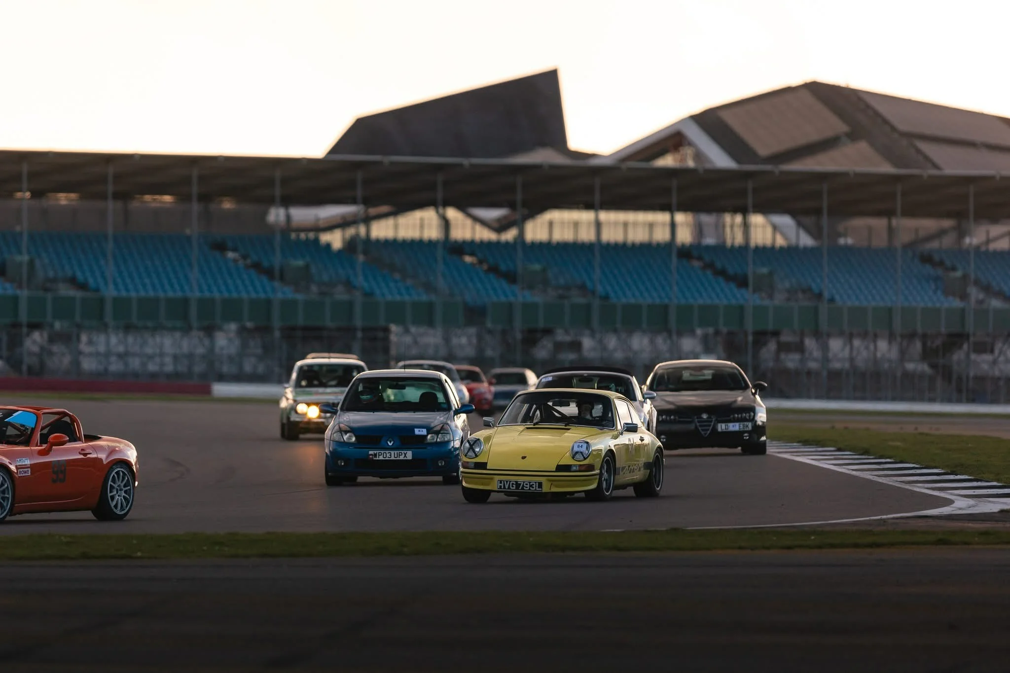

Fast forward to last year where I used it again at a Silverstone event, this was an event called The Pomeroy Trophy, basically an event where you carry out an auto cross style sections which are timed in the morning then a high speed test where you are placed in groups and based on your cars performance you have to complete a set number of laps. Richard Hammond and his daughter were also doing this and the Clio made an appearance in the Youtube clip about it (I was actually trying to get changed as I was lining up for scrutineering and didn't realise i was being filmed-thankfully he didn't film inside the car!)
The morning sessions were fine if a little slippery and then waiting for the afternoon sessions to start.

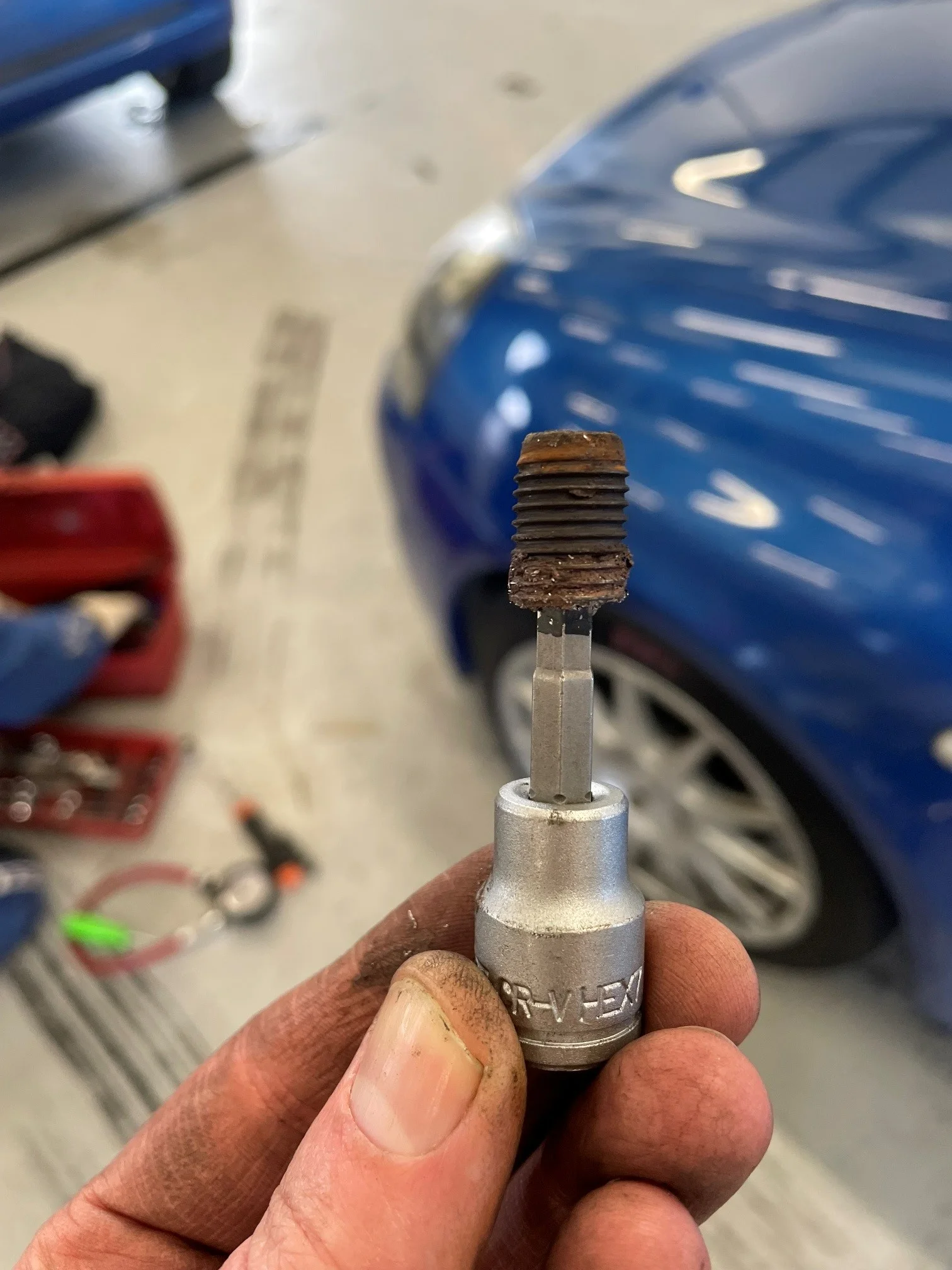

I had been placed in the fast group along with 911's, Audi TT's, all sorts of cars really as well as a race prepped GT40 which was lovely. I did my usual check over the car, oil, tyre pressures, coolant, quick check on the wheel bolts.....hmmm that feels like it needs just a little nip more....snap!........................ many expressive words later, I had around 20 minutes before needing to get out, quickly I find a drill and some new drill bits and attempt to drill the bolt out, my plan was to drill a hole so that I could hit a allen headed socket into the hole and hope to turn the remains of the bolt out... and with many prayers later it was removed with plenty of time to spare..
Event went well, the car was quick, I was only overtaken by the GT40 and a race spec BMW 2002 on slicks, finished 7th overall out of 50 something and won my class.
