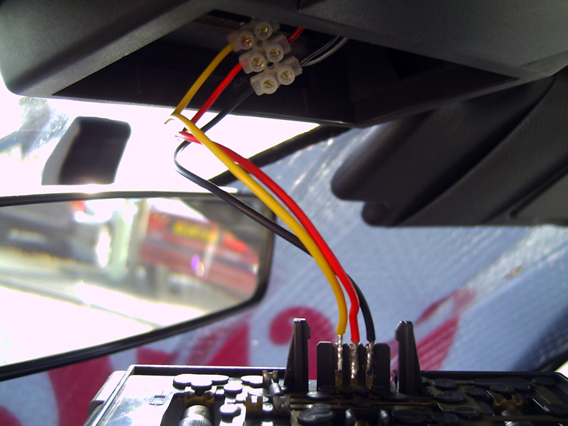

My idea of a fix for the corroded plug due to the leaking (now fixed) sunroof.

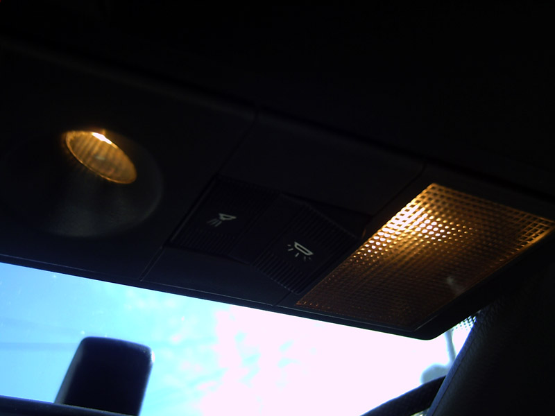

Working :cool:
I think I spent almost a year without an interior light and I was like a kid with a new toy when I realised it came on with the CL/dimmed out slowly etc. :eek:

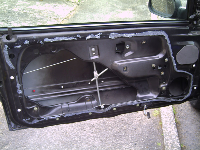

Passenger electric window motor and loom fitted:
When I had a fit in my head to replace all the blown illumination bulbs, oddly all the bulbs on the centre (heaters, clock, ciggy lighter) were all blown. Still got one more to go being the dipped beam light on the instrument panel:

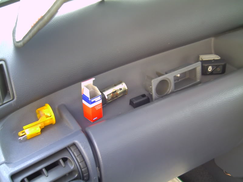

Also had to get the ciggy lighter working again for my phone charger and the like. Had alot of corrosion.

2thumbs how easy was it to install the electrics? Did your doors have the loom plug already in?
Piece of pish mate.
Install the wiring (starting with the furthest away being the central locking solenoid plug) via the hole in the door where it meets the bulkhead, clip it all in, plug in the central locking/electric windows etc, then plug in the big plug into the bulkhead socket. No modifying of the main loom needed at all.
The motor's are a tw@t to fit though. Need two people and it took me about 2 hours to do the first one all in all. Second ones took about an hour.

how did you fix the sunroof? i have a second shower when i drive my car after its rained...
If it's leaking between the glass and the seal, you will need to seal it up completly and you wont be able to use the sunroof again.
Luckily mine was leaking between the plastic trim and the roof due to the sealant breaking down (check around the trim for gaps) so I bought some Clear Unibond bathroom sealant in B&Q.
Remove all the old sealent with a sharp plastic object (so you dont scratch the paint) then lift up the plastic trim and start putting the sealant inside all the way around. When that's dry, do the same again but on the edges of the plastic trim where it meets the bodywork.
That way you'll have two leak proof layers incase the outside one starts breaking down.

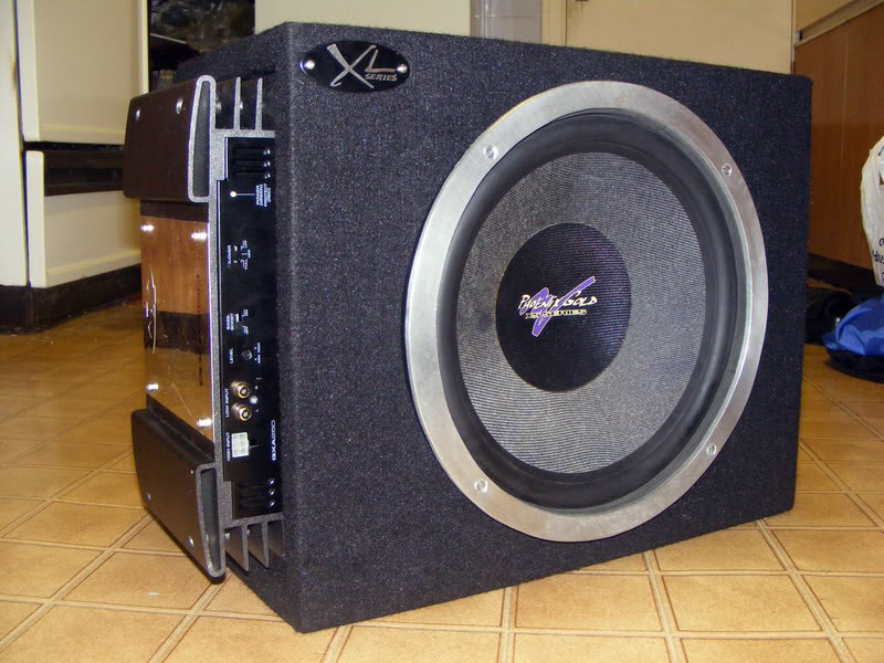

As the car's going in to the sprayers first thing tomorrow morning, I took everything out of the car earlier.
Considering I had them both out I decided to finally fix the amp to the sub box after months of it flying around the boot! :lmao:
It's one less thing to do. :D

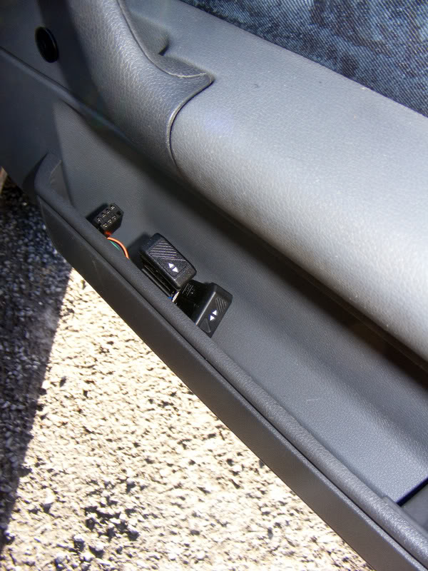

my new door pockets arrived just now (Much thanks to Rob_Clio :D). So now the electric window/mirror switches wont be floating around with visible wires.
Just a shame there's no car to fit them in! :lmao:

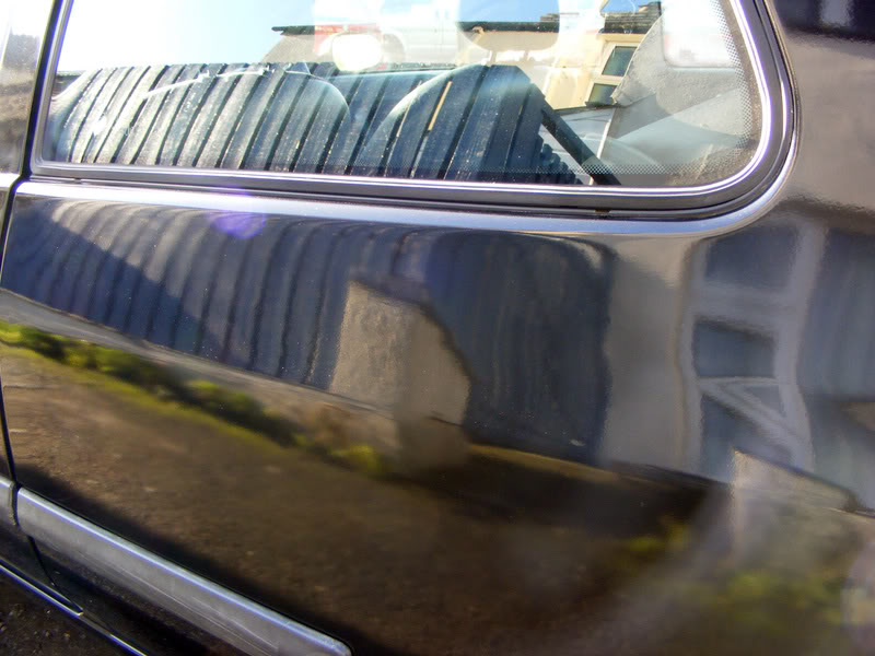

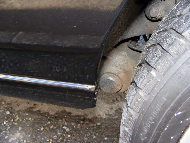

N/S rear quater where the scratch was, just below the rear side window:
N/S arch where the worst rust was, just to the left of where the torsion bar cap is:
O/S rear arch which had rust bubbles in general all around the edges:

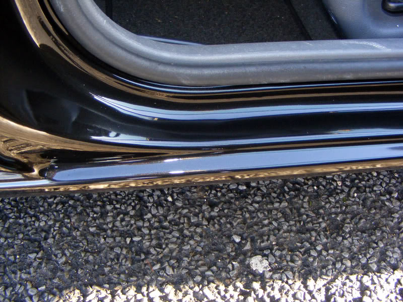

Drivers side door shut which had rust coming through too:

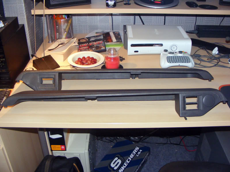

Now the Door Pockets...
Before:
After:
Took a bit of modification to fit, but they went in nicely in the end.

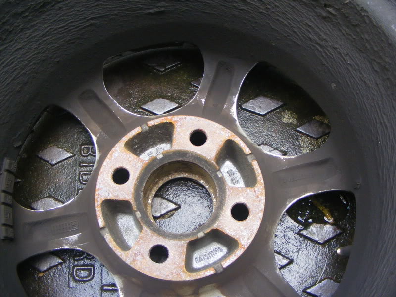

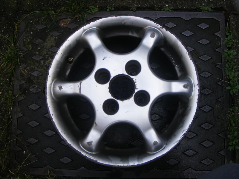

Gonna be making a start on refurbing the old Speedlines tomorrow.
Here's the worst one at the moment.
Proper nasty-ness.
I'll be posting pics with progress as usual. :)

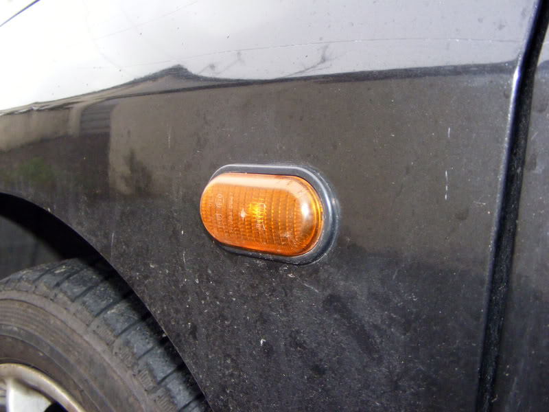

Broke my old repeaters, so splashed out on some better ones:
From:
To:
I know it's dirty, but I aint washing it! :D

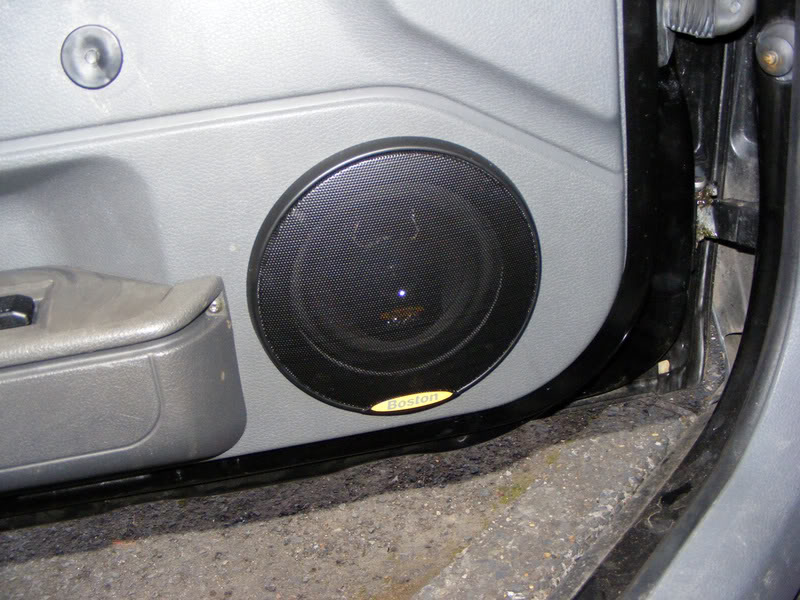

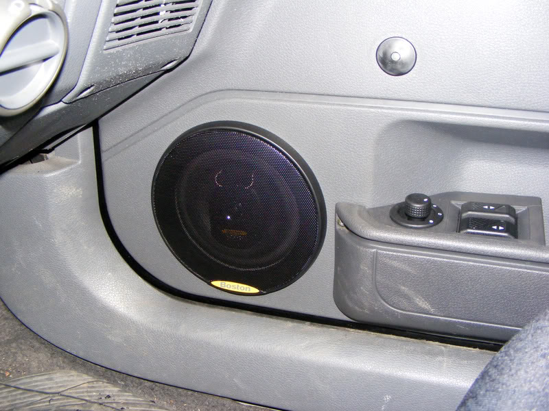

Got my Boston Acoustic speakers fitted in the doors at long last.
Took an age was poverty spec models didn't come with speaker holes.
