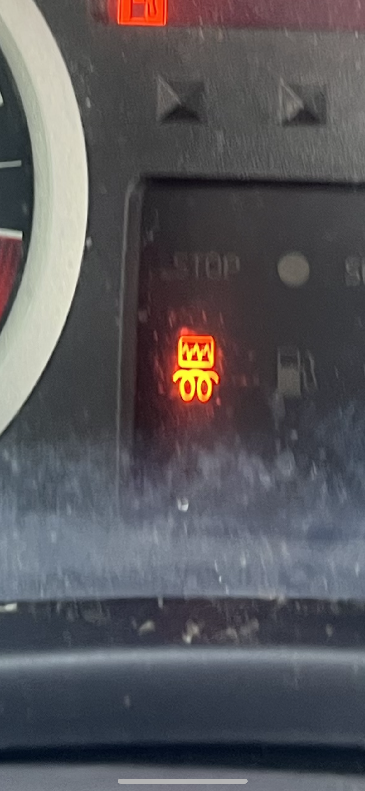

I had some ball joints replaced today. While driving home, after about 10 minutes of driving, while accelerating these lights appeared. As soon as I eased off the accelerator, they went out.
Change gear, accelerate and they come on while my foot is on on the pedal. As soon as I lift off, they go out.
As they come on, the car sort of misfires and stutters a bit for a split second.

That is the eml light. You need to scan it with can clip to see what codes are stored as could be several problems

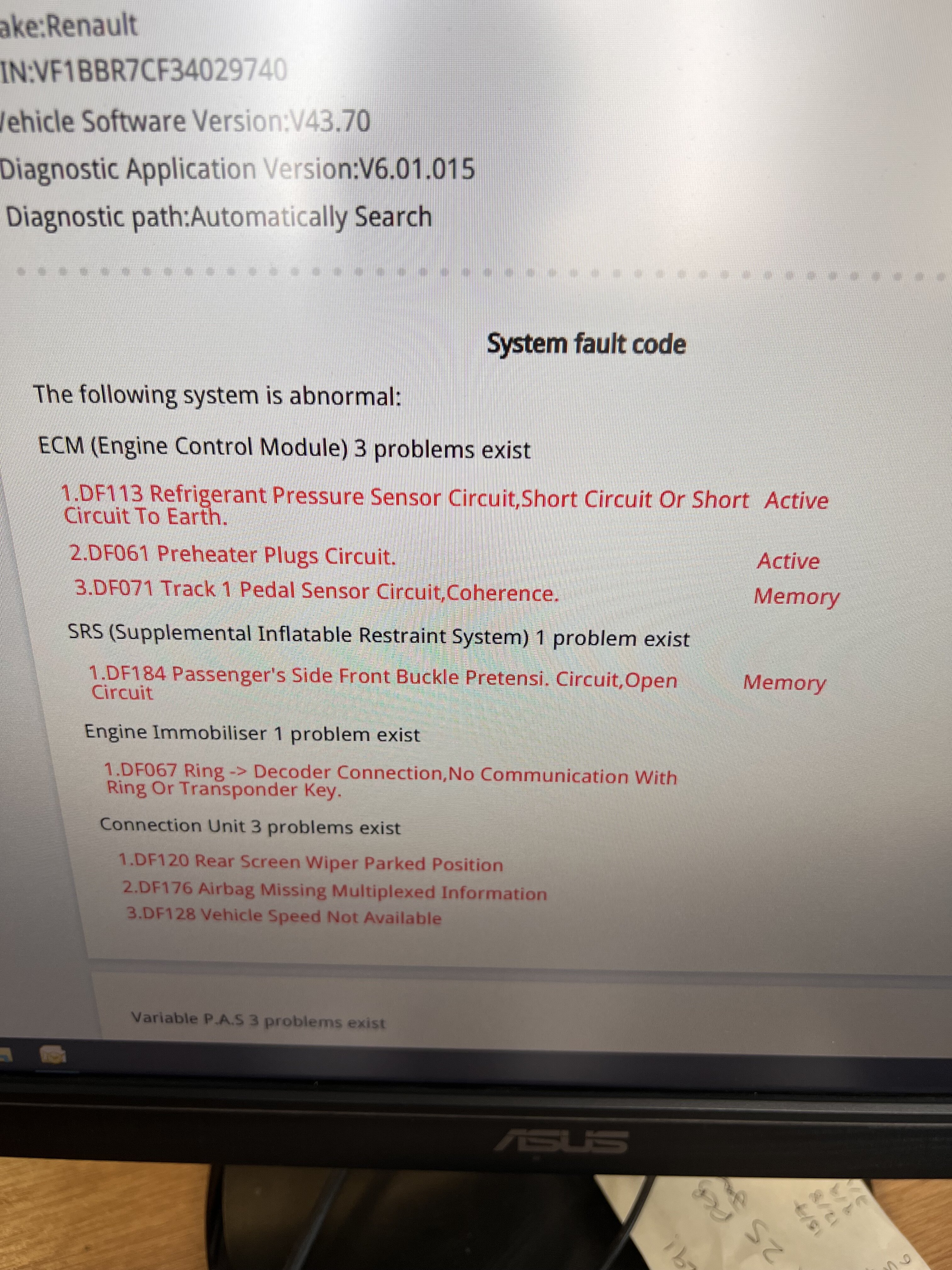

Glow plug fault does not trigger the eml, both of mine have it stored permanently.
Only fault that will chuck it into limp in that pic is DF071 which is faulty accelerator pedal.

Weird one that as the code you've got there is related to glowplugs

Audatex VHC2.
You need can clip ideally mate. Generic might not show up all the df codes.
Throttle pedal would be my first go to looking at that, had 2 fail putting it in limp intermittent over the years.
