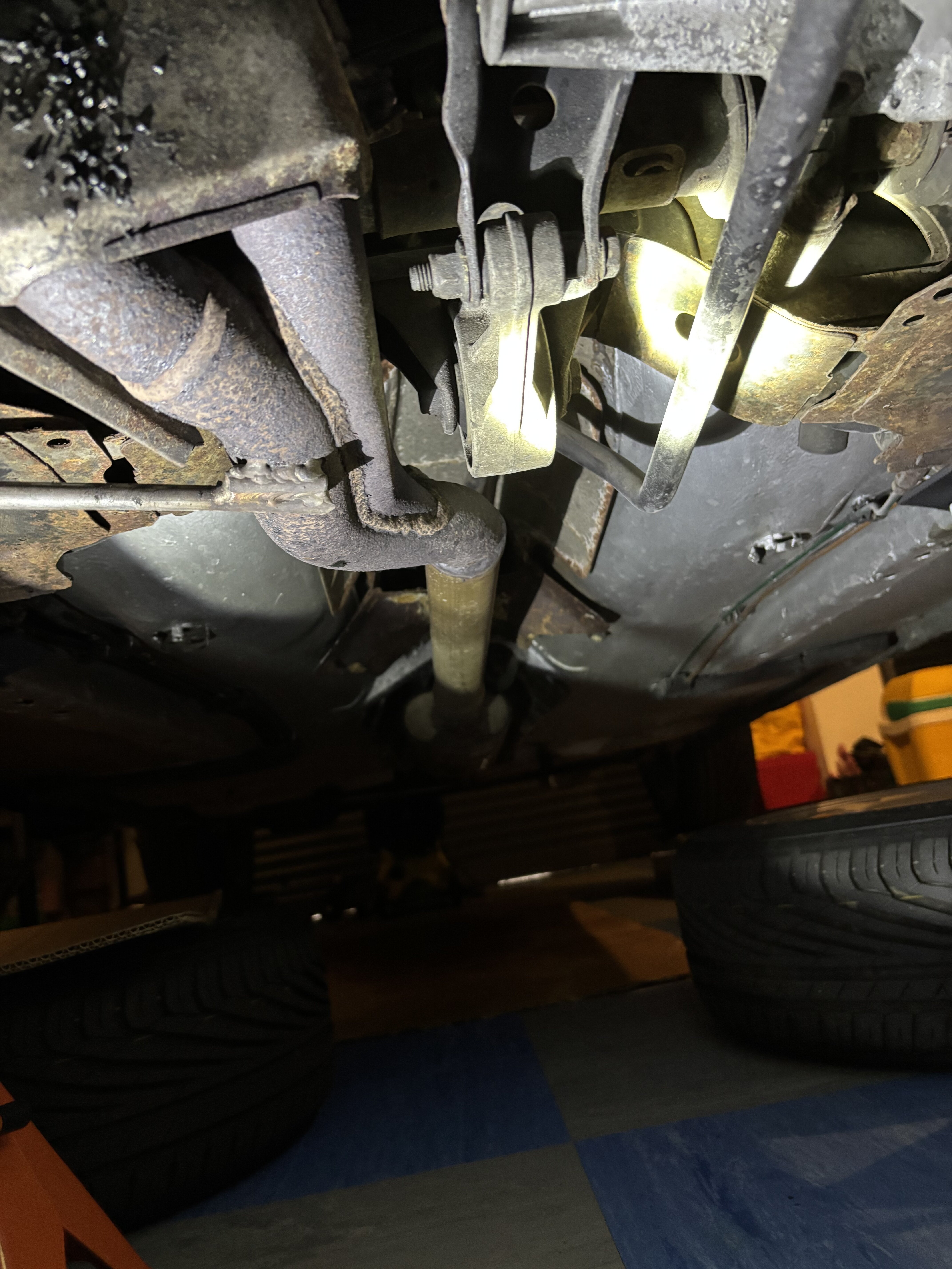

I am going to tackle this job for the first time with my Valver. I want to remove the front subframe leaving the engine in.
Can people list me the do’s and don’ts and the correct order in which I should disconnect whats required to remove it.
The more tips and experience you can share the better please. The Front bumper, bonnet, head lights are all off. Rad is ready to come out, ball joints loosened off ready to be pried out. I’m on to the important bit now and I don’t want to screw anything up with my lack of experience.
Any help would be much appreciated, I know this is basic stuff for a lot of you but I am a novice and don’t want to screw anything up. It appears that I need to-
Remove my exhaust as I cannot disconnect from a cat because it has been removed and a pipe welded straight through.
Undo the back gearbox mount. Is that as simple as just undo the bolts remove one and move it out the way?
Remove the gear selector bar, what’s the best way to do this? Have the gearbox engaged into 1st and then remove the bar altogether?

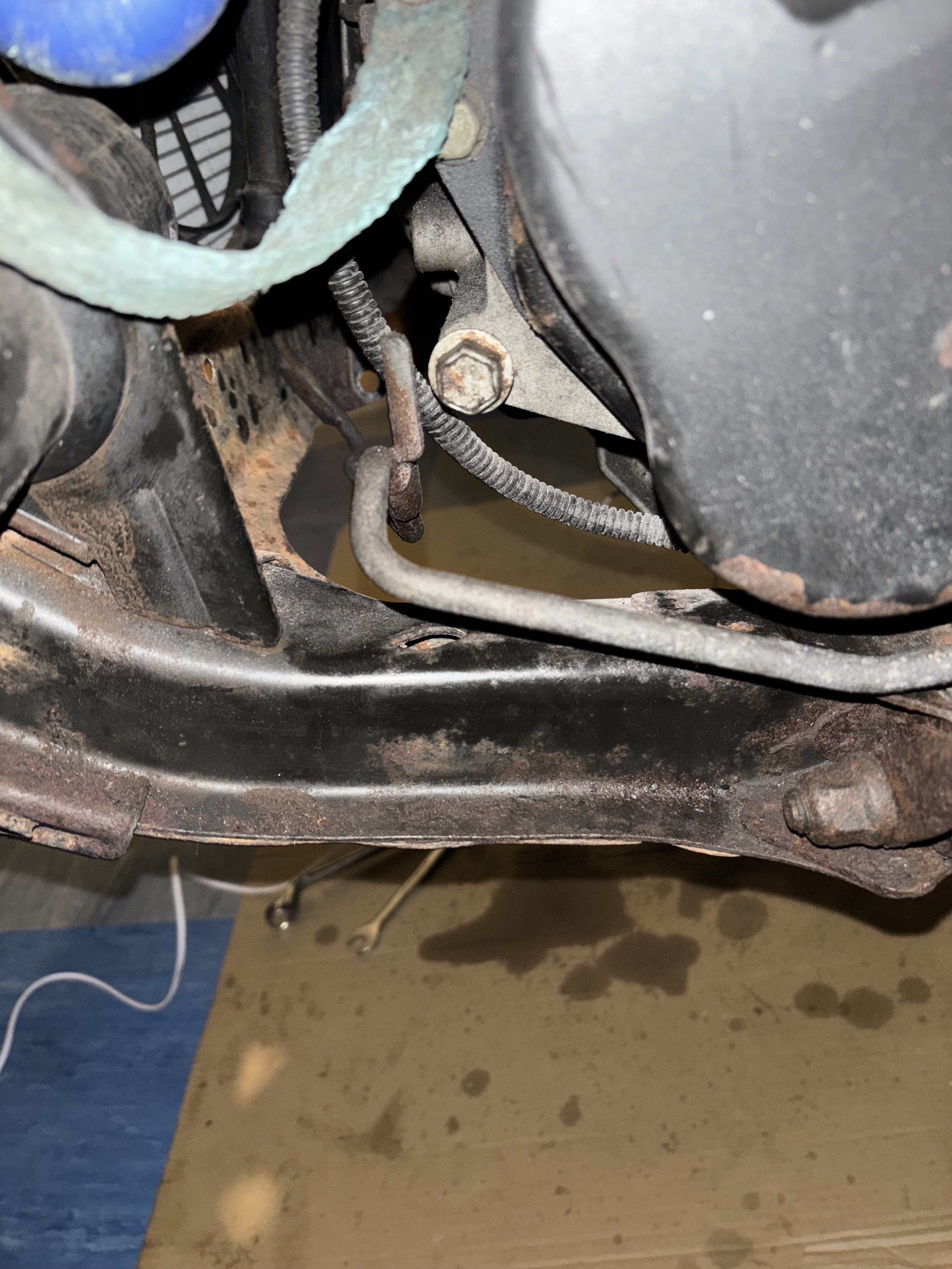

One of my anti roll bar bolts keeps is just spinning around on the wishbone mount, the other one loosened fine, you cannot grip it from the top, does that mean it needs to just be cut off now?
More stupid questions will come, I would appreciate any advice.

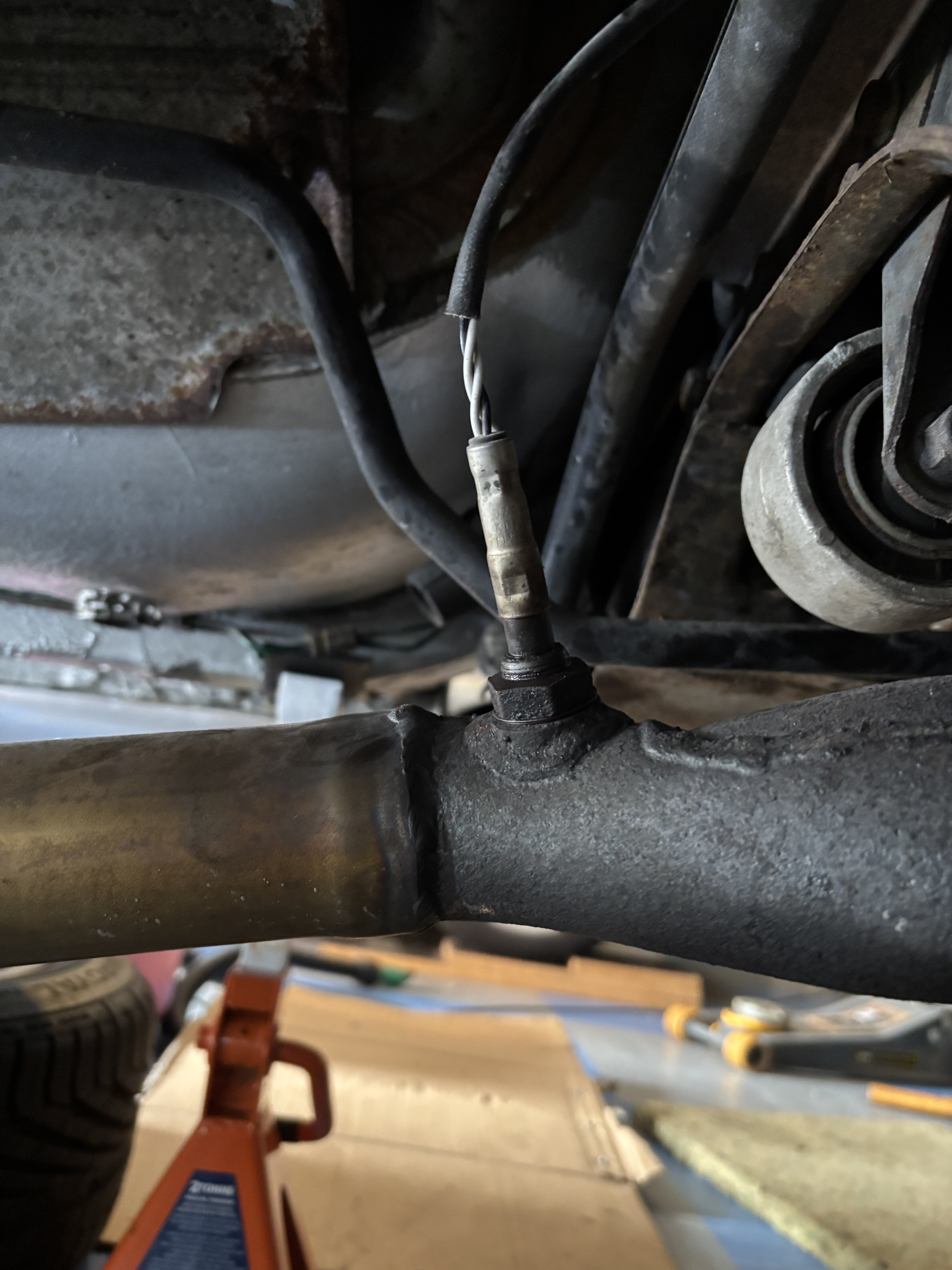

Images of exhaust and mount and the only bolt causing me an issue right now.

Right, with the selector remove it at the pivot point so that you won't have to f**k about adjusting it again to get the gears. Might be a rubber boot around it
You will need to remove the driveshaft to drop the downpipe too
The captive nuts on the rear of the subframe will be a right b**ch as they will more than likely be siezed so will need to get a spanner in there
I would just cut those drop links as they need replacing. A set of nut splitters are always handy to have, can just split the nut if you don't have access to something to cut the drop links with
There will be pas pipes attached to the subframe, on the pass side somewhere. Will need to decide if you are dropping the rack with the subframe? You will need to remove the bolt holding it to the column, is a bit trick and there is a boot covering it. diconnect the pipes to the pas bottle and pump
I have made them move but my god I don’t see how I’m going to get a spanner in there at all, or will it become accessible once the exhaust is out of the way?

Ok exhaust is nearly out. Is there a special way to take this sensor out without me doing damage? Is it just a 22mm spanner and more WD40 or am I wrong?
You could also just drop the hubs/wishbones and even the shocks with the subframe then remove the bits after. Just remove the calipers from the hubs

Thanks for clearing up that I can just unplug the sensor and leave it in, silly me (Inexperience).

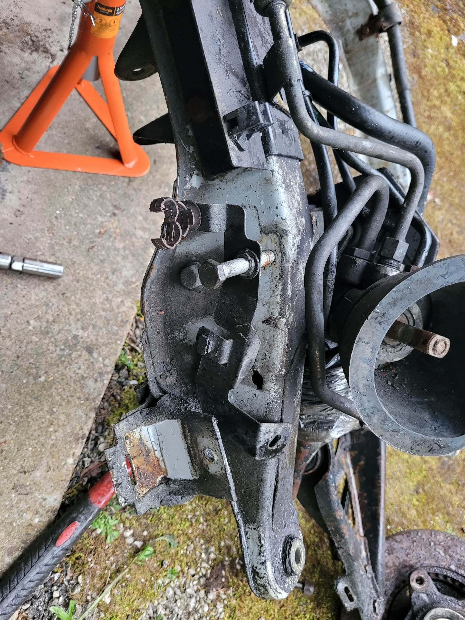

The sub frame bolt next to the fuel lines looks impossible to get a grip on the inner nut, is it a captive one anyway? How am I going to cut those off If they don’t come off?

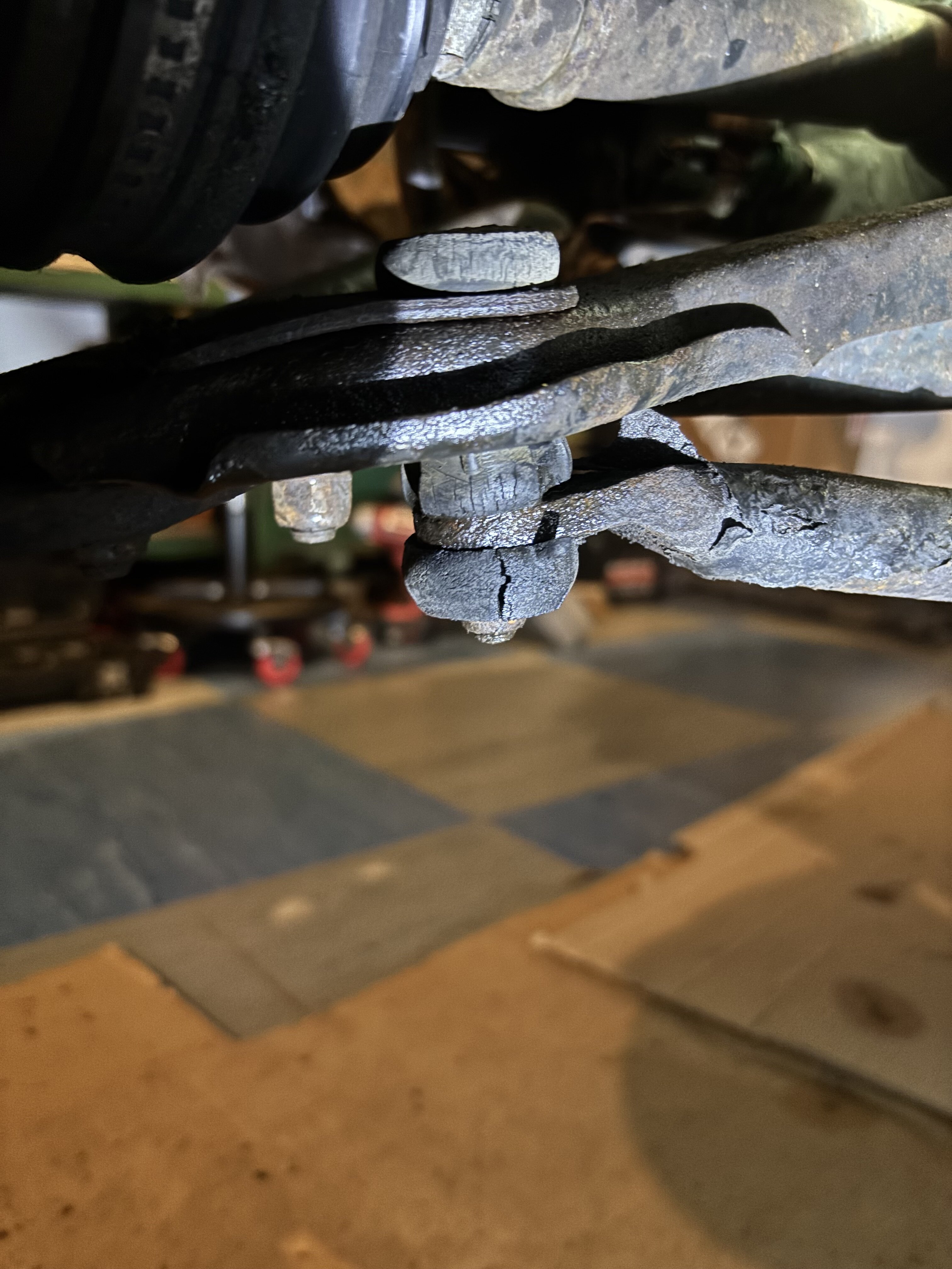

This is great advice cheers! I have undone the track rod ends bolts but couldn’t get the track rod end out of the hub, even after I lifted the hub slightly with the jack. God I spend so much time f**king about with stuff where an experienced mechanic just smashes this out for fun! I get afraid to hit stuff hard enough or worry about if any load is on annything and I damage something or myself😂! I decided that removing the ball joints from the hub first would be best to release the stiffness of the track rod ends joints but I only have a 16mm socket (the other crap old one I had rounded) and I don’t have a 16mm spanner so couldn’t continue with removing the ball joints today. Plus I am going to get a ball joints separator. I will get the tools this week though and then -
Remove ball joints from the hub
Remove track rod ends from the hub

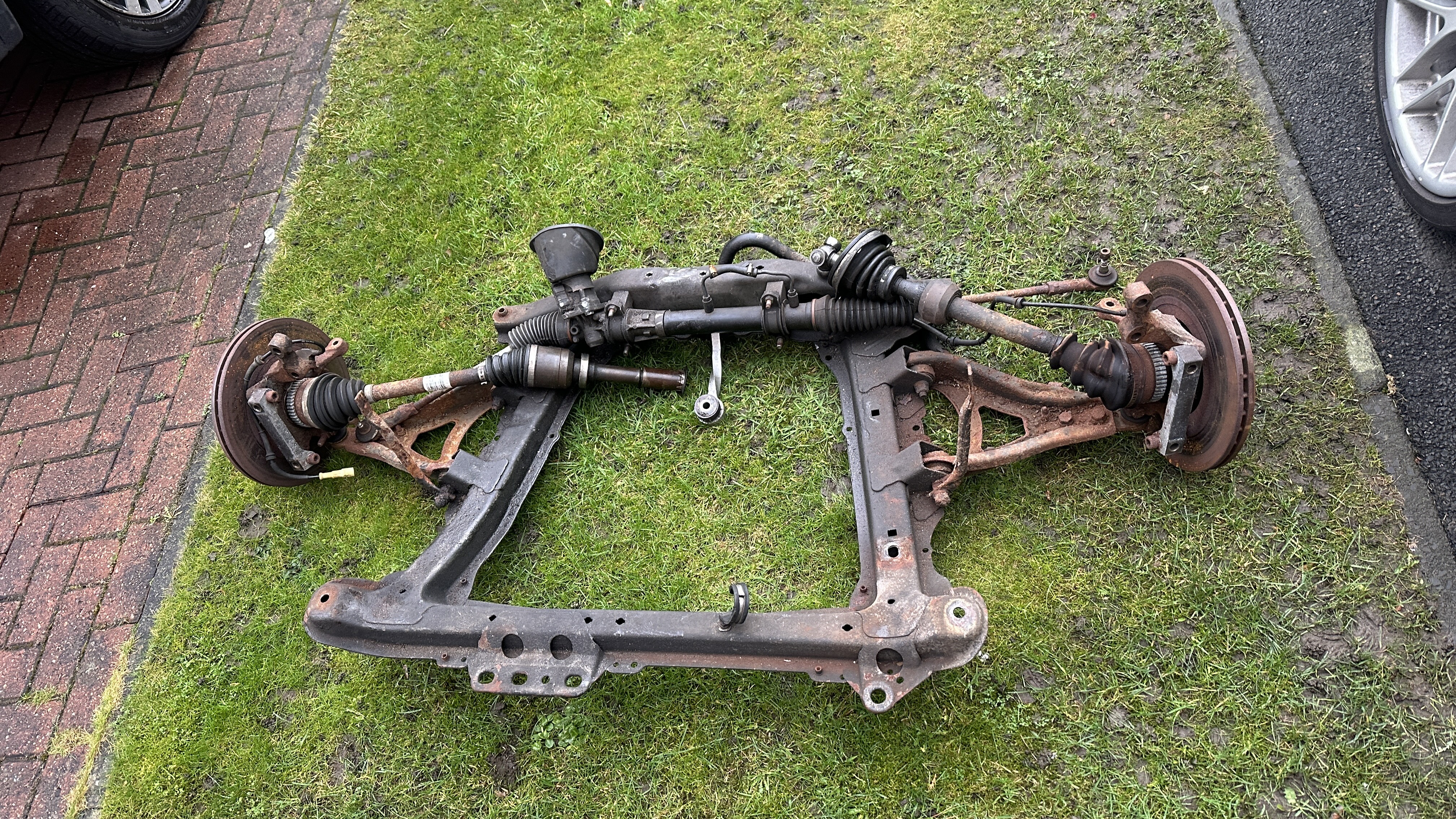

Why didn't you just unbolt the track rods from the hubs, take the 4 bolts off of the balljoints and then take the bolt out of the rack and column?
You could have left the shafts and hubs in the car
It takes me about 30 mins to get the subframe dropped out of my car now. It's a terrible curse to have knowing exactly which bolts to take out to make it quick

Ah sorry, didn't realise it was Steve being a special t**t and dropping the hubs and shafts. It all depends if you've got PAS or if you've looped your steering rack/got a manual rack
If you've got a proper blokes rack with no stupid hoses it's a piece of piss

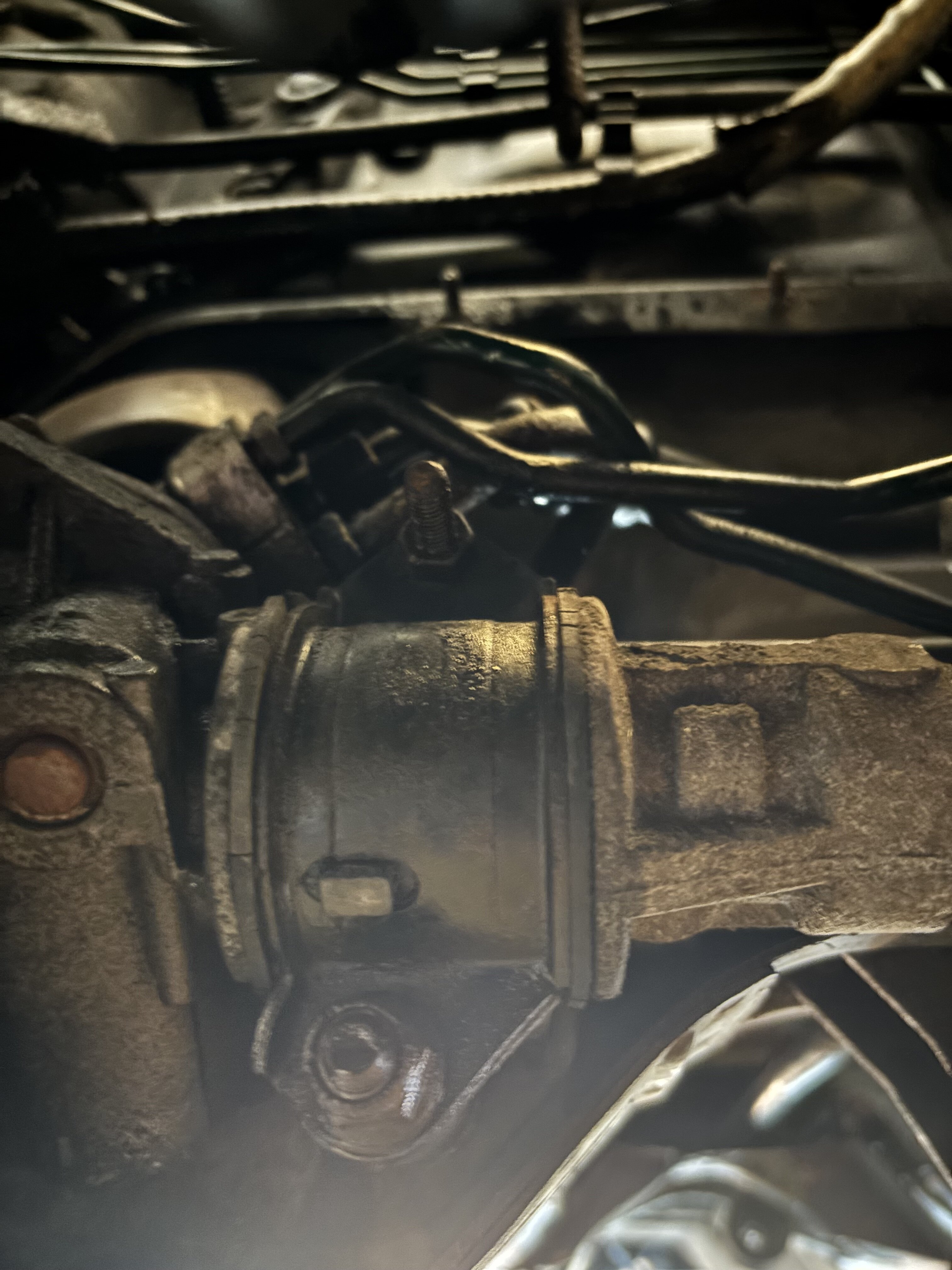

s**t that is a lot of pipes going into this power steering pump. Am I disconnecting all these awkwardly with a spanner and then I can disconnect the steering rack bolt? I can drop this frame then.

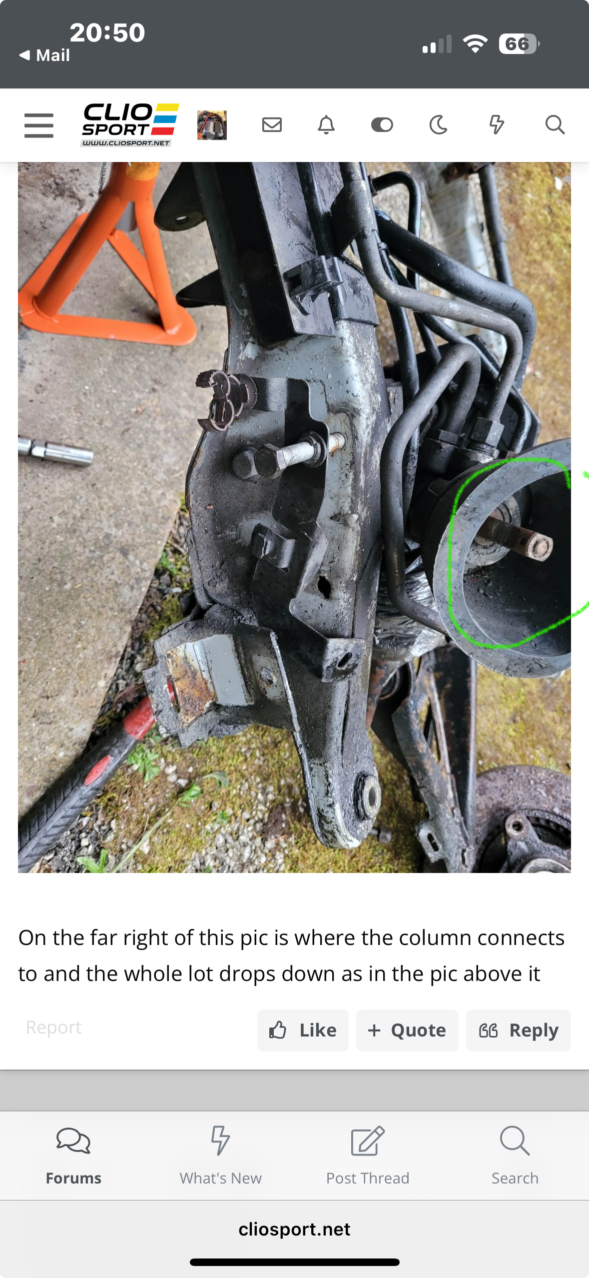

No need to touch any of those, on the bendy joint at the bottom of the steering column, on 1 side of it is a 13mm nut, undo that, pop the bolt out and it's disconnected from the rack
On the far right of this pic is where the column connects to and the whole lot drops down as in the pic above it
Thanks for your help. So am I disconnecting a 13 mm nut from the shaft I have circled in green? Where’s the fluid going to drain from? Sorry if this sounds stupid but I have never done this before.

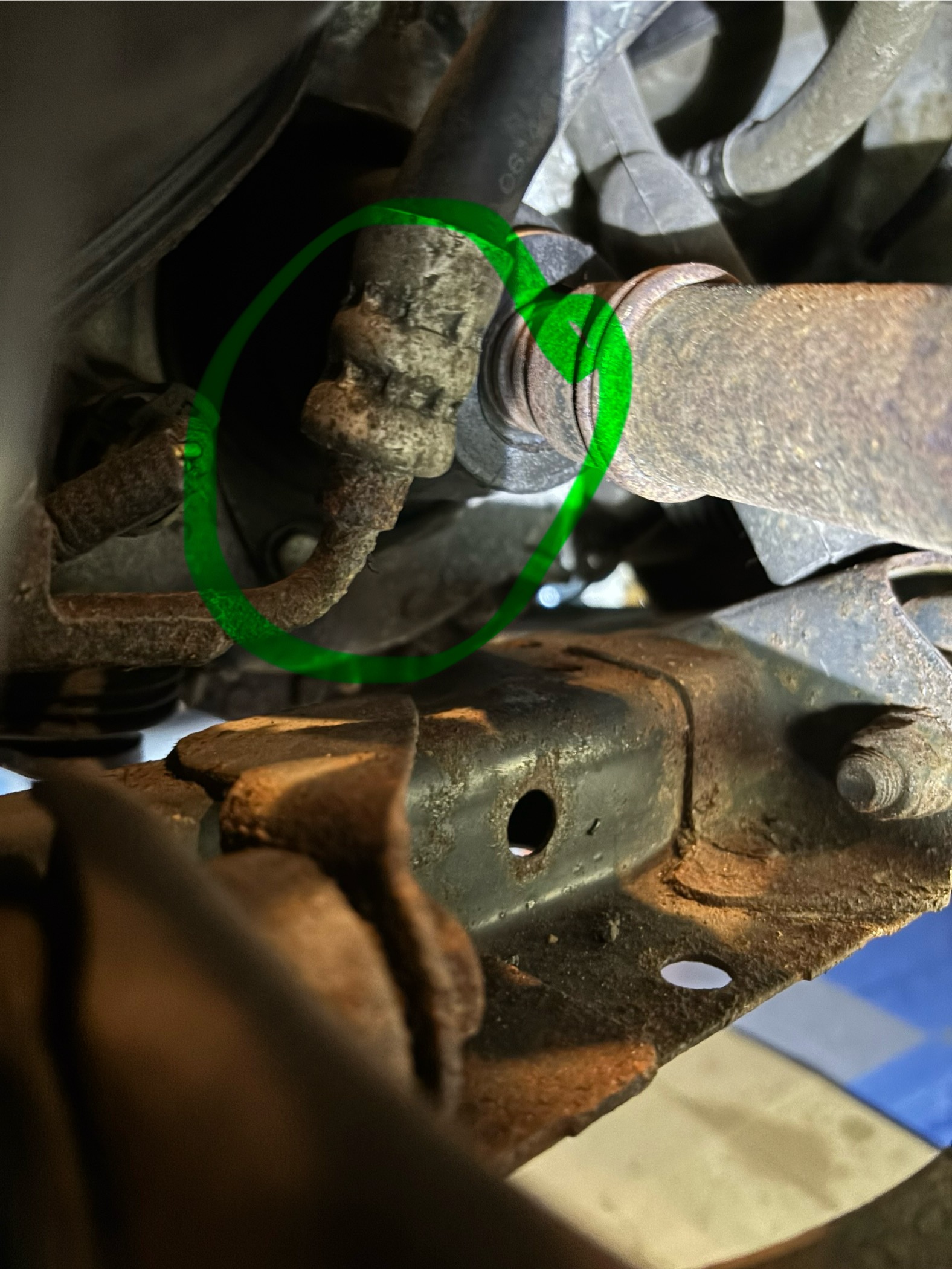

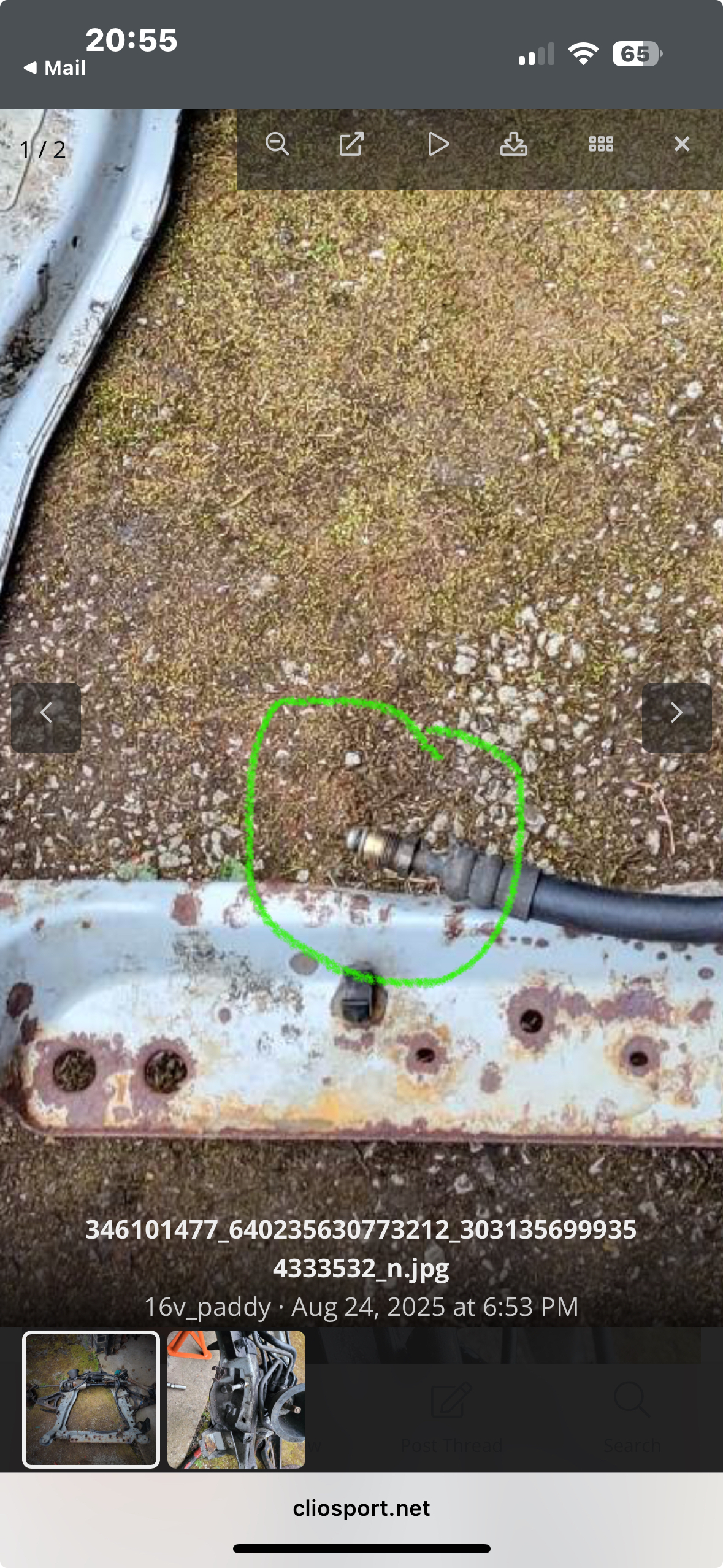

This looks like the answer to how I dump the fluid. Is that right?

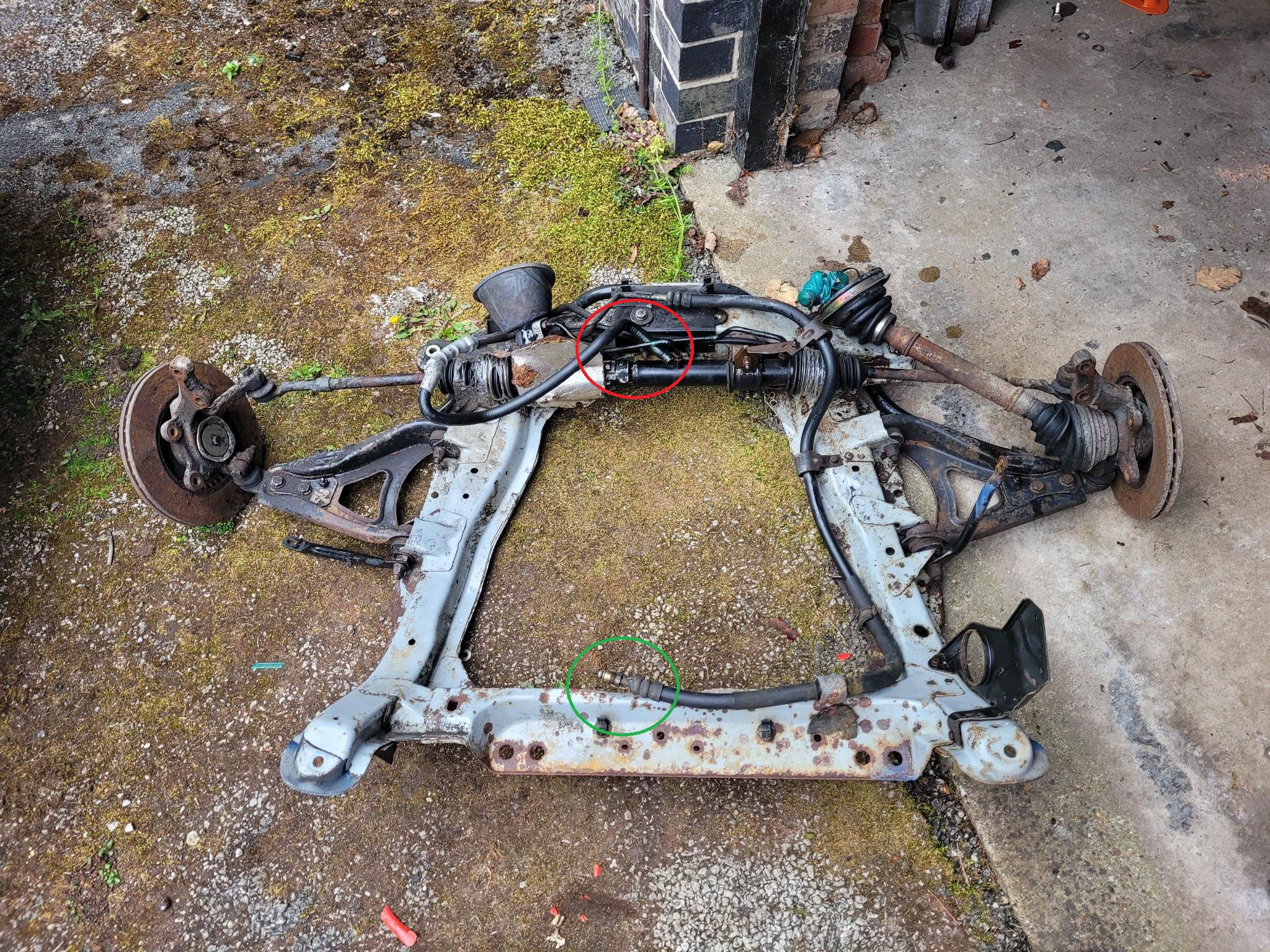

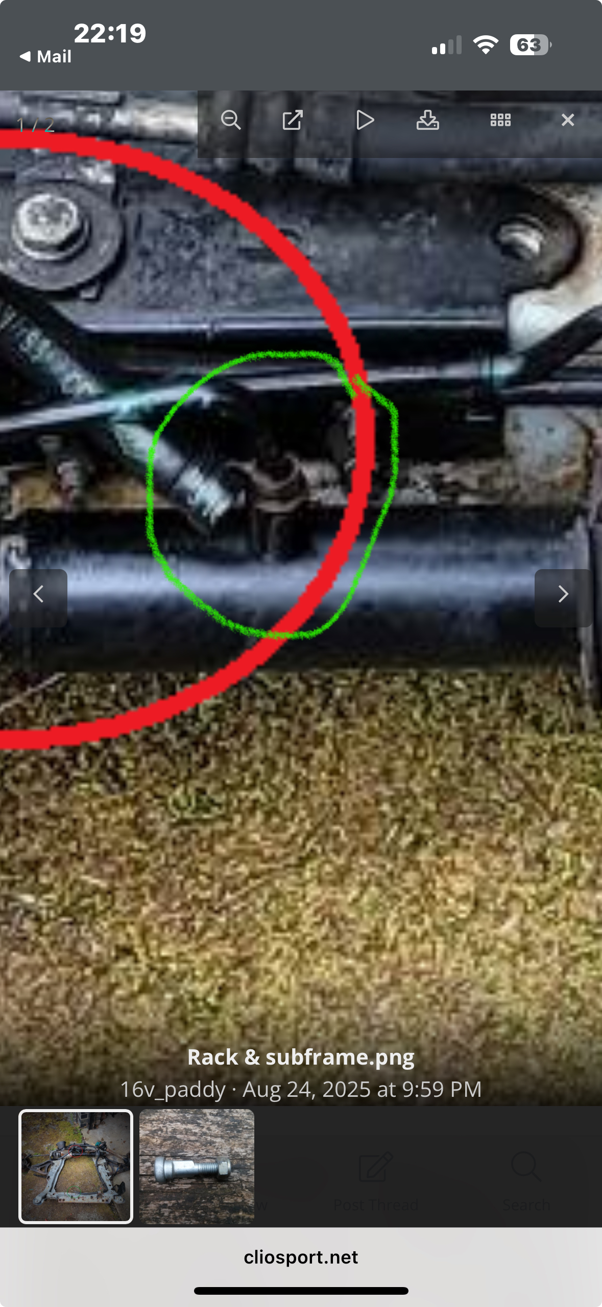

The pipe circled in red goes to the power steering fluid reservoir and the 1 in green connects to the pump

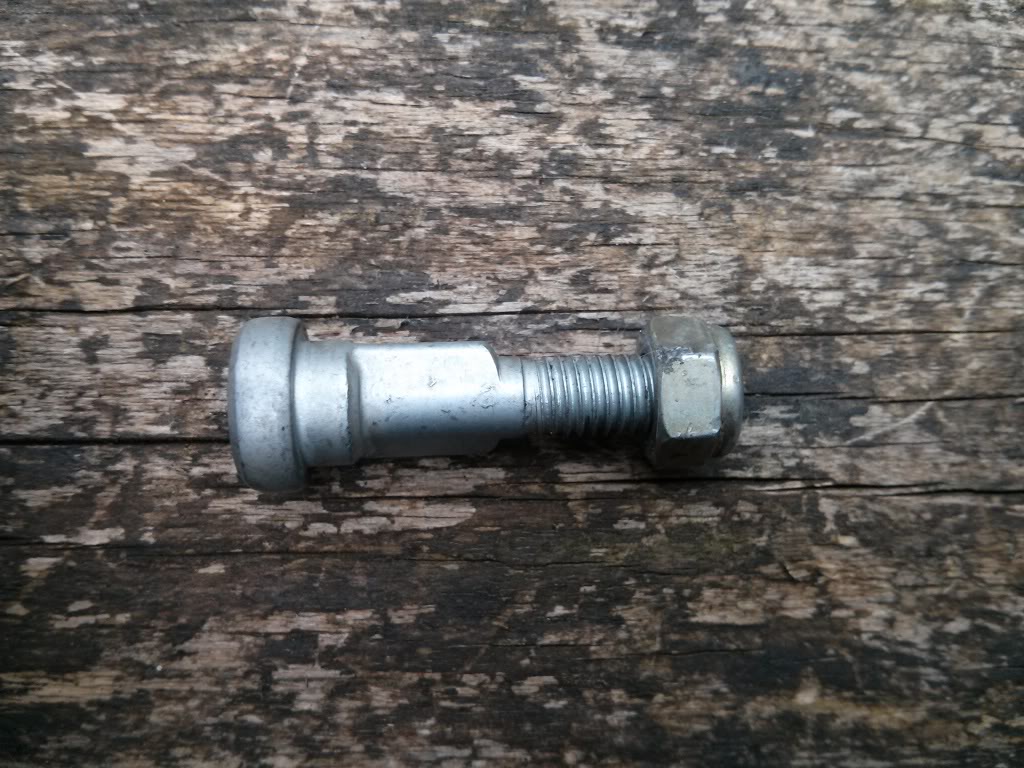

The nut & bolt that connects the column & rack looks like this and it goes on the shaft you circled in green

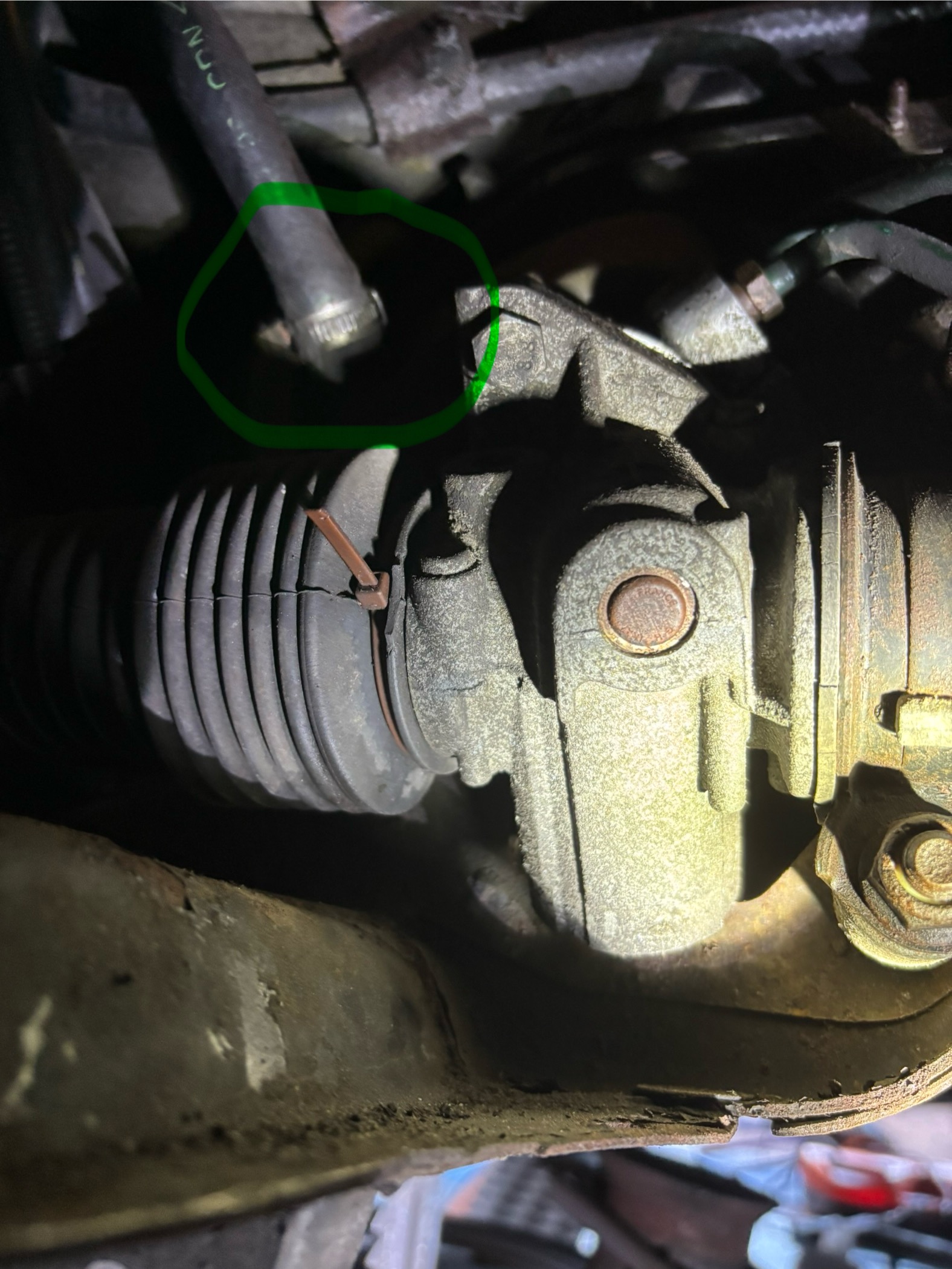

So I need to disconnect from the pump at the front of the subframe and this in the pic. Thanks for explaining the rack bolt 👍
Yep (y)
Unfortunately getting the fluid out is going to piss out all over the place & make a mess no matter what you do so use some cardboard & plenty of rags to soak up the worst of it

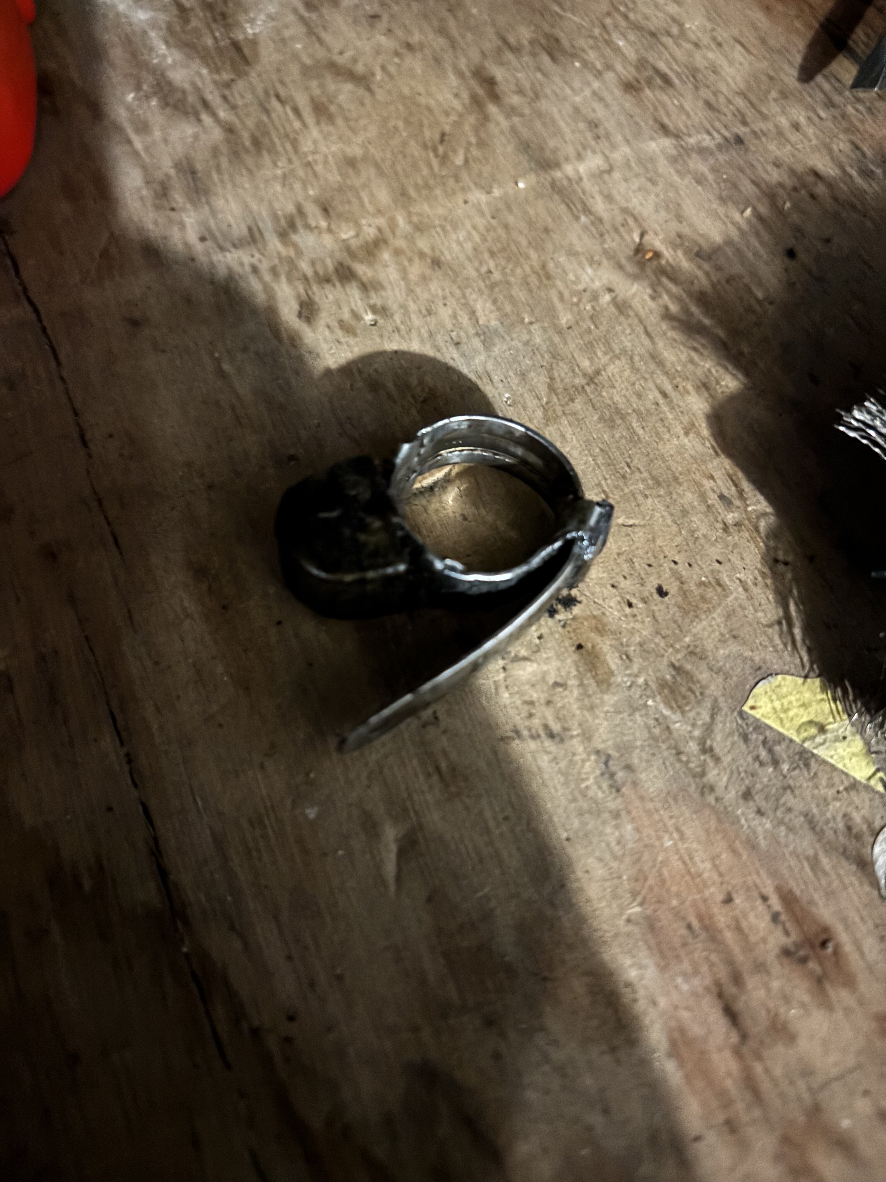

Ok so a typical non productive hour again from me today. How do I detach this power steering pipe. Mine looks a bit different and is routed in between the front of the engine in between the radiator fan and the engine and there is hard piping around the gearbox and again above the rack. Either way, how do I disconnect these things? Also is it the jubilee style clip type what I need to disconnect from the the reservoir that goes down to the rack, at the rack end see what I have circled in the pic. Also do I need special pliers to get that clip off? And which section of the flexi pipe do I need to disconnect and how do I disconnect them? They don’t appear to have a spanner fitment?
I found the coupler behind the top of the rad to disconnect the power steering. I could not figure the removal of these weird jubilee clips but I managed to tease it off the rack and catch all the fluid coming out on the actual rack end.

For the column rack bolt. Am I best to get this 13mm nut off the rack from the inside of the car, it is a bloody nightmare to get to with that rubber boot obstructing the view of anything. Plus there is no space, I don’t know how I will get that bolt back in, if I get it out!
Taking me bloody ages this 🤦‍♂️and this is just dismantling and not building back up!
Got that steering rack bolt out, went in through the side with arm through the wheel arch and also could get the bolt out the back inbetween the back of the subframe and the anti roll bar. That will be the best place to slide it back in. I am not looking forward to getting that back in.
Anyway I am just having to drop the subframe now, thank f**k. Well finally remove that linkage bolt and then carefully do it. However I have that one subframe bolt and the back that is not loosening and the nut is not being gripped by my 19mm spanner. The other side at the back is coming off and lowering the subframe slightly. So I think I am good with that one.
So what do you do when this bolt won’t come out? I don’t know if it is my spanner that isn’t getting the angle to grip the nut right or where do you cut it or do you get a long cold chisel and try and crack off the nut in the subframe to break it off? That nut and the bolt are starting to ‘dissolve’ as you say.
Thanks again to everyone who has helped with this.
Worse case scenario is you have to get jiggy with a grinder and just chop the bolt
