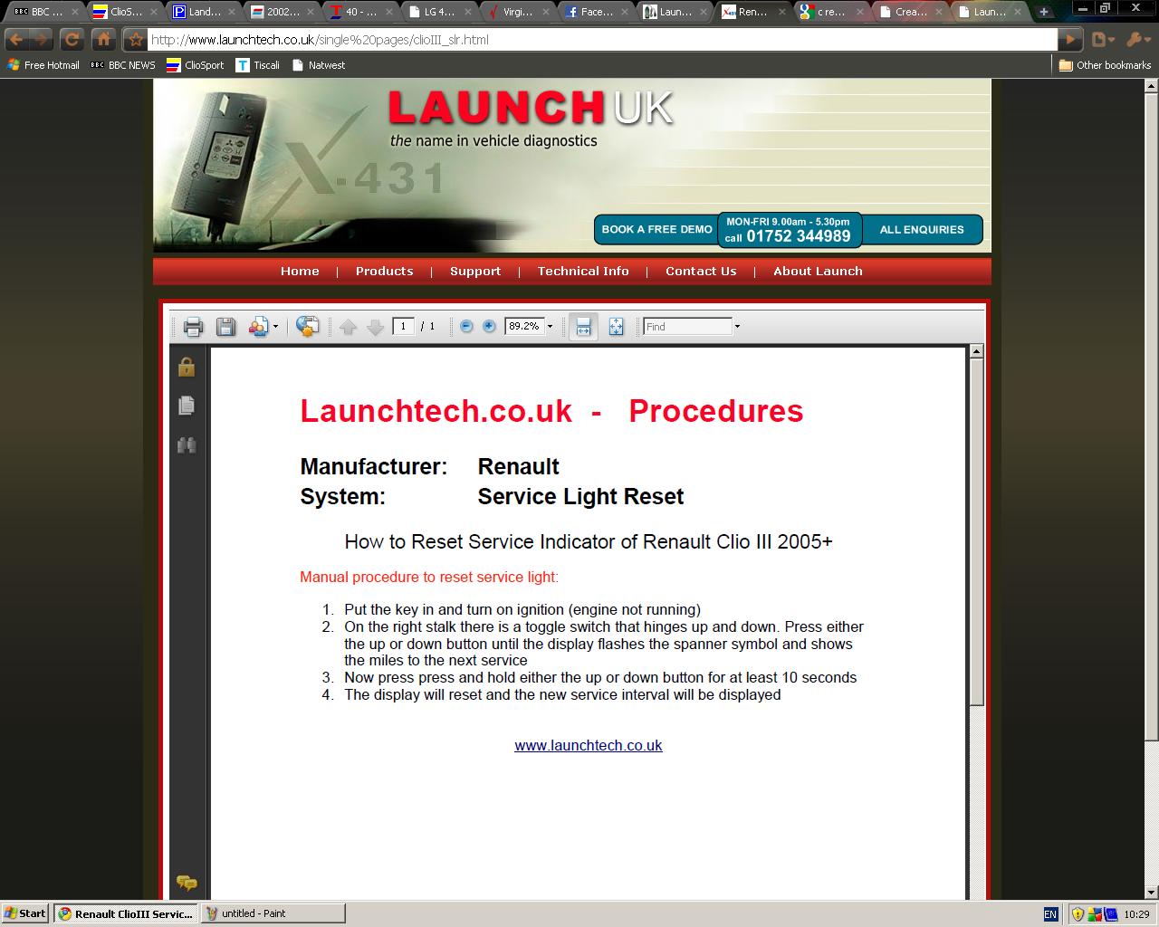

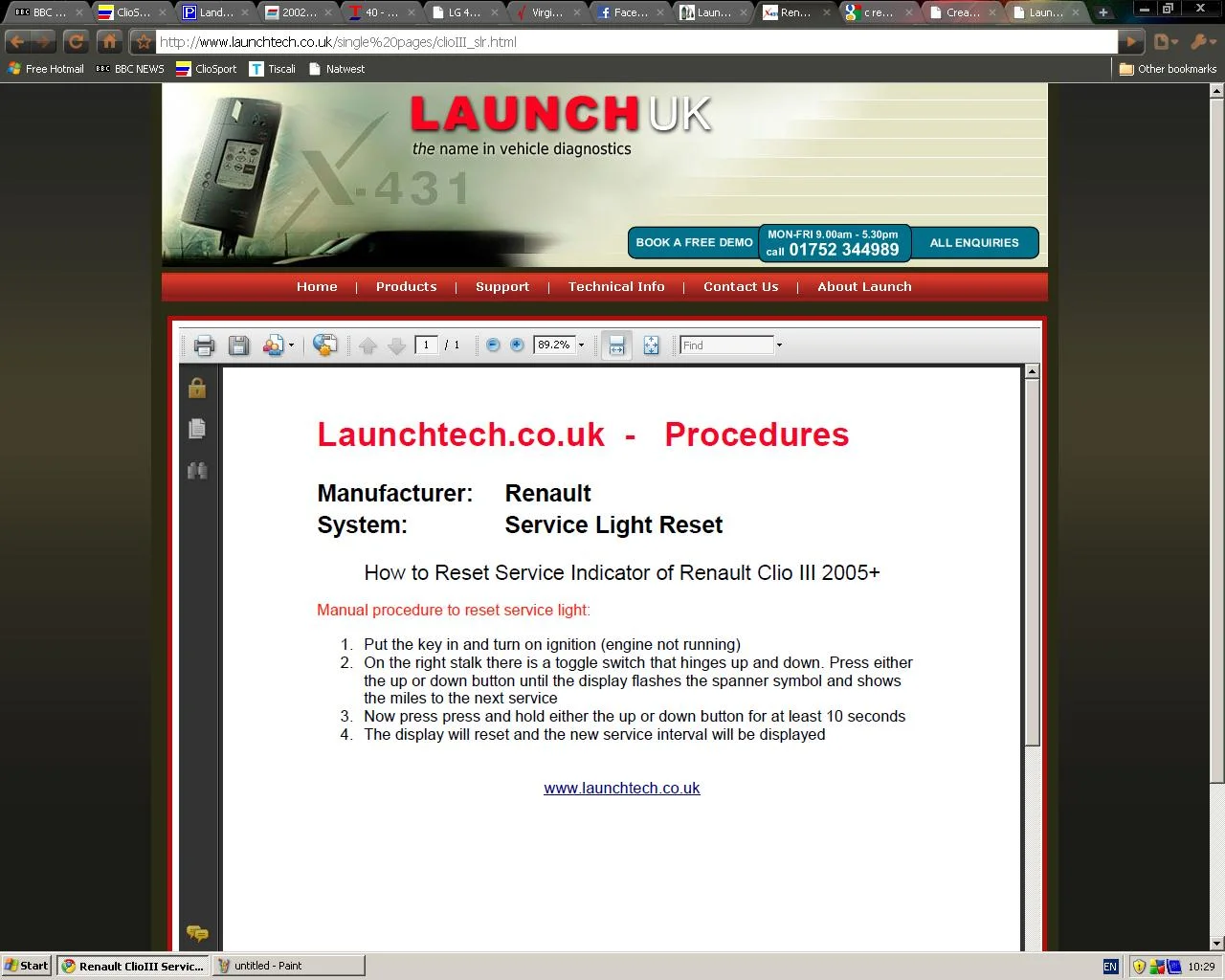

Was digging around on LaunchUK's website and found a little guide on reseting the service icon on a Mk 3.....I own a Mk 2 so is no use to me but if someone wants to give it a go.......!?!
