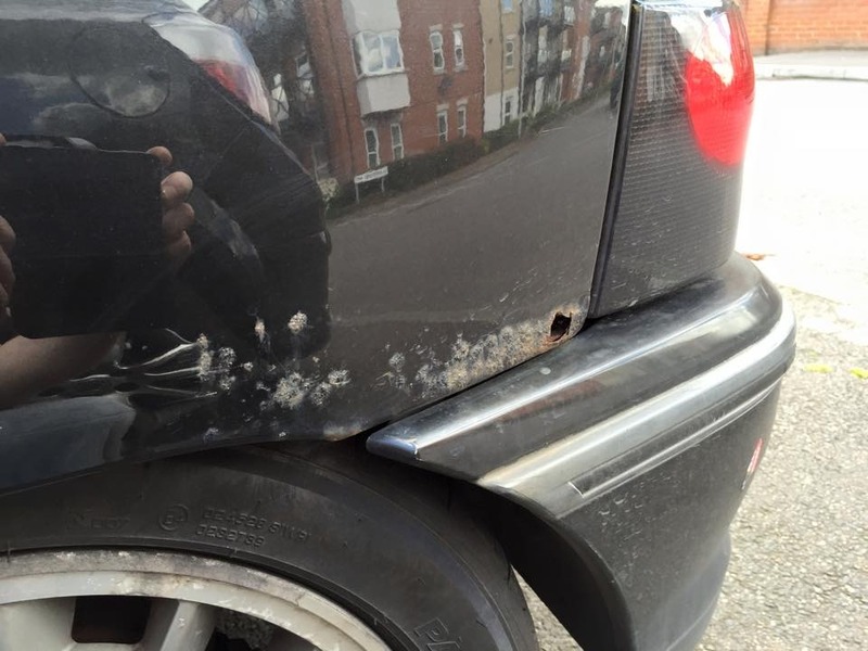

The car does have other issues, the rear of the sills are rusty (new ones came with the car) one arch is rusty, the other arch has a dent and its just generally untidy, however as it was cheap at £1k with all the nice bits on it it didn't bother me as the absolute worse case scenario would be to sell of all the parts and be in profit.

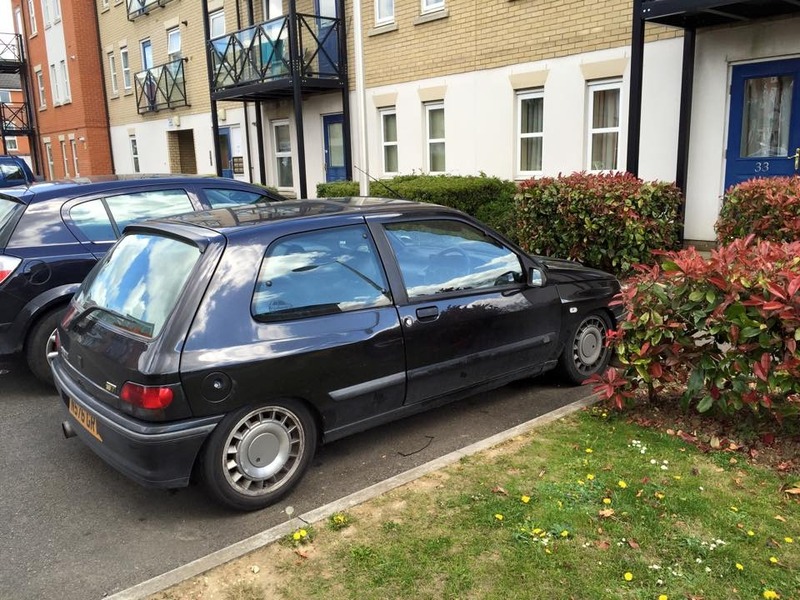

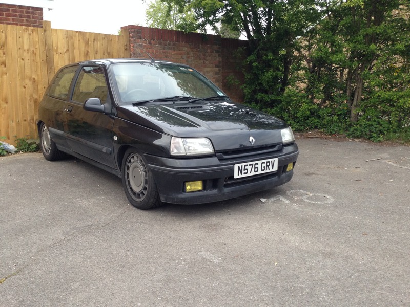

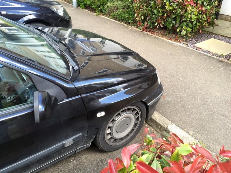

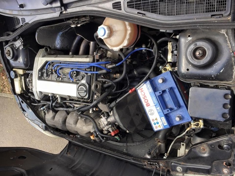

These are the sellers pics

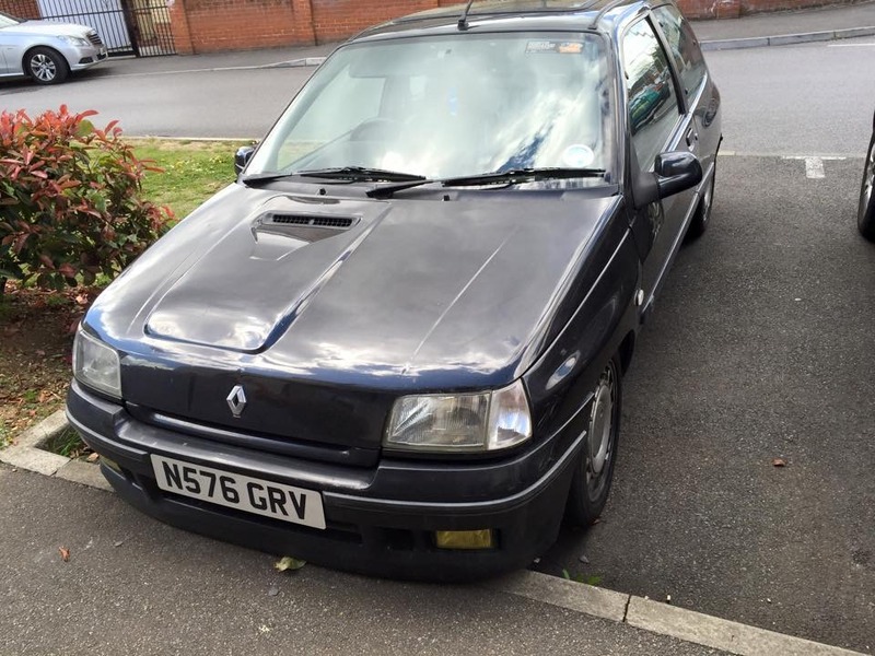

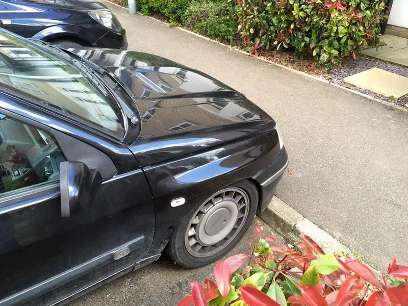

This is the only pic i took on Friday when it got delivered

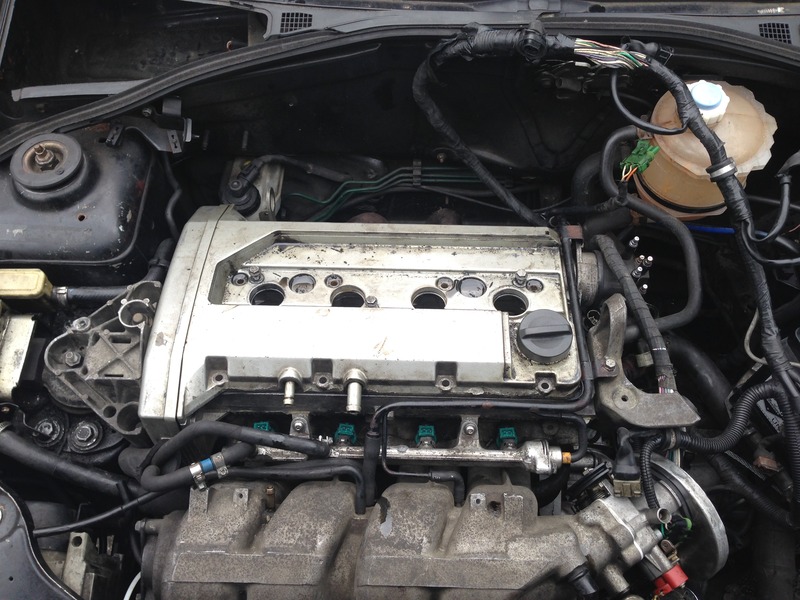

But you know whats like when you get stuck in -

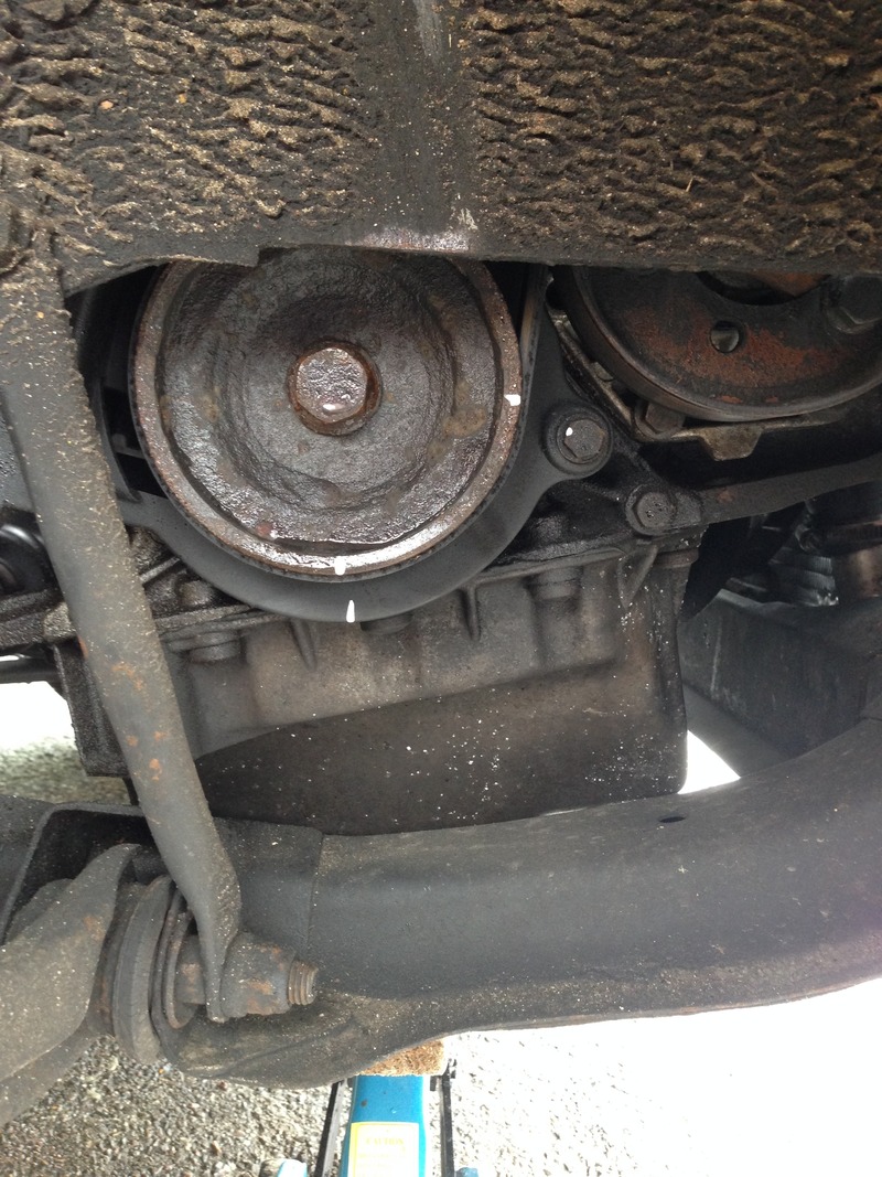

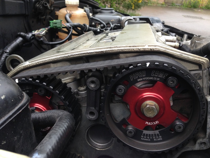

I was going to line up to TDC but i was trying to avoid taking the lower pulley off and the plastics so i just marked it where it is and ill use these marks when i put the belt back on

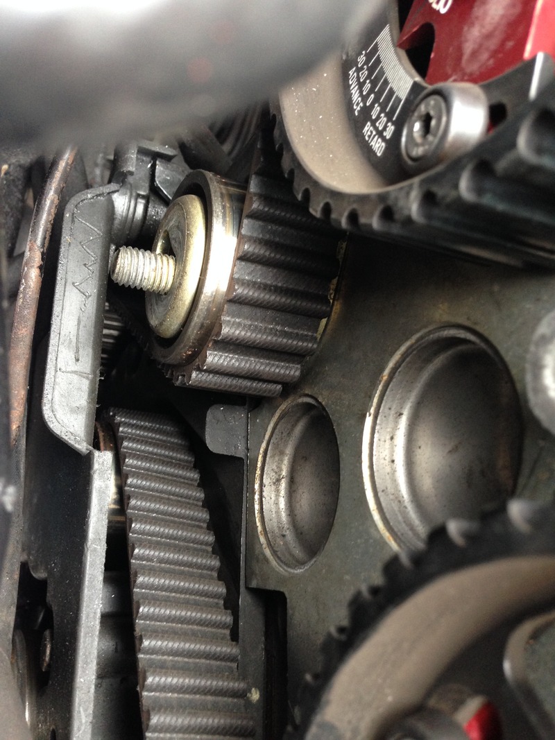

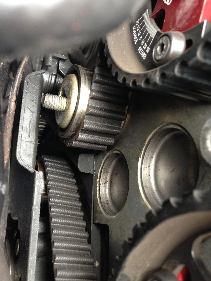

And then off with the teniosnor (can someone help me with this, it was on its loosest setting before i even undone it, its very tight, going to be an absolute nightmare to get the belt on as there is no useable adjustment on it, is there a better one to buy?)

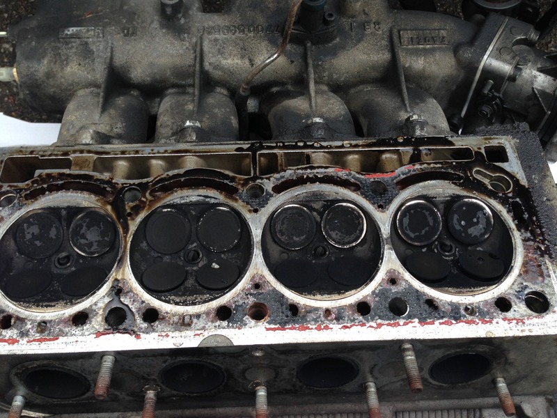

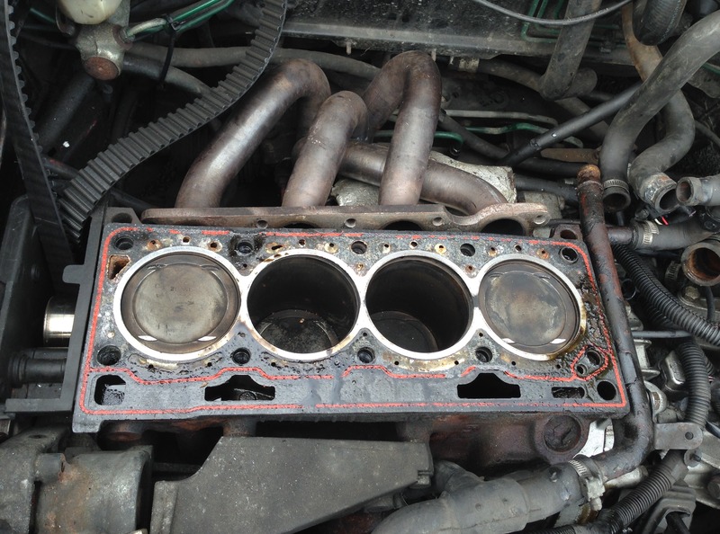

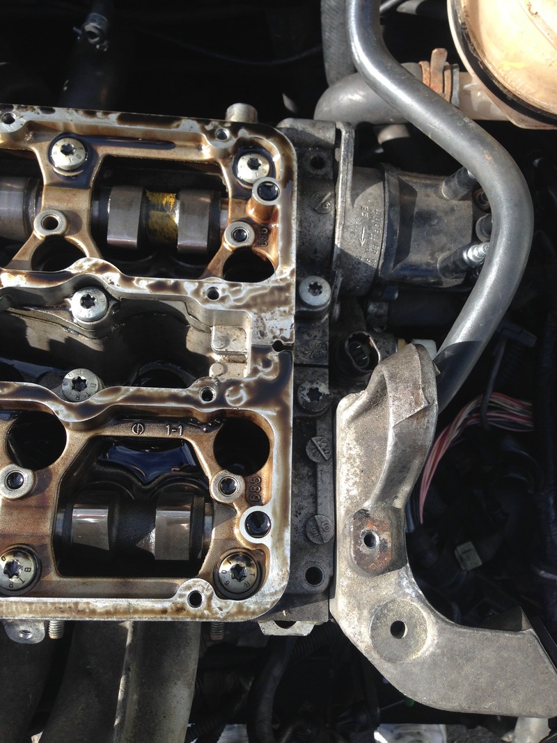

And then off with the head, as you can see the gasket has gone between 3 and 4 and is starting to go in between 2 and 3 (i can only assume the seller was mistaken when he remembered the compression test showing 2 and 3 low, although i am now wishing that i tested it myself and also wet tested the cylinders, but the bores look good enough)

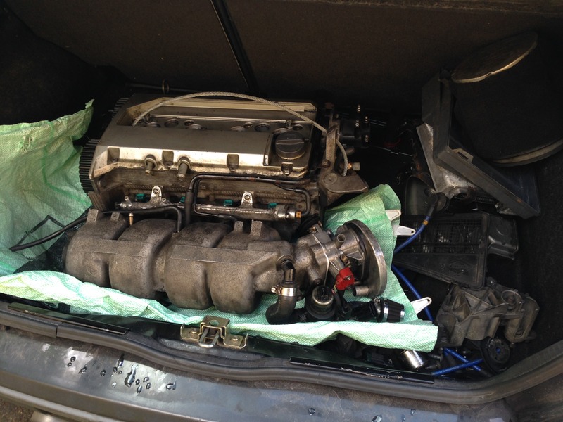

And now a boot full
