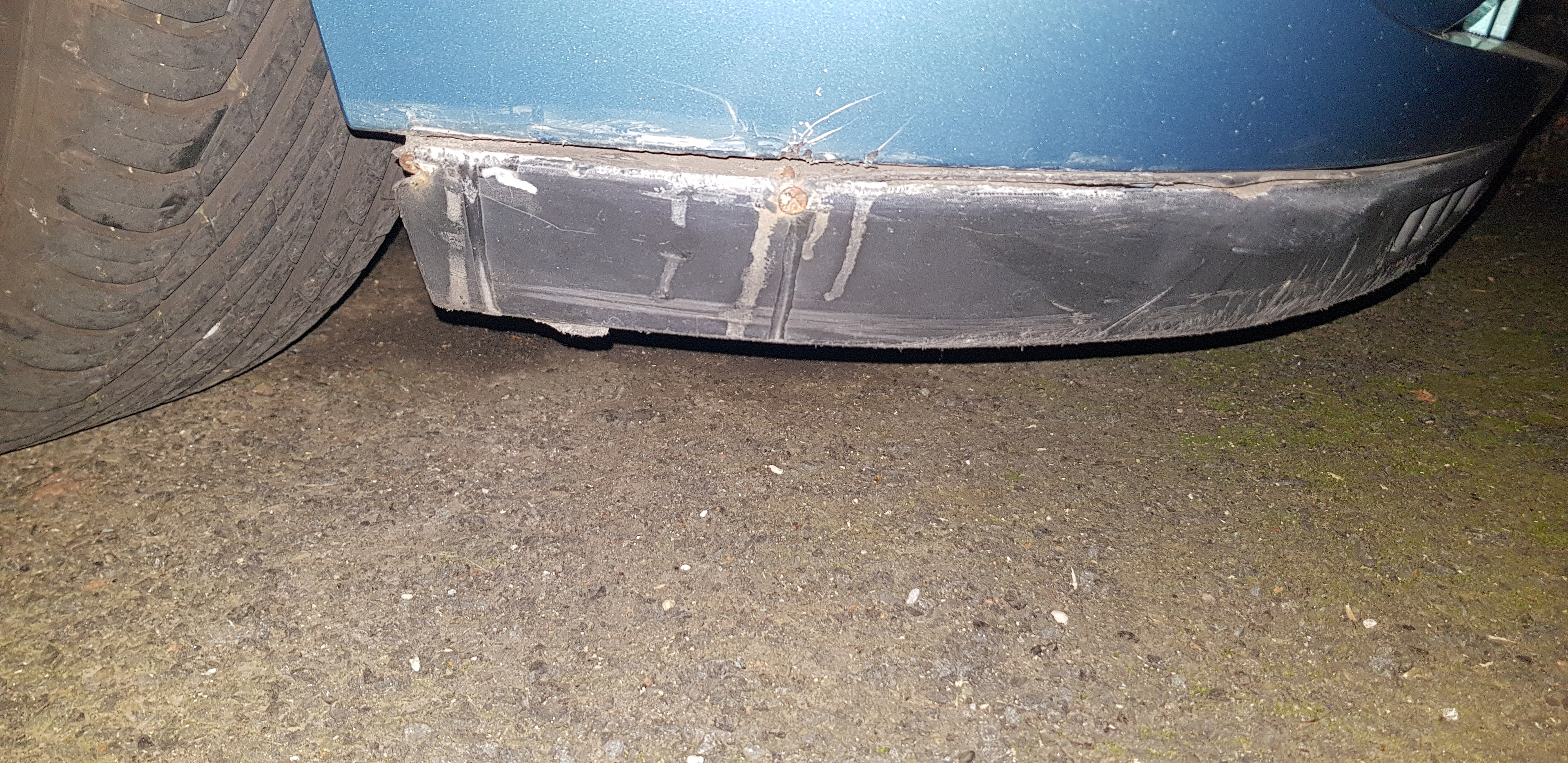

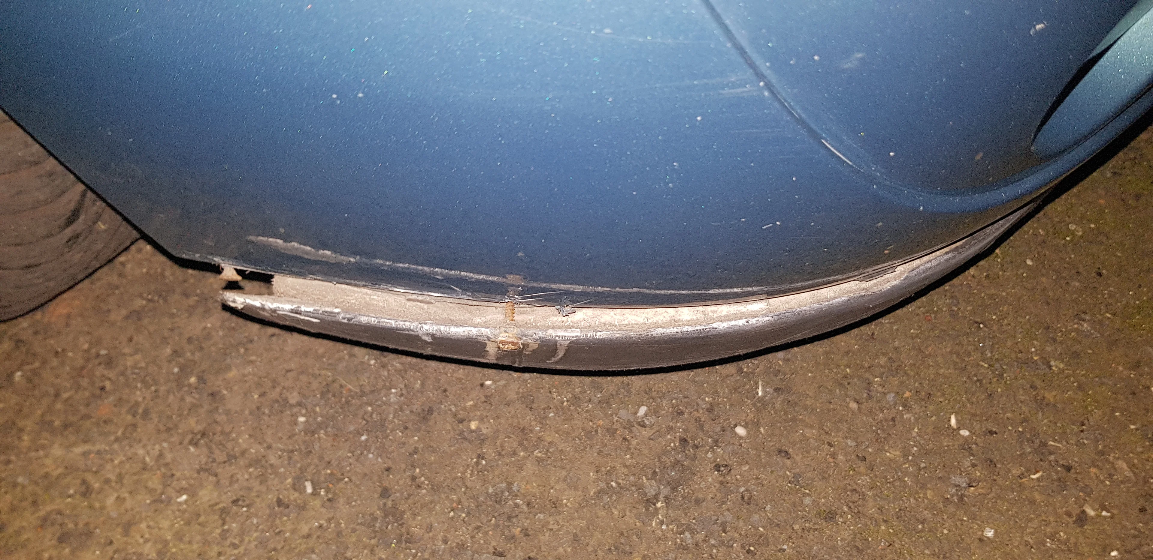

Ive got a Mk2 clio 53 plate. When I bought the car in Feb last year, the lower bumper trim was damaged and has been badly repaired. every now and again the edge pops out which has annoyed me since buying the car. A guy I know is scrapping his clio at the end of the month so I was wondering if I can change this piece or do I have to buy another bumper?
Some pictures so you know what im talking about.

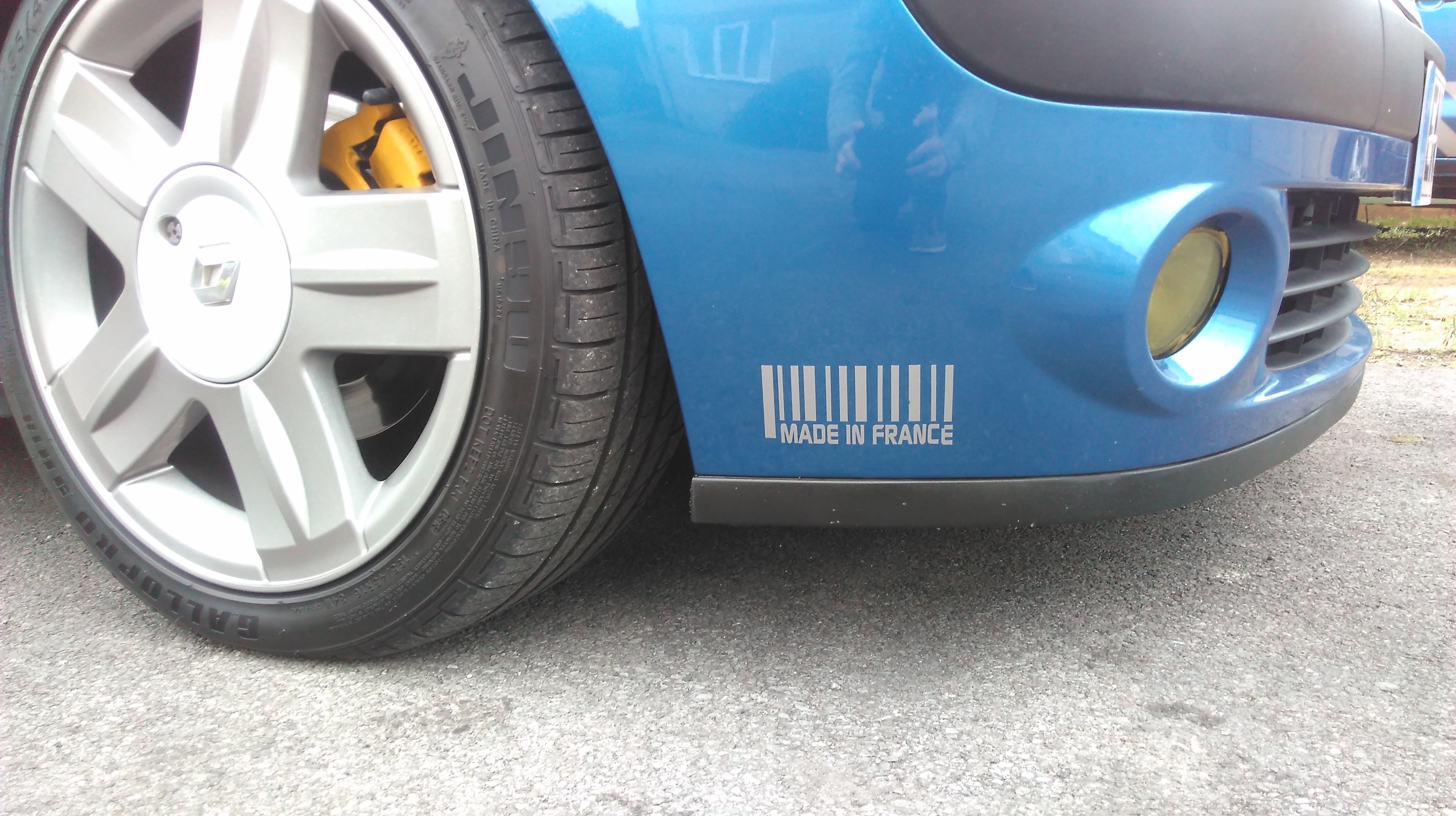

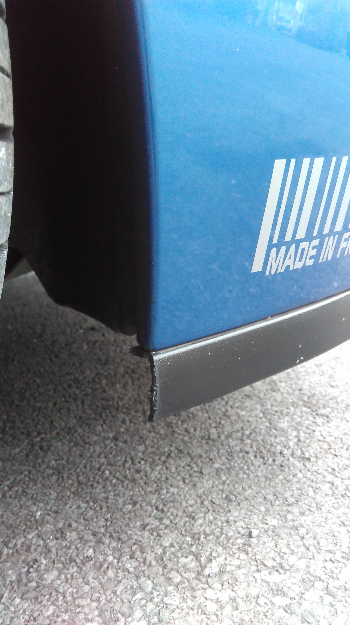

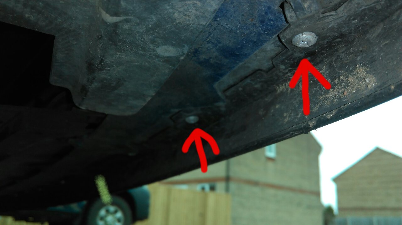

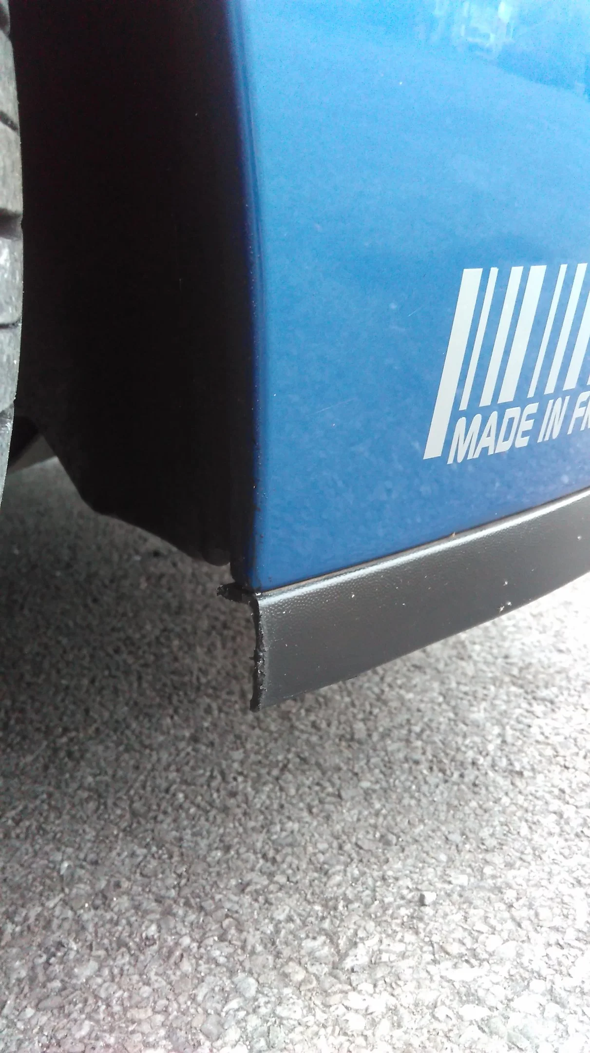

Most people would go for Fabia splitter, there marked in the centre so start there screwing it in with some 1" self tappers then you trim the ends as they are a bit longer, door trims are easy , on the inside of the door there's a round plastic grommet pop it out and with a screwdriver push to the rear of car , can get some photos later if needed I've done both of these

Sorry for the late reply, haven't been on my laptop. I have heardthat a Fabia splitter fits. If you could send me some photos that'll be great!
  Clio MK2 ph3 1.6
Just grabbed some photos for you
