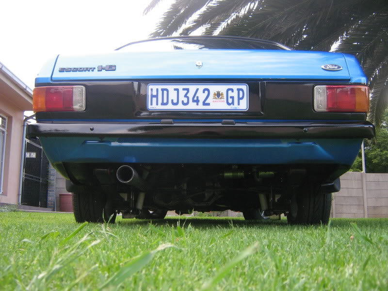

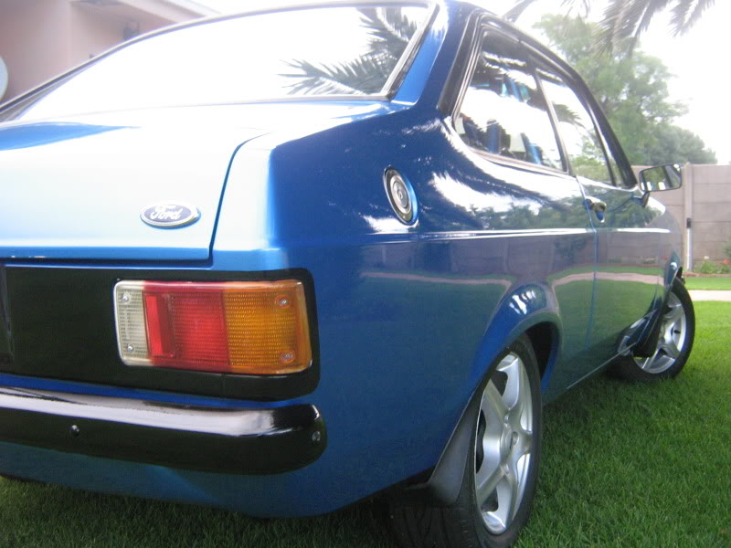

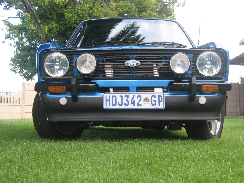

Mk2 Ford Escort Turbo
  Ford Escort Mk2

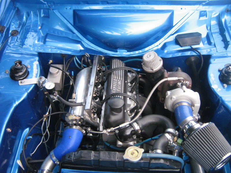

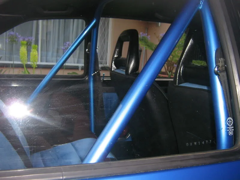

Specs is: 1,7l xflow motor, home made fuel injection intake, Dicktator management, T3-2 turbo, home made turbo branch, 5spd sapphire gearbox and std diff.
The power was 167Bhp and 219Nm@ wheels on 1,2bar(17,4psi). But compression on cyl nr was bad compared to the others. Motor is out again and im aiming for 200hp from the xflow.
Her name is Tin Lizzie
Hope you guys like her

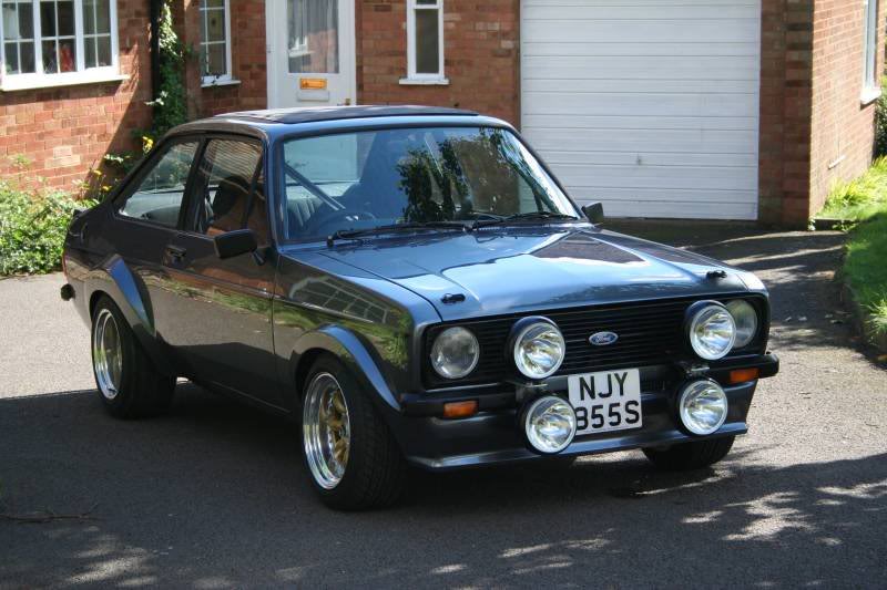

As said though needs some original old skool wheels to set it off.
Something like these.
