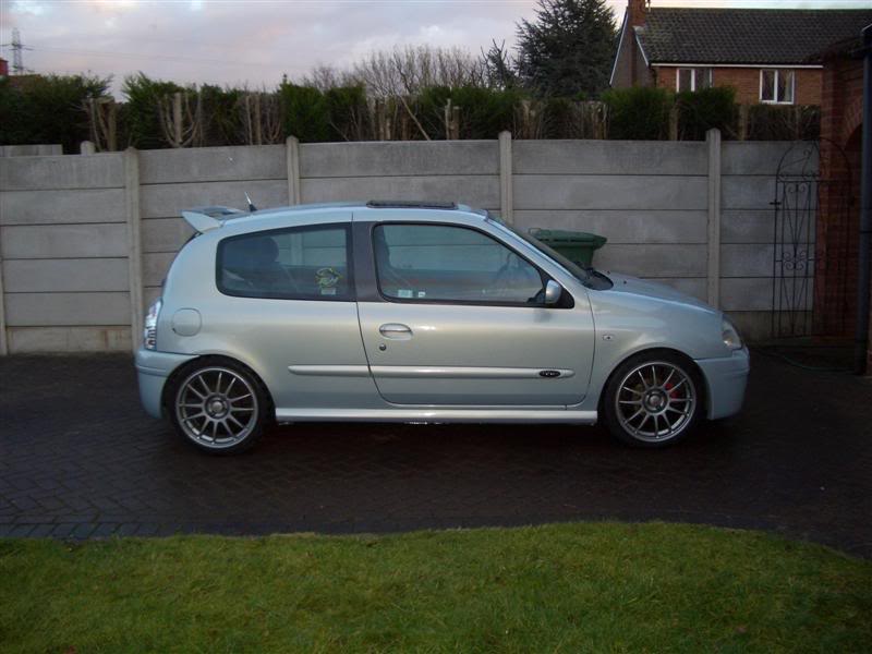

i sorted mine out by doing this lol
wish i never done it now as the spoiler hits it lol, i think it looks much better at the rear :)
