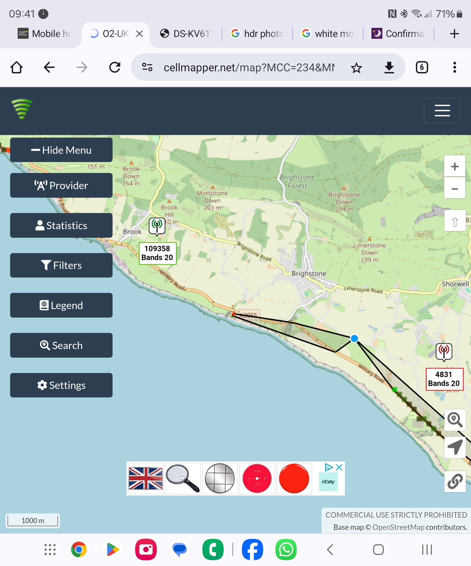

I'm where the red dot is, looks like there is a tower not to far either aide.

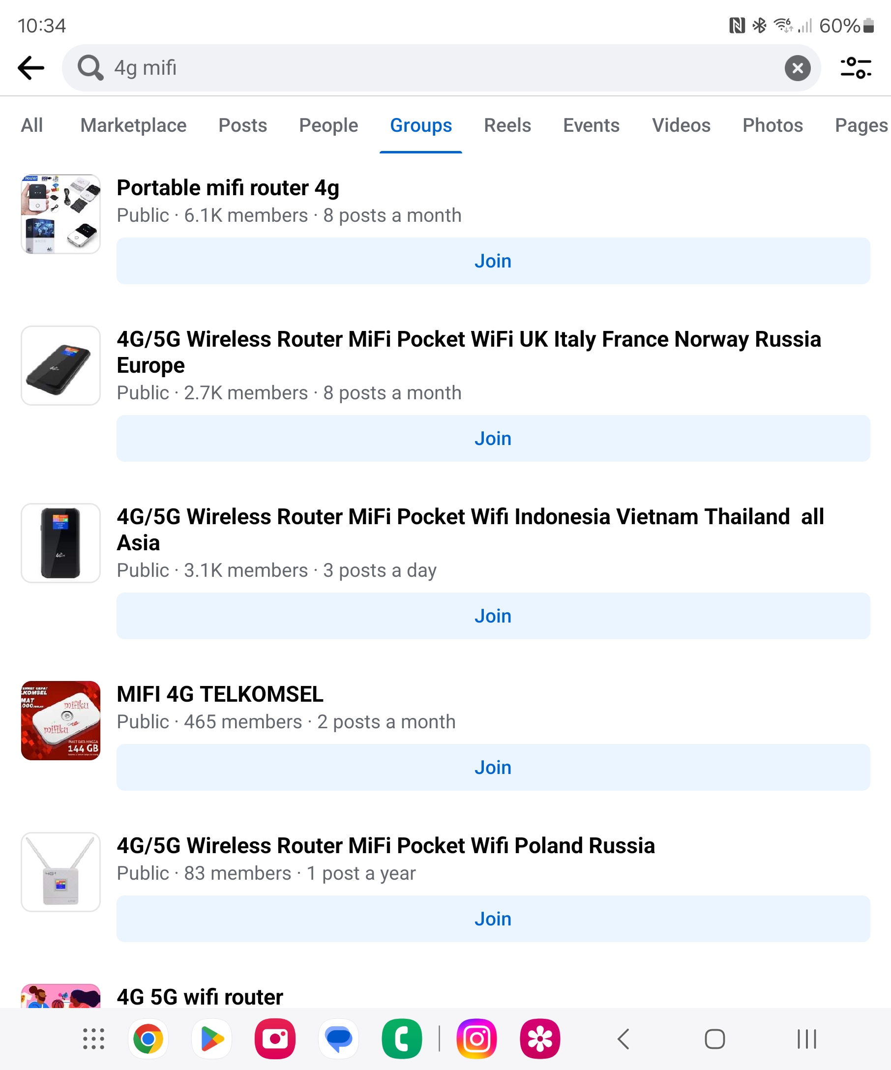

The top group?

I'd join them one at a time.. Most Facebook groups are auto accepted so just have cnuts spamming sht and scamming.
Join. See if it's genuine, if not leave.
I can't remember what I joined

ok, didnt know if it was the one you joined thats all.

right i need to get on this as we have booked isle of wight for two weeks in the summer.
between the tower info and the marketing advert, your left with very little map space :(
EE offer an unlimited data PAYG for £35 a month, the below shows the nearest EE cell site.
im staying where the red dot is, there is a line from the cell site to my location. but im not sure what this means?
