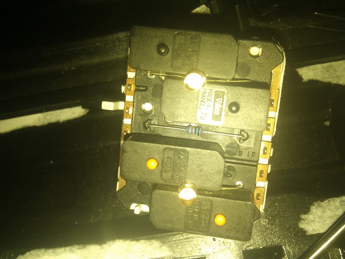

I've just had a gander at the workings of the switch. The double click to enable auto down is triggered through the switch pressing down the "down" AND "up" buttons in that order, and reversed for auto up.
I swapped my driver side switch to my passenger side to simulate the same thing, and it just stops the window :( So it must be an ECU thing :p

The mk3 doesn't have pressure sensors as such. As I mentioned in my previous post, it has 2 buttons beneath the switch. One which makes the window go up, one which makes it go down. To make the window go auto down, the down button is pressed, THEN the up button. This gives off the double click feel.
Sorry about the poor quality.
The underside of the switch has a plastic mechanism which allows you to double click, but when placing it on the passenger button, it doesn't work so it must be the unit itself containing a resistor or something.
I'd imagine that if you were to replace the unit on the top of that photo (the passenger side button) with the one on the bottom from another mk3, it would work in the same way.

Its nothing to do with the actual switch, ive connected my main switch to the passenger side, switchs from other cars and wired em in and many other forms.
