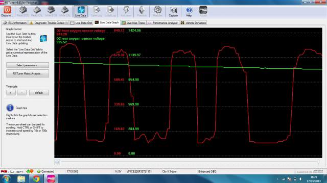

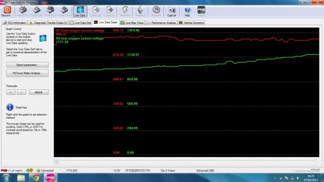

Replaced the front Lambda sensor.
Used my RS Tuner to check them. Rear lambda was definitely faulty as the reading didn't change at all. So I put the old front Lambda in the post cat hole.
Idle:
~2k revs:
