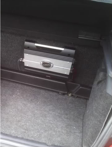

I've mounted mine to the back of the rear seats in my Clio:
I know you said you didnt really want it in the boot but I've found like that It barely makes a difference to boot space.
I did look at mounting under the seat but my amp was too big to sit flat coz its quite a small area underneath, but if it fits Im guessing just using Velcro will keep it in place.
Also if you have the skills you can always build a false floor to mount it under
Very clean install that mate.
I did my first install like that, I just fancied something a little different.
