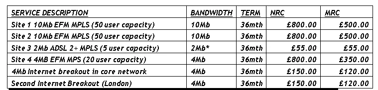

What do you think about these prices?
Two break out points, as I am paranoid about the single point of failure.
  182FF with cup packs
To be honest, I'm probably the wrong person to ask about prices, I always leave that upto someone else :p
Though it might be worth taking into account that if most of the traffic is going to be from your smaller sites to your main site, your main site should have a larger bandwidth than all the satellite sites.
