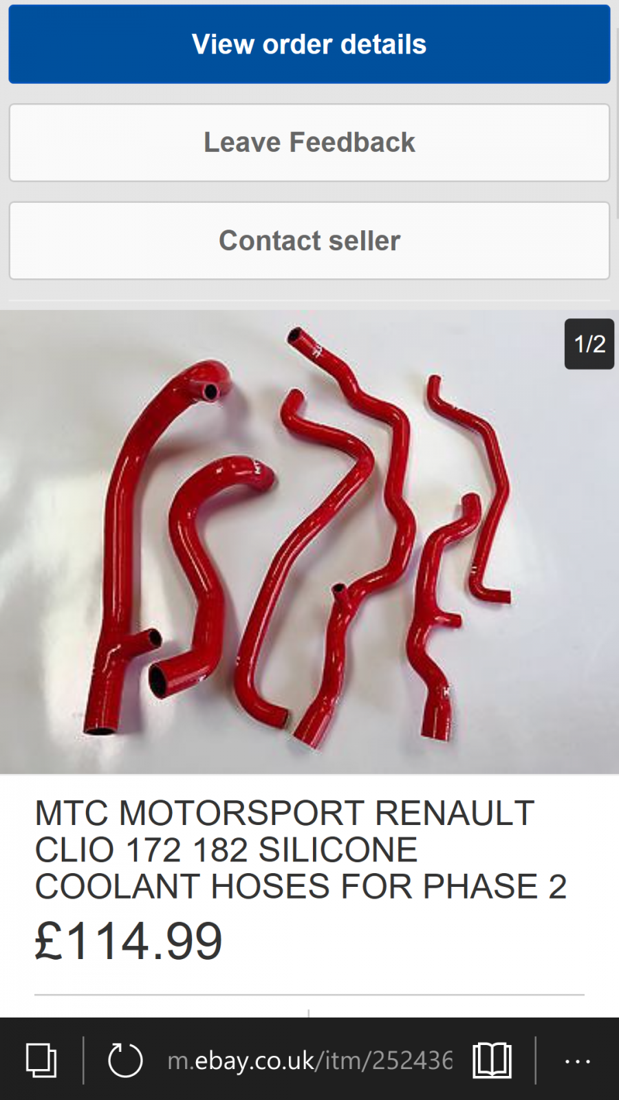

anyone else got this set? I want to order new clamps for them so does anyone know all the sizes I will need and the size of the joiner needed?
thanks in advance

well if found out what sizes I need, im after
4x 21-23mm
6x 25-27mm
2x 31-34mm
1x 37-40mm
3x 40-43mm
after full stainless clips if you have any available mate?
