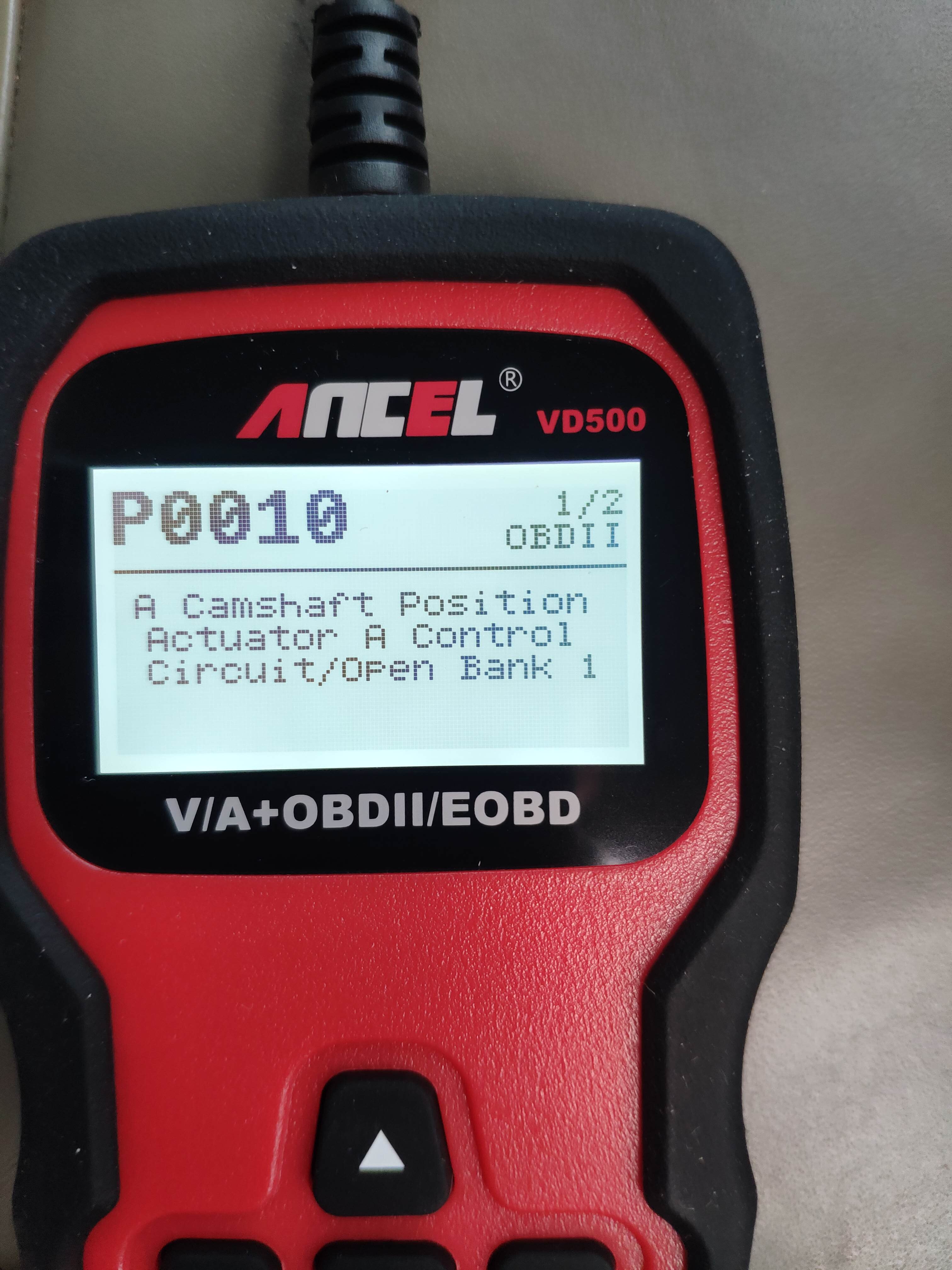

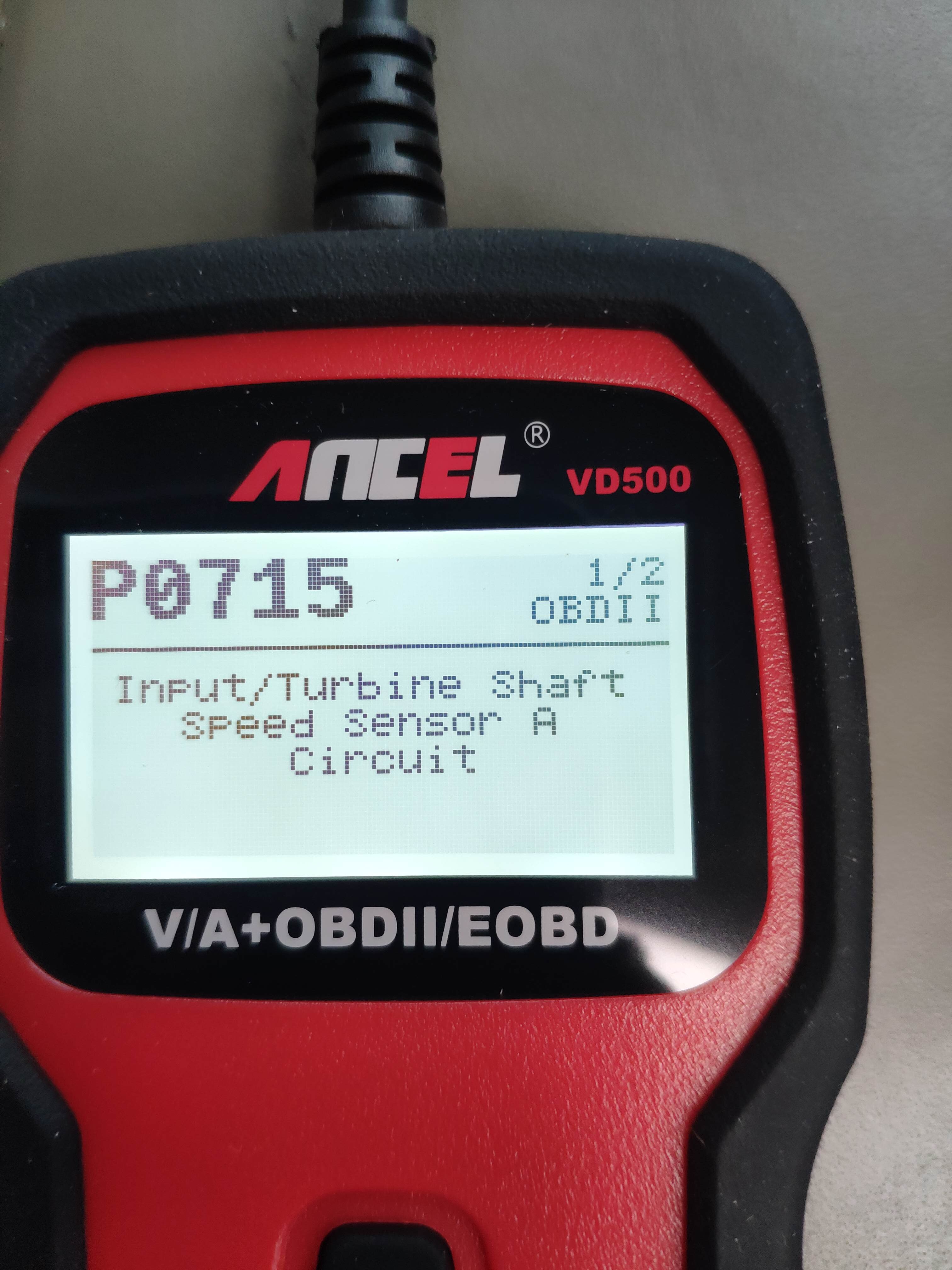

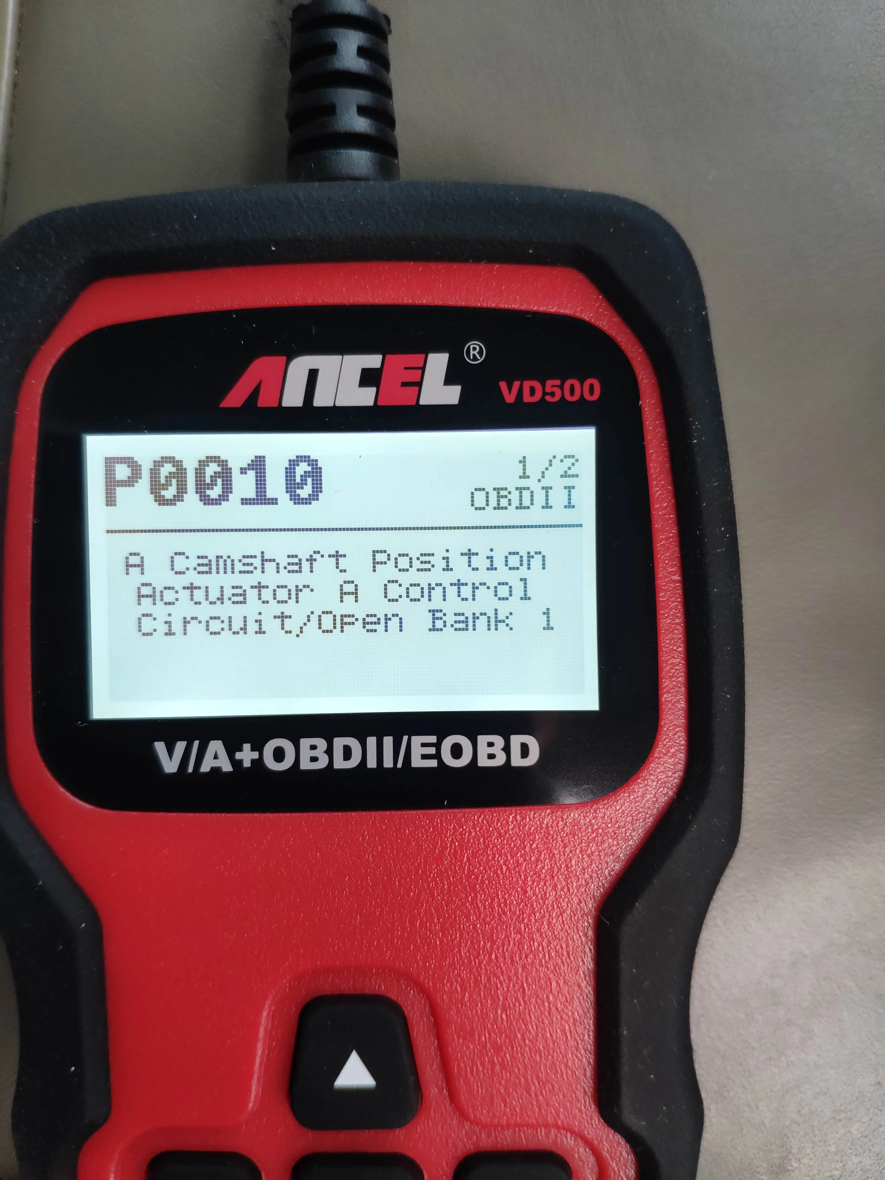

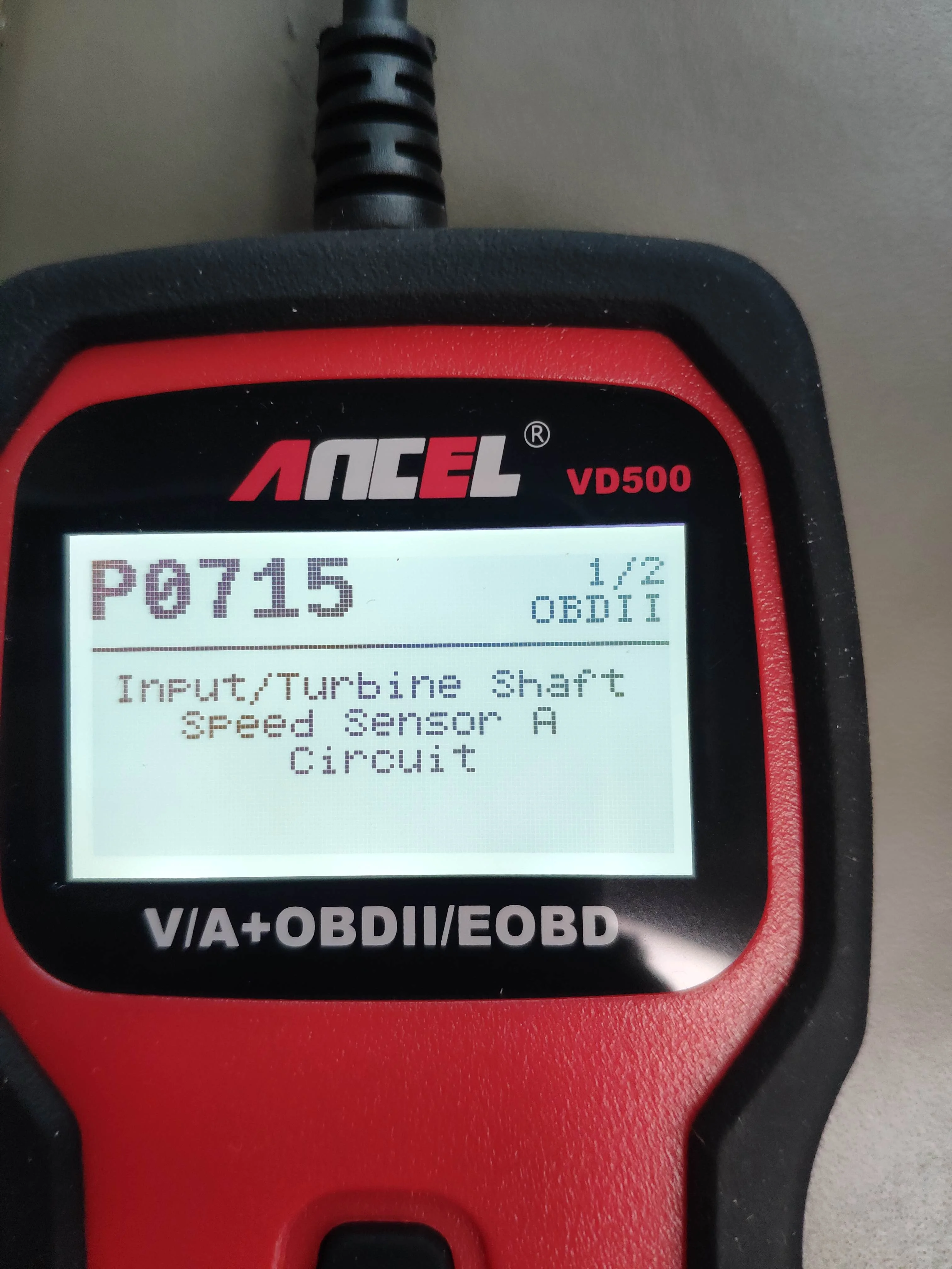

I put a cheap diagnostic tool in. It says alternator overcharging.
Then used the OBD and get Camshaft Position actuator issue and another Turbine shaft speed sensor. Unrelated???

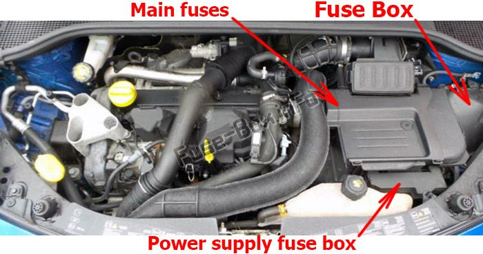

This might help. The fuse box is what is called the UPC. Just a fuse and relay board. Think its got a few tx20 screws holding the cover. Worth checking. The seals on them are made of foamy rubber that eventually lets go and lets water in. Any water overflowing from the scuttle could easily find its way in
