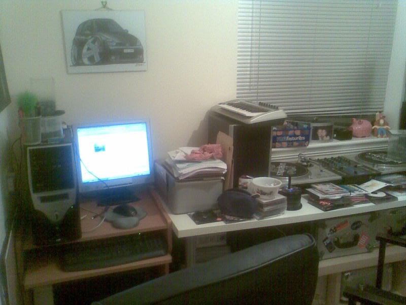

it just dies, its not after a cirtain amount of time, somtimes it can be on for 10 minutes then other times it can be on for a few hours. there is not error message or any type of warning and does not reboot its self afterwards. not sure if it is over heating but i dont think so as the tower is on top of the dest next to my monitor like so
